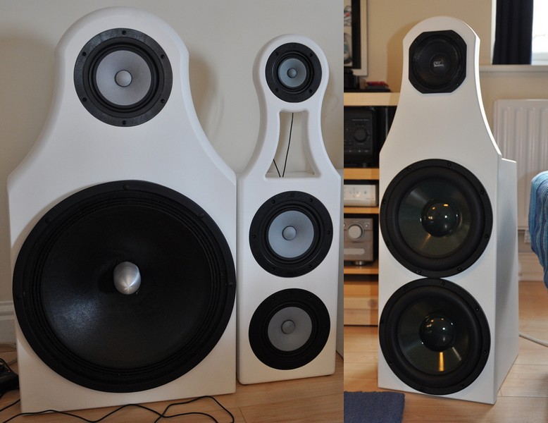

Done several similar designs
I didnt pursue because I could not achieve enough SPL for rock using a single FR driver in OB. Bass also OB using U-frame.
The one on the right using PRV was loudest!

I would go with a MLTL design for the woofer, and a FaitalPro 3" driver on top OB.
That will bring your FR driver higher to listening heights and the MLTL gives you nice punchy bass.
The XO will be higher, like 500-600 Hz. I wouldn't ask a small 3" driver to perform metal at higher spl on an OB below that XO point.
It can be surely done with passive XO. A great tool for learning and designing XO is XSim, which you can find here at DIYAudio.
But..... The trouble is that OB need some space to breathe,so if you put the enclosure on the wall behind, there's no space for it to do it's thing. OB needs at least 1.5m from any wall.
If you want roughly the same design, check out the new MLTL from XRK on the thread 10F/RS225. That would surely be pleasing for what you need.
