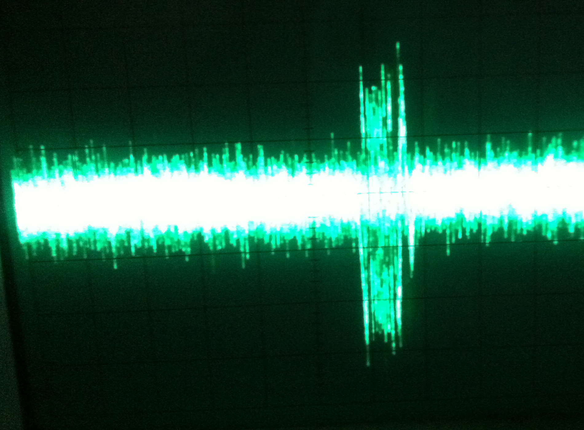

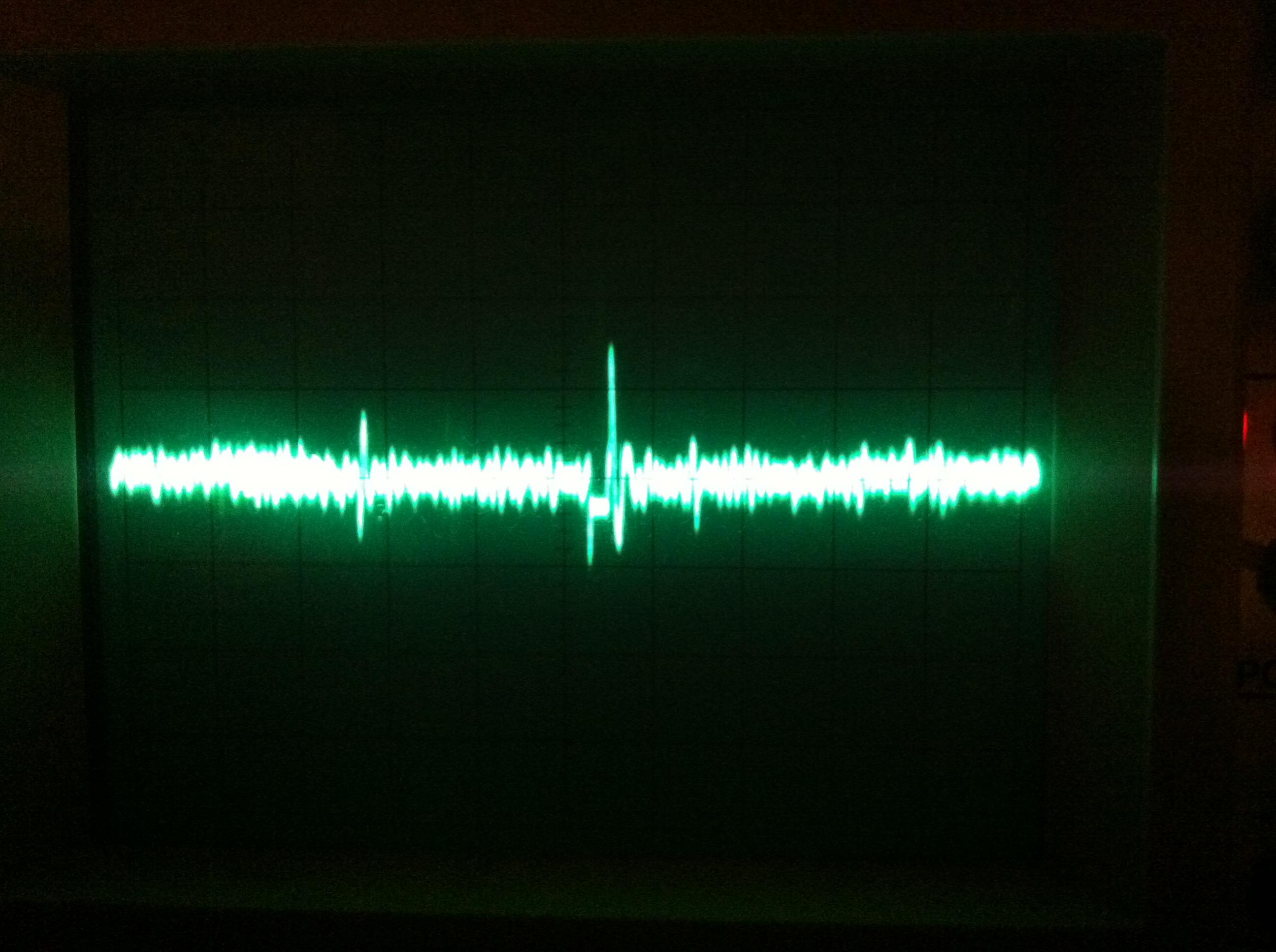

This is the tracking error signal caused by dropout, Shouldn`t I see
peaks higher in amplitude symmetrical to the fundamental signal after the mod...?
I'm not so sure you would tbh. That signal is what ultimately drives the tracking coils of the pickup. If that signal were bigger, the lens would move further. If its correct now then it should also be similar after the mod.
The defect on the disc is fixed and so the waveform needed to correct that defect is 'fixed'. Its like a servo system on an amp for DC offset. The error voltage is the same no matter what the internal gain structure of the servo... within limits until the servo loses lock and goes out of range.
You will have to try that and see what happens in practice.

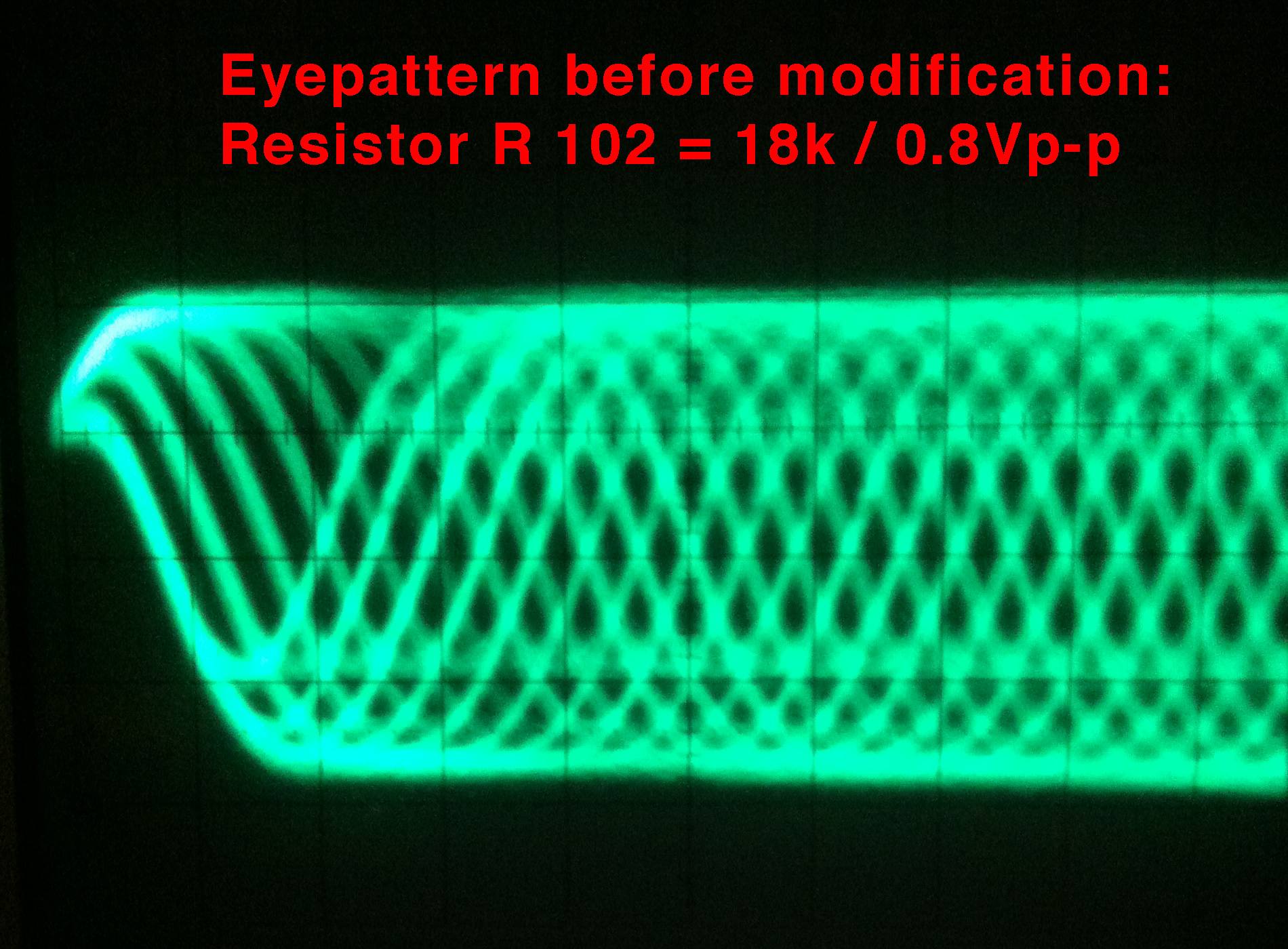

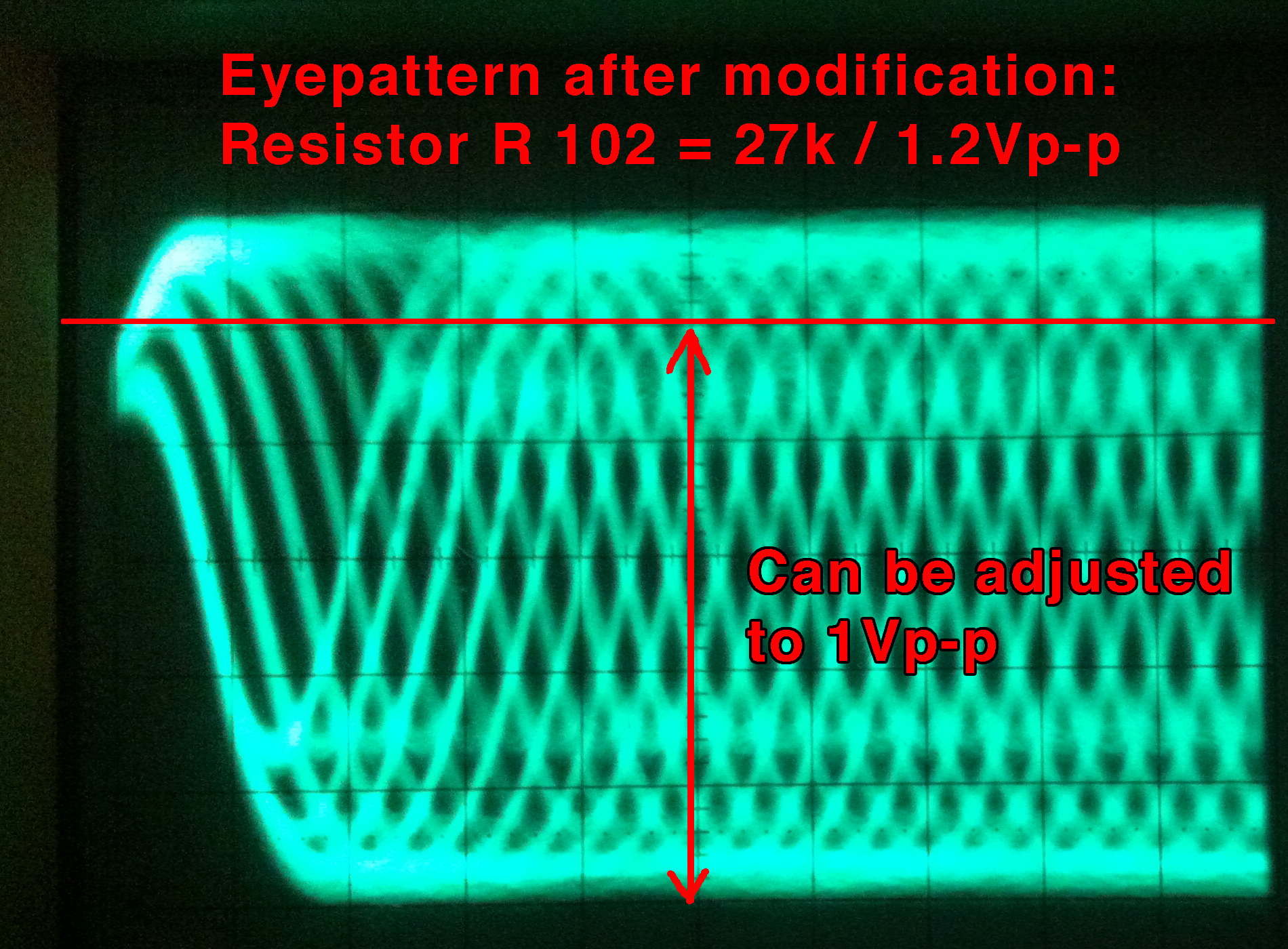

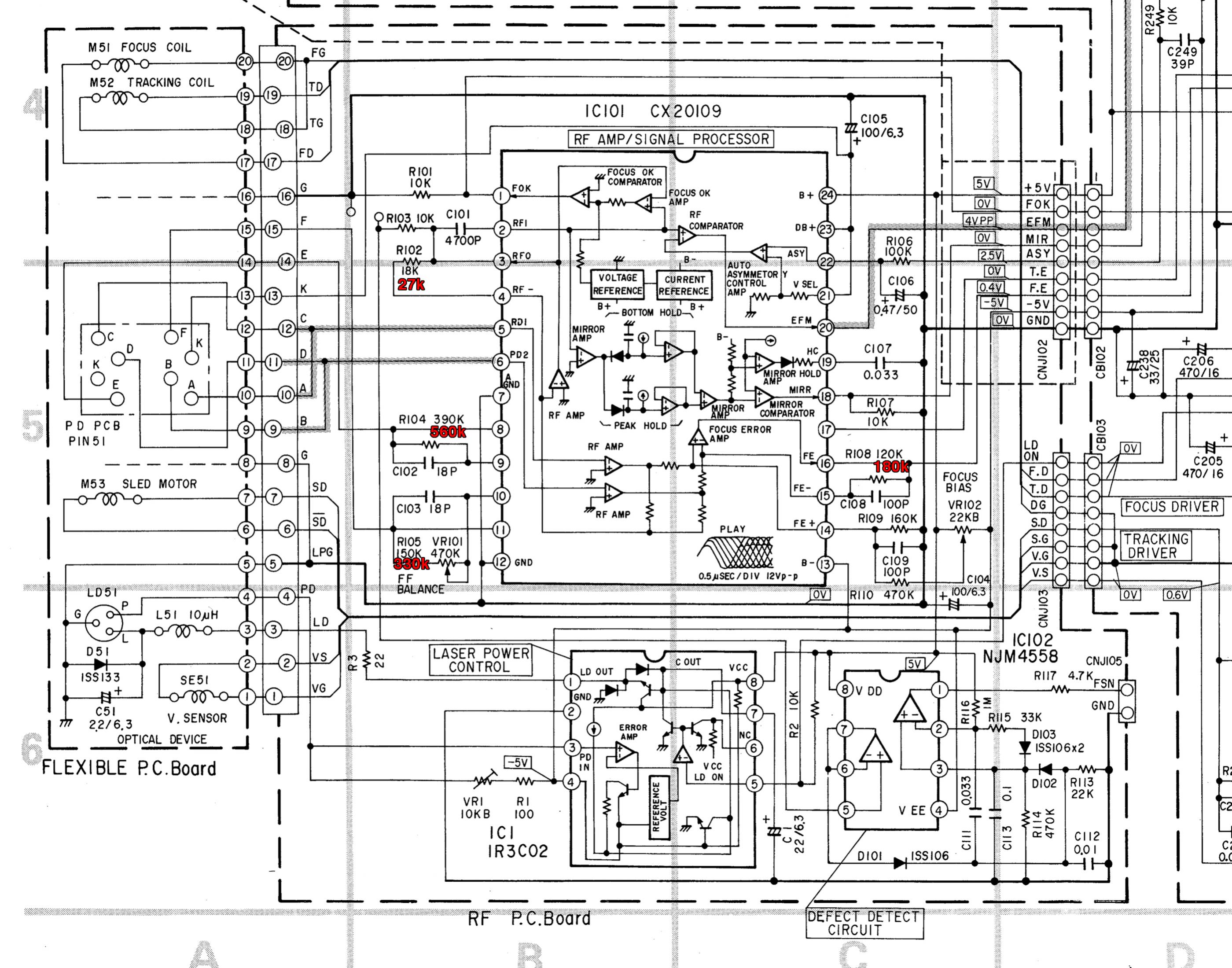

One wrong assumption is the amplitude of the eyepattern. It is 1.2V overall but only 1Vp-p. The schematic from Luxman forgot
the decimal point btw, 12V will definately shorten the laser diode´s
life to less than a picosecond 😀
The second error was R105. I calculated a wrong value by not considering VR101. Many thanks to Mooly for correcting that.

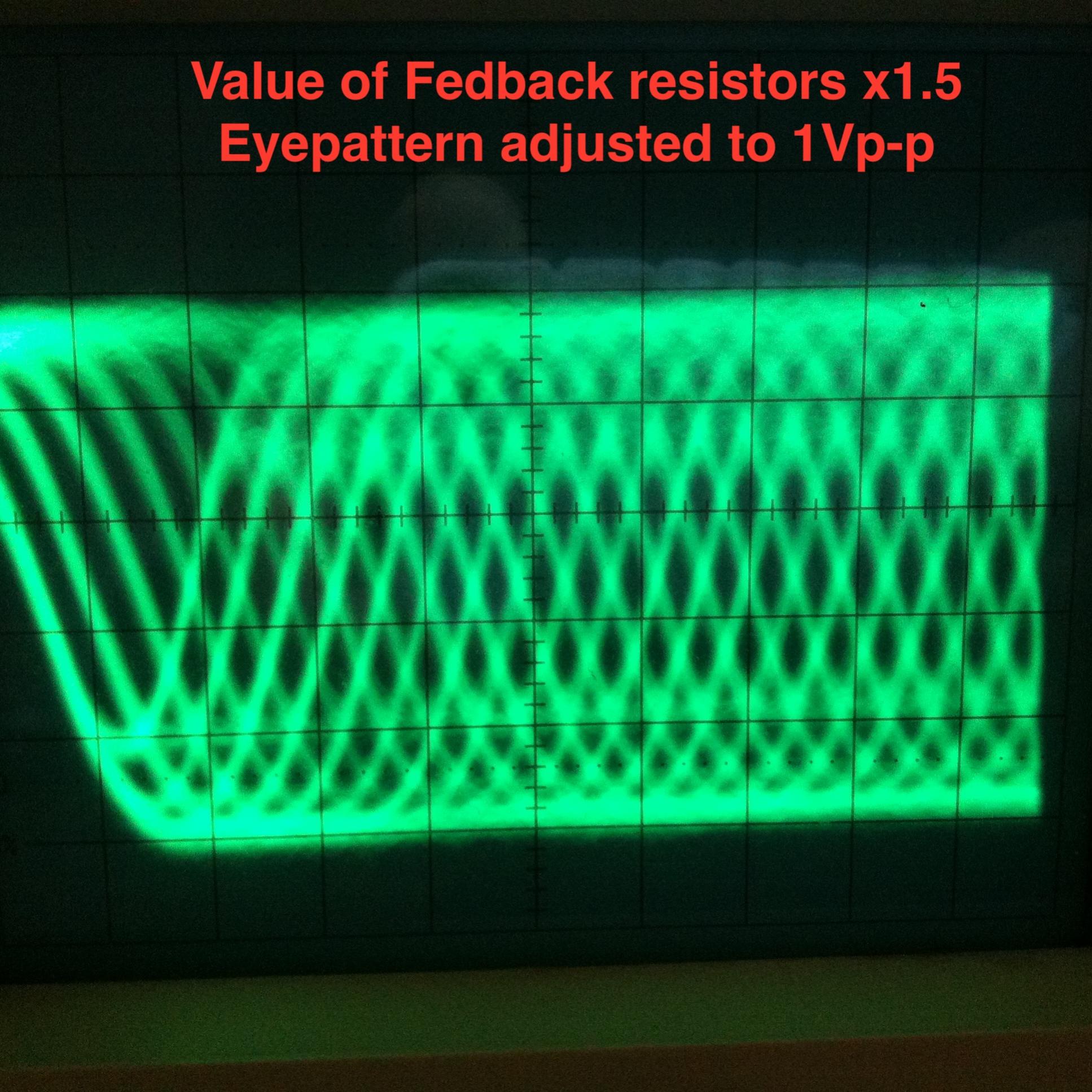

I raised the value of the resistors in the schematics by 1.5.
This resulted in 1.2Vp-p in the eyepattern and the opportunity to lower the level to 1Vp-p as stated in the service manuals.
I made this modification on two BU-1C equipped players today, a Sony CDP-103 and a Sony CDP-302. On both I could lower laser power.
To my very surprise, lowering the power by 0.2V meant just a tiny almost unperceptible counterclockwise turn of VR1,
a 10k trimmer on the BU-1C laser board.
I really wonder how they aligned during production, its like microsurgery.
This could be due to aging, but VR101 for E-F balance has to be reajusted as well, which was easy with a sensible margin.
Best to do so is by pressing the search button and to watch the E-F error "peaks". Turn the trimpot until they are symmetrical.
But both players also worked without readjustung E-F balance.

I am not sure whether not changing R109 and R110 (in contrast to an earlier
schmatic) is correct. But I think R108 does the job already.
So if everything is correct now, we could start a new thread and do a database of players using the CX2019, with the feedback resistors original and altered values.
I.e. the CX20109 feedback resistor´s values in a Nakamichi OMS7II/OMS5II CD player (using a KSS-123A laser) are different from a BU-1C.

Yes still the difference in optical output is just 1/6 less. I will try doubling the feedback resistors value next week.

Almost all BU-1C based units I own are in the 0.8Vp-p range after cleaning...
And the datasheets allow an Eyepattern of 1Vp-p +/-0.2V

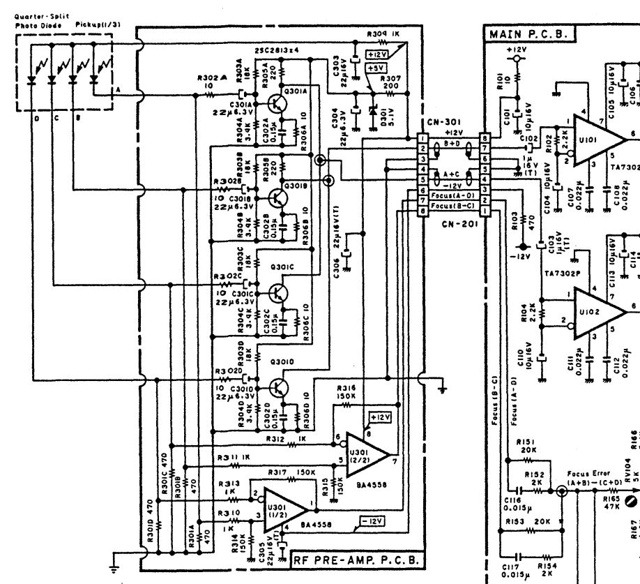

Thanks! So, after a five years hiatus I woul like to go back to the original idea to amplify the photodiode current.
(Nevertheless, do also take a look at the alternate approach where the input sensitivety of the RF-Amp is raised, see posts #65 and #73)
I found the following schematic on the first gen. Nakamichi OMS-5 and 7, using Olympus TAOHS Laser Units.
In this schematic, the current is amplified using 2SC2813 transistor, correct? If so, how much is the ratio?
