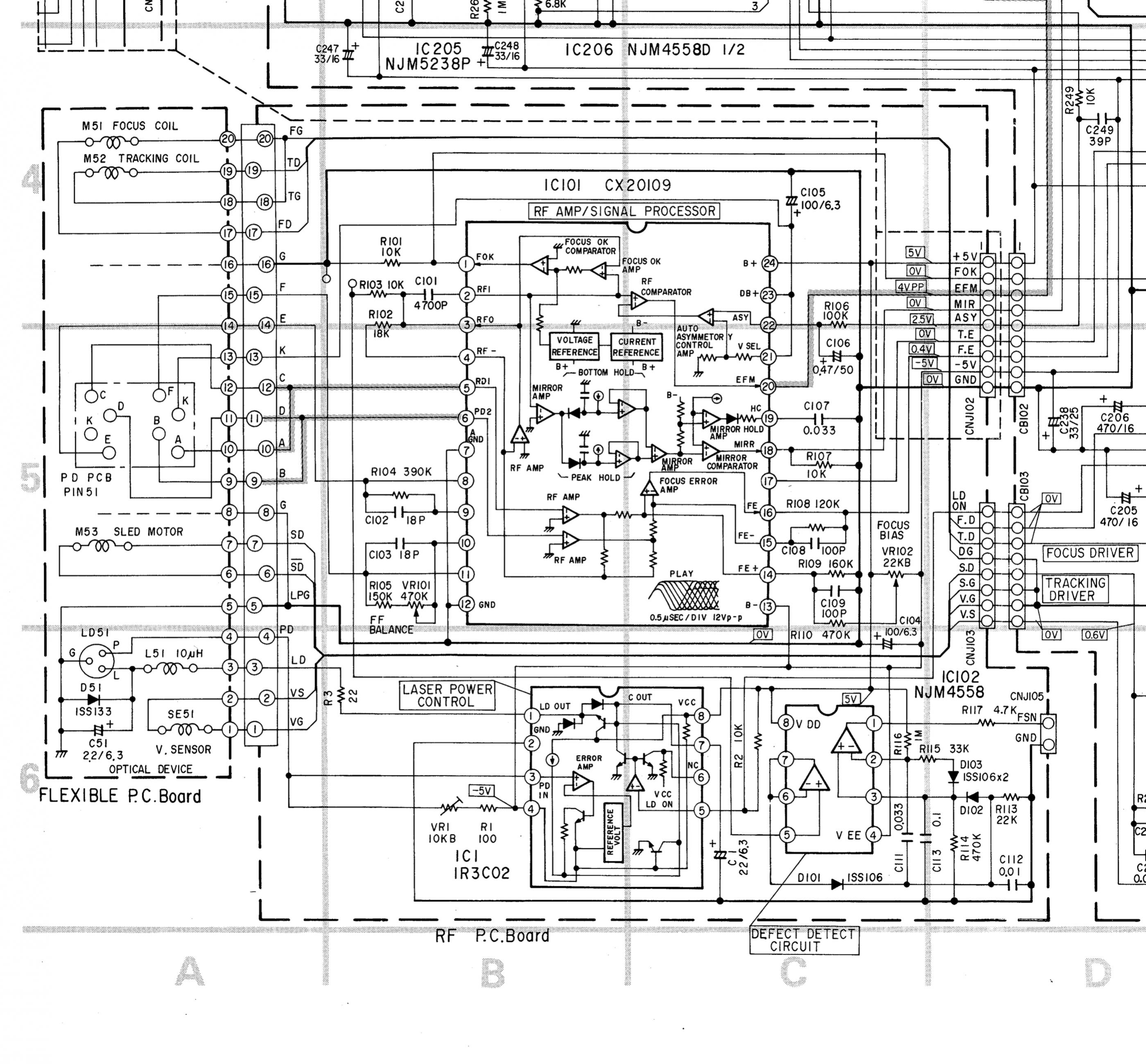

I attached a typical circuit of the BU-1. The eyepattern is created by the RF-Amp which also provides the servo signals.
Idea is to lower the laser´s output power to prolong it´s life and and in return amplify the signal / current before the RF amp by the same amount so the RF Amp sees a signal at the desired level. As you can see, the photodiodes are tied together, A+C an B+D.
E+F must be amplified as well

The first two opamps marked RF Amp in the chip are the transimpedance amps. There is no measurable voltage at their inputs because they are configured in a virtual ground arrangement.
Transimpedance amplifier - Wikipedia
A/B/C/D/ are the four photodiodes I mentioned.
The third RF Amp is a standard inverting voltage amplifier stage (a virtual ground mixer) that combines the output of the two RF amps to give the familiar eye pattern.
The side spot detectors also go to their own transimpedance amplifiers and the output of these is then fed to a differential type stage to obtain the tracking error signal.
If you reduce the laser current you also reduce the current produced by the photo diodes. That in turn reduces the final I/V conversion result and so the voltage output of that third opamp is lower, and the same applies for the tracking error signal.
Although you could increase the gain of the third opamp stage and add gain to the tracking error output it would be less than optimum. The designers will have chosen the best ratios for satisfactory operation over a wide range of conditions.
By all means experiment but also accept that you wont end up with as robust a player that would meet its playability specs under all conditions.

The current the diodes produce is fixed and proportional to the illumination they receive.
If you try and amplify the diode output (its voltage output) by transistors then you are going to run into noise issues. You would then have to mix the signals in the same way the chip does. You could try making an opamp I/V convertor with higher gain which would in practice be the same as in the chip, just with a higher feedback resistor wrapped around each opamp.
To try and make a transistor discrete I/V convertor for this would almost certainly be very inferior to using dedicated opamps.
R102 on your circuit looks to set the voltage gain of the final RF stage. You could alter that to increase the RF level to compensate for a lower LD current but signal to noise ratio of the eye pattern will deteriorate. You also have to make sure the side spot detectors generate the correct amplitude tracking error signal so you would need to add gain to the TE signal.

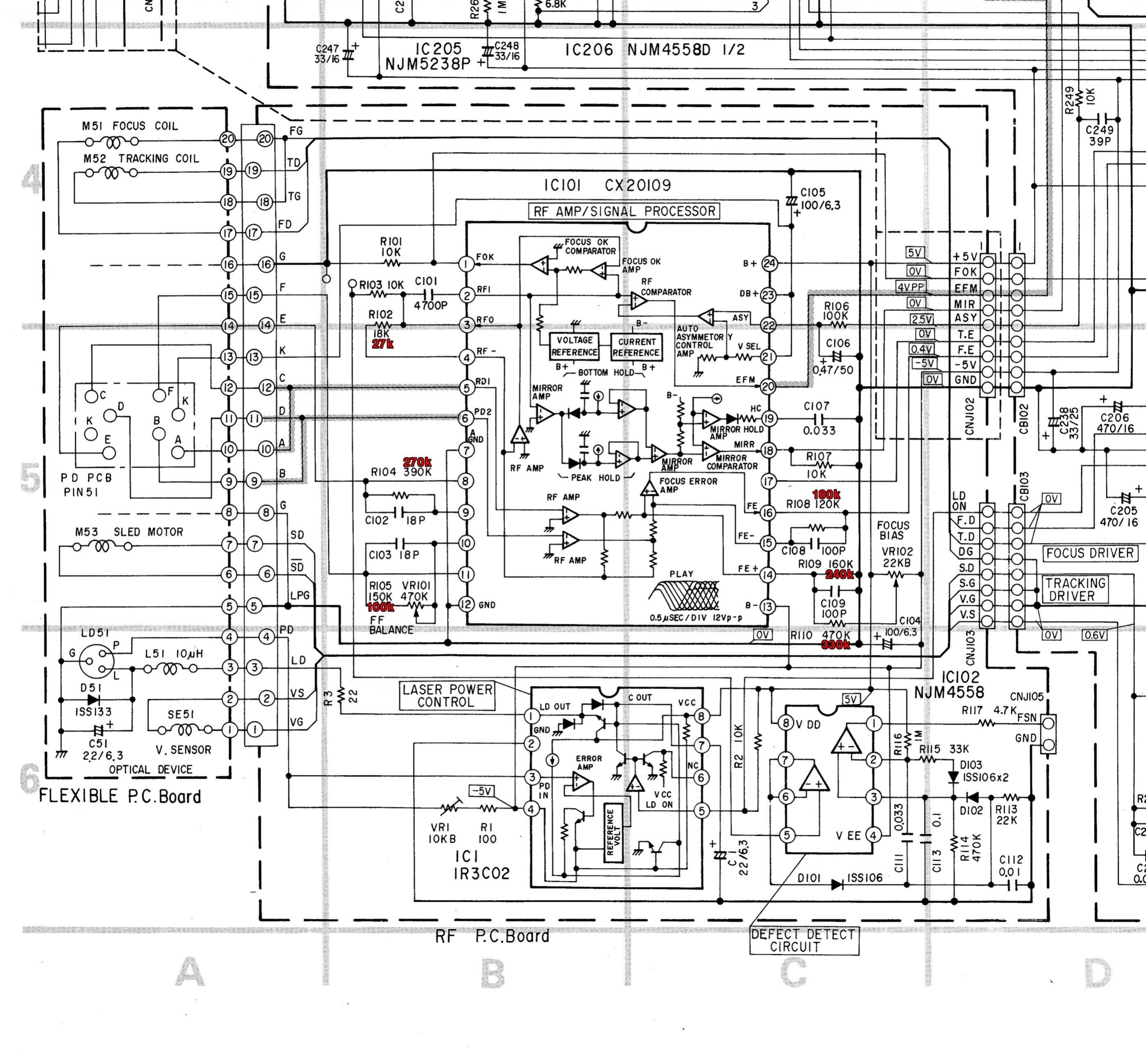

What About R102, R104, R105, R108 and R109 in the schematics posted the page before?
Can the output of the opamps be raised? Same result…?
Those resistors would alter the gains and it may well work and play but it can't be optimal. (R109 isn't a gain setting resistor)

I checked some CX20109 RF-amp circuits today.
A BU-1C, a Sony CD-40 with an ordinary worm drive and a belt driven Nakamichi OMS-5II.
The (feedback) resistors of the Sony CX20109 circuits are the same, in the Nakamichi they differ.
The Nak uses a Sony KSS-123A Head, the Sony CD-40 uses a KSS-120.
So it looks like the CX20109 has been been built for versality.
I am a layman with opamps, but tried to change the values -theoretically-
of the resistors surrounding the opamps, mostly feedback resistors.
The idea is to raise the output power of the opamps in the CX20109 by one third.
I have a BU-1C where the amplitude of the eyepattern is down to 0.8V p-p instead of 1.2Vp-p
So this BU-1 with an aged laser diode would be a candidate to see if the mod may work.
But before staring soldering, someone could take a look on the values
I altered in the attachment below?
As far as I know, there are no schematics of the BU-1C available from Sony,
where the resistor values are noted. I do not know why the values are missing in the service manuals of the CDP-102/103/302/502 😕
But I found the service manual of a Luxman D109, where the values are noted.
So the first attachment (BU-1C Schematic) shows the BU-1C circuit unaltered, some people might need it for other purposes.
In the second attachment (BU-1C Schematic_Altered_Values) I added the altered values in red. Maybe someone might be so kind to take a look and give a comment.
I am confused how to deal with the circuitry around in 14 (FE+) I assume I can simply raise the offset voltage at VR102 about 1/3 without altering R109 / R110?
All the best and thanks,
Salar

Its very much a case of trial and error. If you bring the gains of the front end up then I wouldn't have thought you need alter things after that point because the levels should be back to original values.

What about R109 / R110? A voltage is led to the positive input of the focus error amp,
I assume they do not need to be changed?
