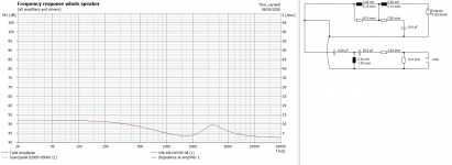

Sure, I know this, and since I use Boxsim to simulate net I'm able to manage phase and time alignment.
I'm working around a mid/tweeter cross very similar to a 3rd order Butterworth which seems to sound quite good and, on-axis flat: in its simulation at cross-point there are just about 90 degrees of shift between driver's phases. My question is:
- may it be worth to work around this circuitry trying to eliminate phase shift even mounting one driver behind the other's vertical plane? May it sounds better or will zero shift be useless at all in terms of sound quality? Why some cross-over designers seem to give great importance to drivers' time alignment (one of my first building was based just on a famous designer's 3rd order crossover with 0 degrees phase shift at cross-point)?
- what is a skewed lobing pattern typical of 3rd order 90° phase shifted topology?

Well, electrically speaking (note major caveat), assuming odd-order filters, then Butterworth types actually sum flat at Fc, not +3dB. Assuming 3rd order, it sums flat 270 degrees apart in phase; flip the tweeter polarity and it's 90 degrees, but still sums flat. Only even order Butterworth filters sum to +3dB at Fc.
Even order LR filters sum flat at Fc; technically there is no such thing as an odd-order LR filter, but you can create something akin.
In terms of lobing & power response, John Kreskovsky has a good page illustrating the differences of different filters assuming a reasonable 'real world' physical separation between a tweeter & woofer: Power
...My question is:
You mean use electrically symmetrical filters? Yes, you can to a point by either
-Tilting the front baffle to ensure the acoustical centres of the drivers are on the same vertical plane
-Using a stepped front baffle to achieve the same, or
-Moving the listening axis to that of the woofer: the greater distance to the tweeter can then provide some of the delay desired.
All of these approaches have their issues. A tilted baffle inherently means you are now working with the tweeter's off-axis response & you may (may) have some HF loss as a result. Can be mitigated by careful driver selection & design. A stepped baffle introduces greater diffraction, or the potential thereof, and the latter limits you in terms of positioning.
Well, you'll never get zero phase shift / phase rotation in the real world, although you can get reasonably close to a linear phase. Whether it's worth it is a matter of debate. Toole et al found that in most practical conditions, it was inaudible. Others violently disagree, although AFAIK they do not have the kind of experimental results that Toole & others obtained.

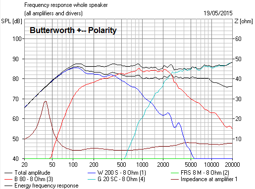

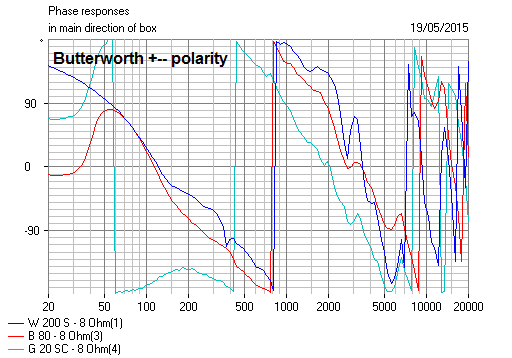

If you look at the mid and tweeter here, that is a very clean 90 degrees:
483798d1431996931-please-explain-butterworth-crossovers-laymans-terms-s7-2-butterworth-polarity-phase-png
483797d1431996931-please-explain-butterworth-crossovers-laymans-terms-s7-1-butterworth-polarity-freq-response-png
Part of a three way with a fullranger B80 Visaton as mid. It really works in either polarity, which is what we look for with Butterworth. What you don't do is look for the deep crossover null, so it breaks the rules. And power response to die for!

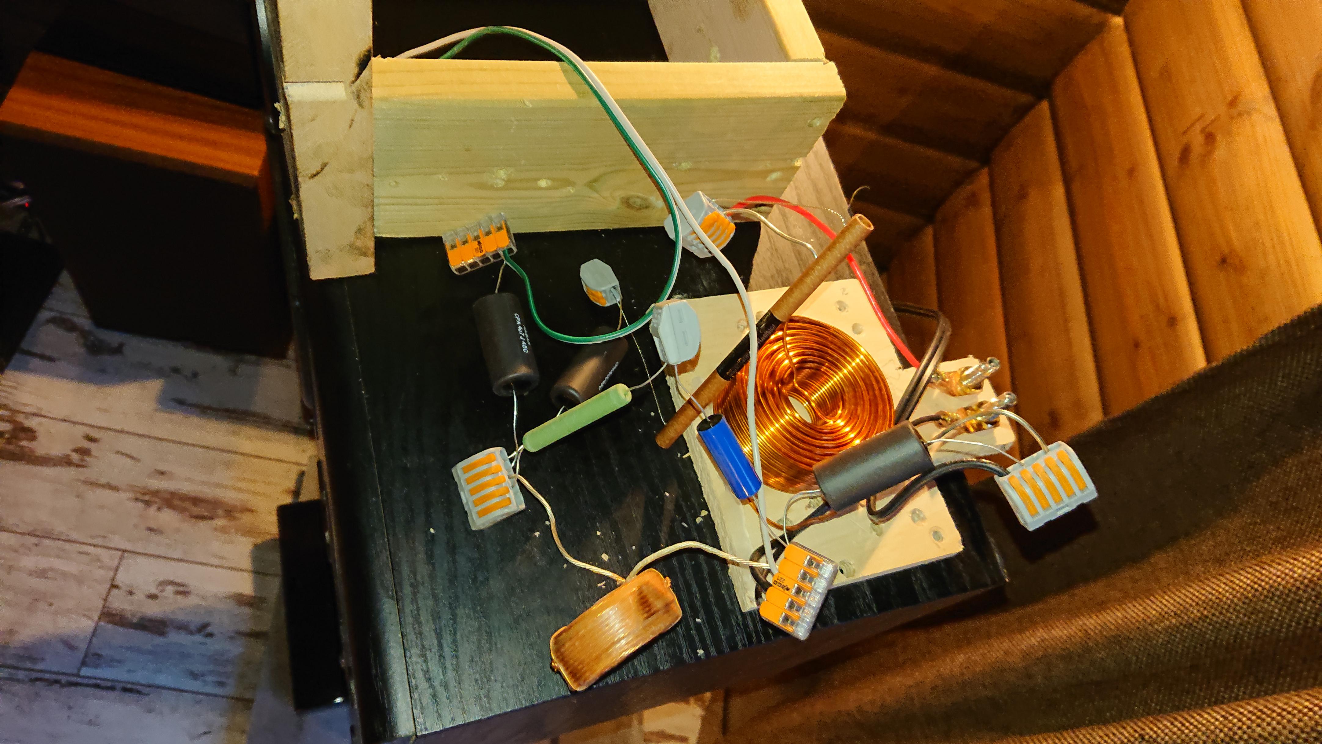

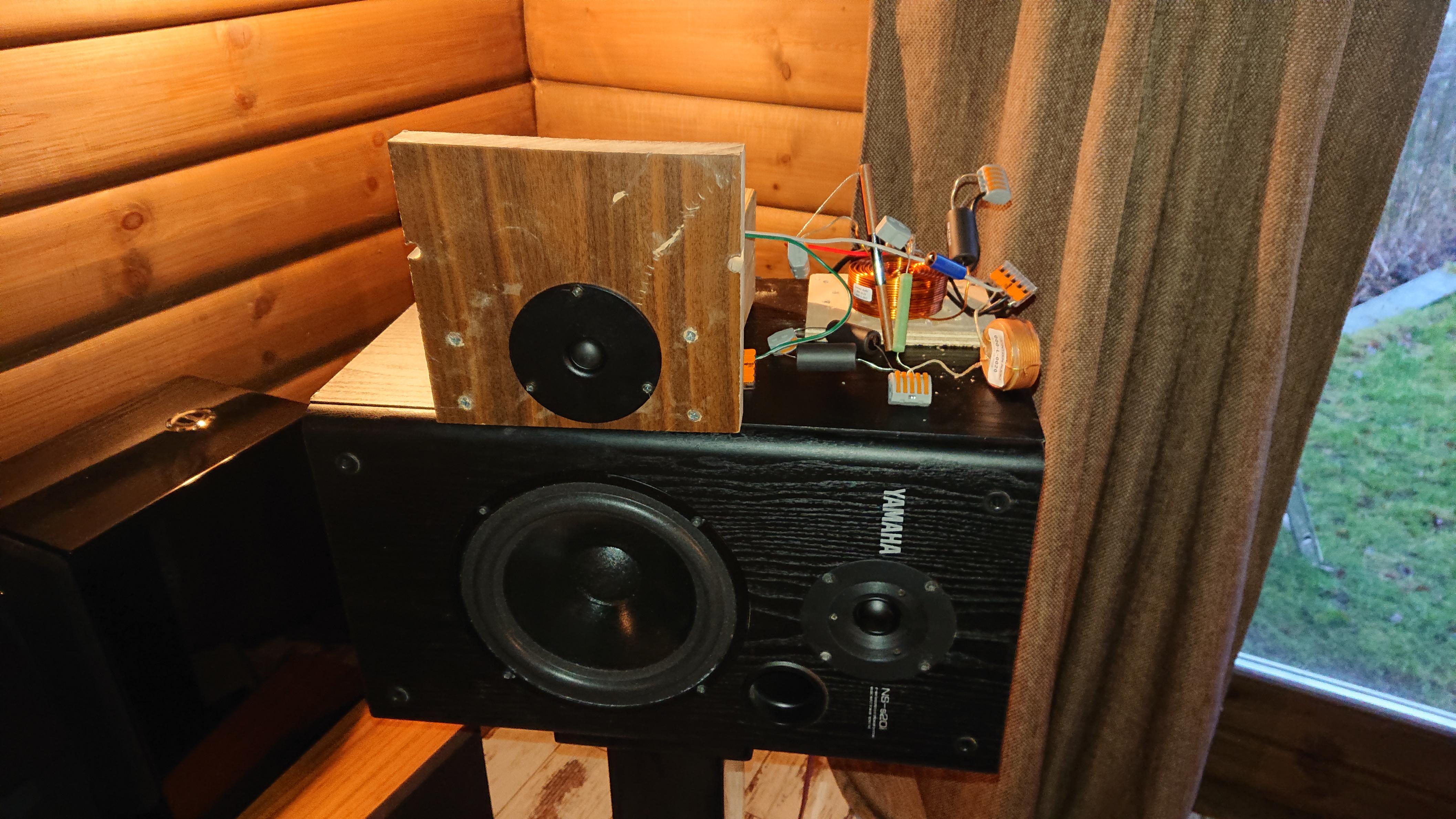

A couple of pics of my crude test rig.

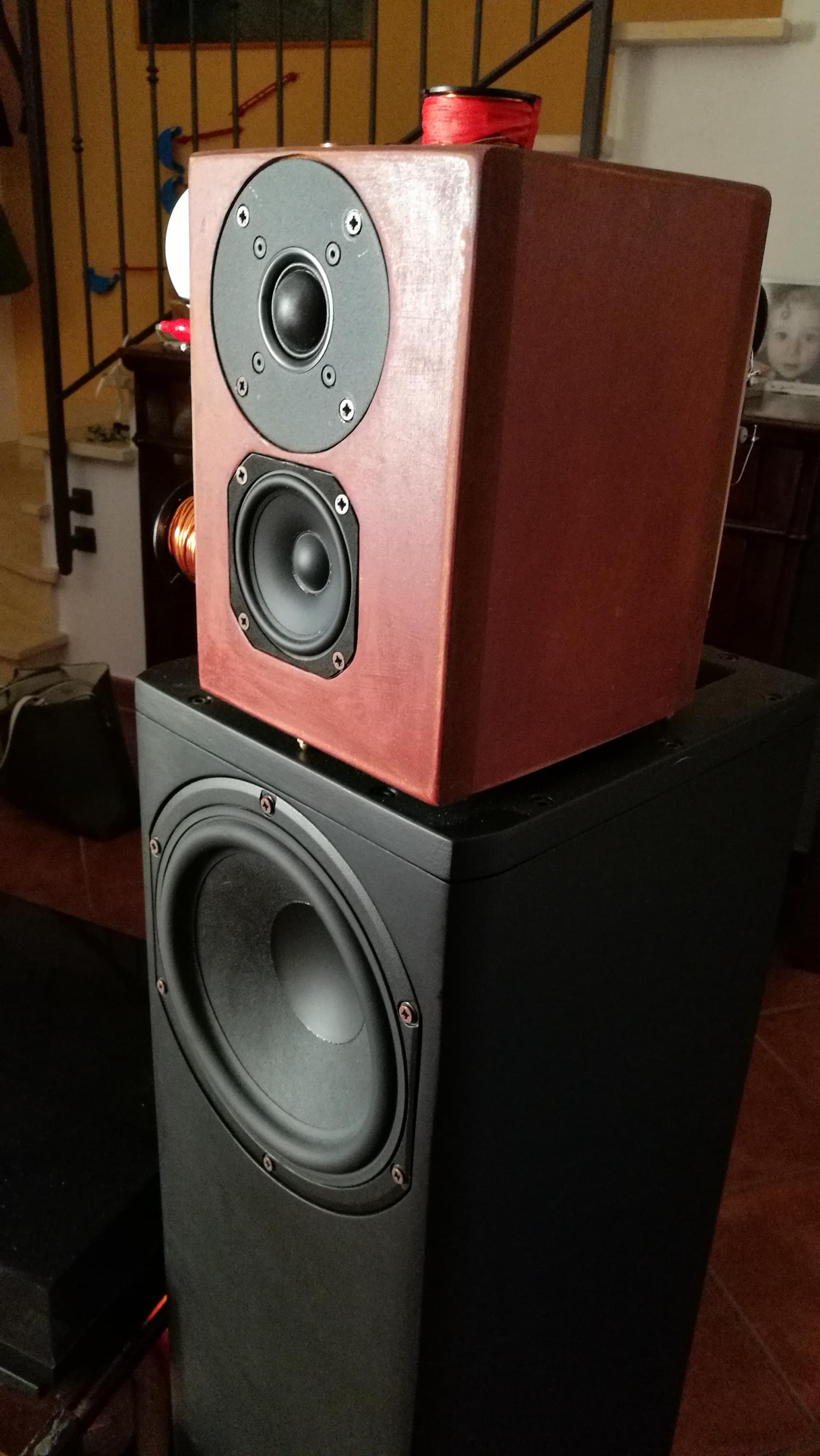

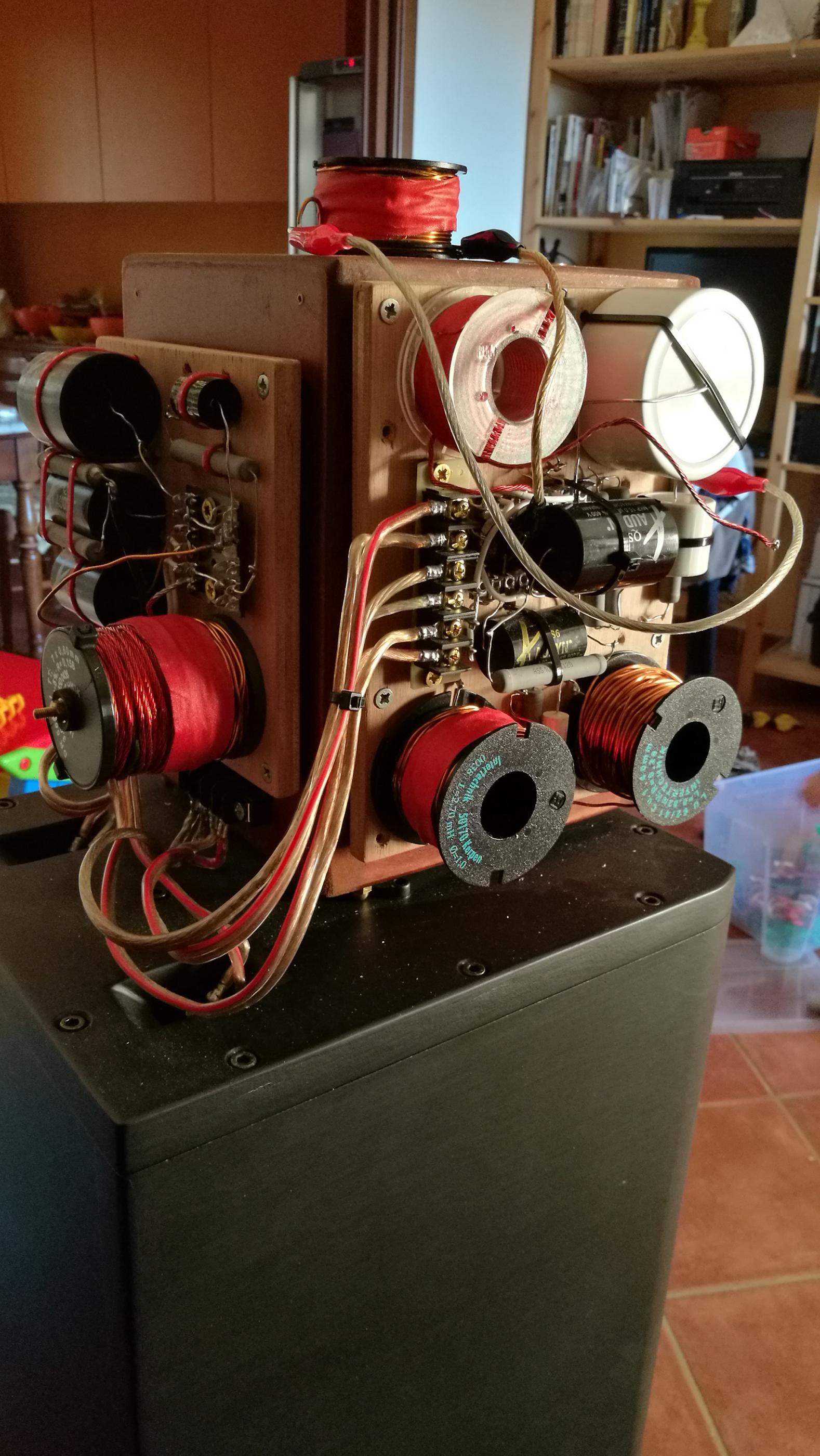

This is the same fight field of mine:
My century's project, my definitive idea, quite one year of work, a lot of time and money spent, lot of basic measurements apparently good in response, which now risks to fly out from the window for this not loud but terrific problem. My wife is afraid that I'm becoming sick (I can call butterworth's syndrome..), since when we listen something I run every 5 minutes changing on the fly some component's value..
I think you're right, haven't thought yet that problem may be in amplifier, quite 25 years old, a beautiful Marantz PM78, now I remember that measurements was made every time using another amp..
Maybe problem isn't in response but in distortion, from amp? from a somewhat damaged (by past experiments) tweeters?
Next sunday I'll take away another day by my family to verify these hypothesis and let you know, thank you very much for suggestions, hope we'll solve this issue, I began to lose sleep for the anger..!
