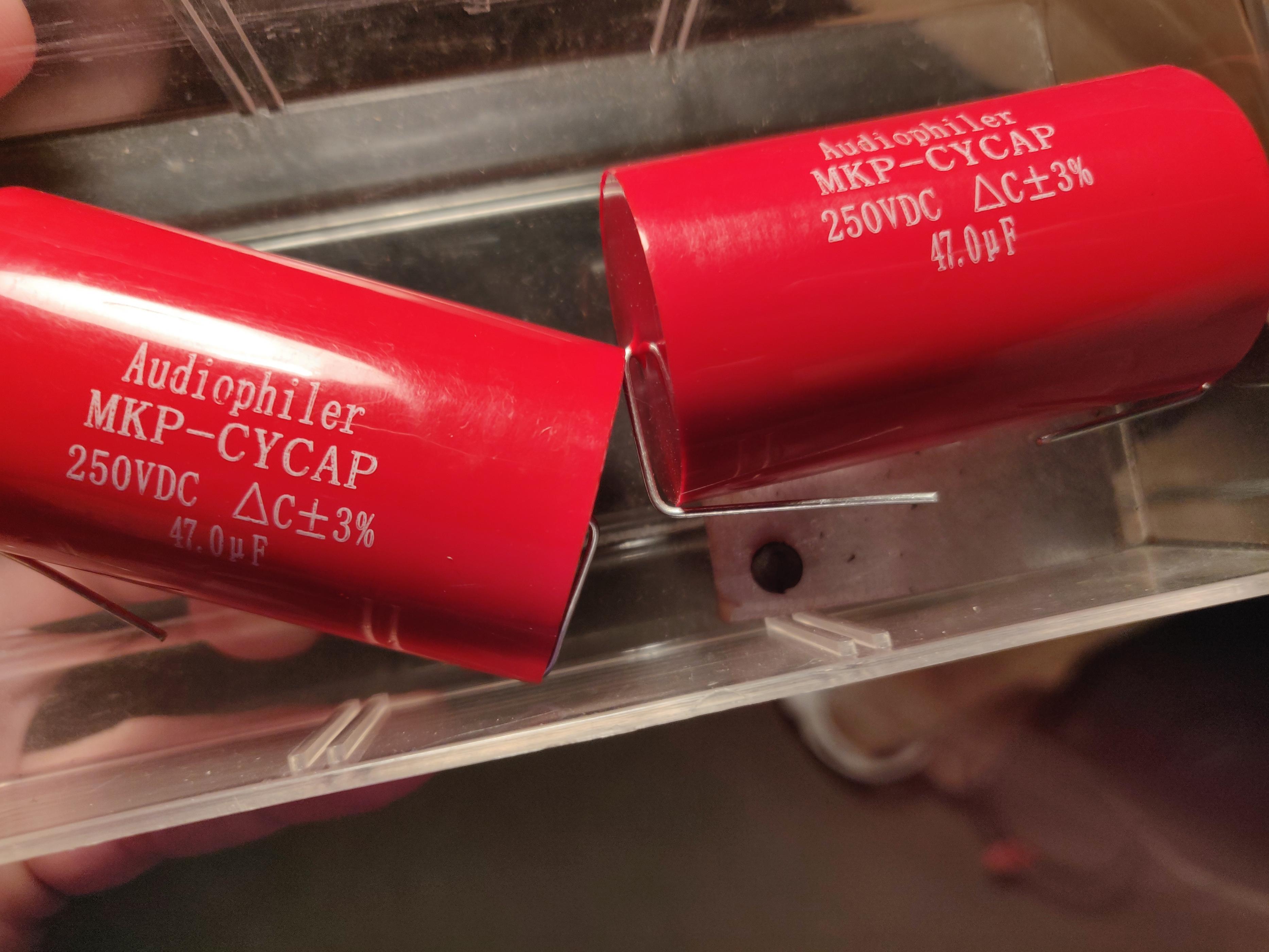

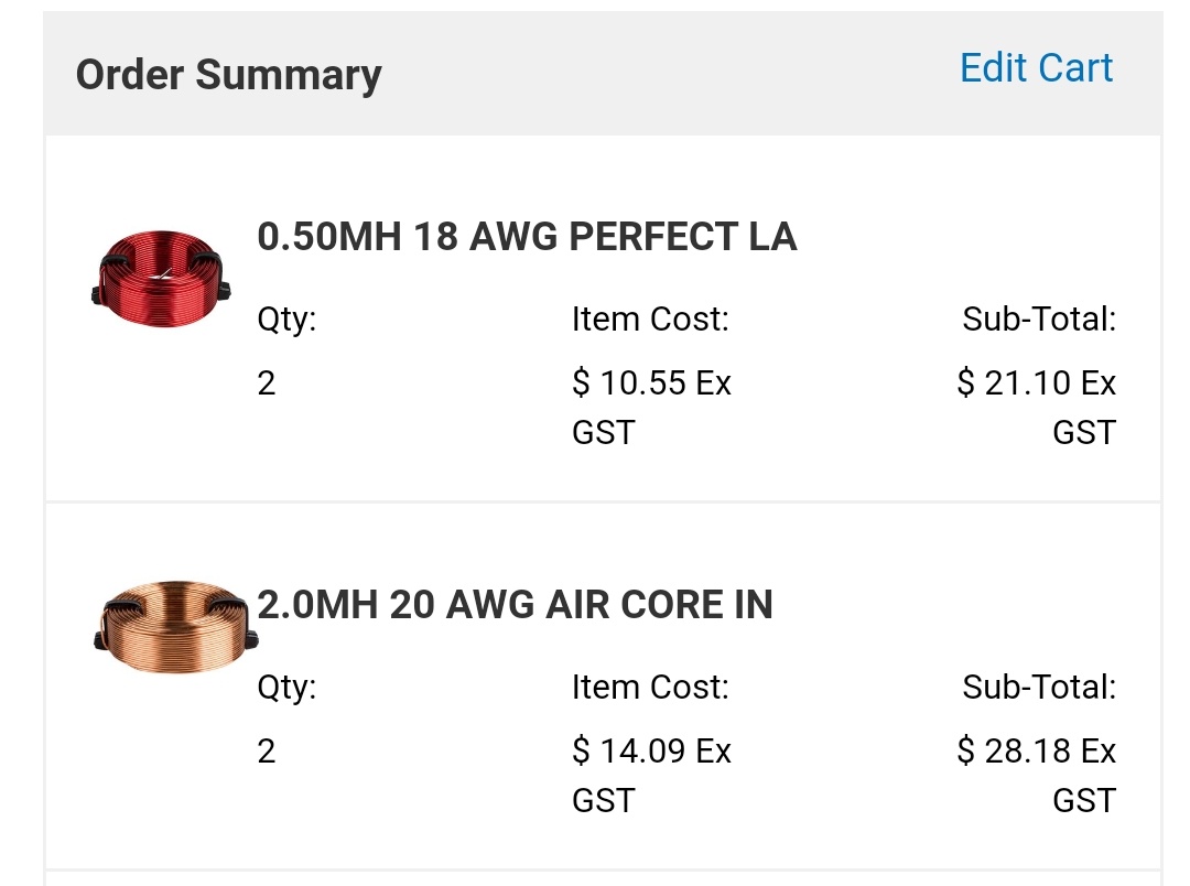

For your passive crossover components, be careful not to use toroidal power supply filter chokes as they distort heavily when playing low frequency (relative to 400kHz switching frequency of Class D amps and SMPS) that they saturate easily and distort. I have tried the same thing because I did not have a 0.40mH air coil on hand and heard how bad it can sound. When you get a chance, replace those with a proper air core or even iron core but long plates not a toroid ferrite.

Thanks for the advice. I just had these caps arrive so I suppose I'll grab air-coils too.
