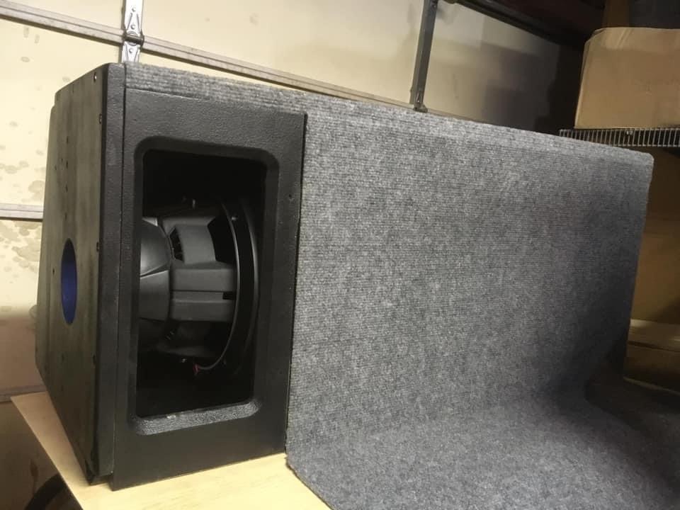

An example of TL vs BR ?
i snatched up the resent recommended venTed box for a rockford fosgate 12” p3…. It just so happened to fit in the HR suggestion/thumb rule for port tuning/length/hopefully incompressible mass/shape?
kinda funky high tuned car audio junk but it fit the bill.
any suggestions on what to look at ?

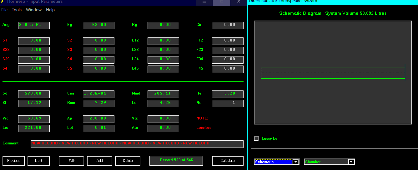

It was just a generic TL sim using the exact same volume and tuning. Apples to apples.
I used a much larger tapered 1/3 offset TL for this driver tuned @ 28 hz. I thought the manufacturers spec vented design was awkward?
