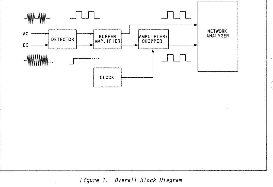

I would like to build a stand-alone microvoltmeter based on a HP85025 probe.
The probe contains a preconditioning circuit generating a 27.778kHz squarewave proportional to the input signal, and this signal should be amplified, filtered, demodulated and displayed.
No rocket science, obviously, and I could come up with a suitable circuit relatively easily, but I try to avoid reinventing the wheel whenever possible which is why I would like to have a look at a HP schematic, to see if I can recycle some or all of the ideas.
Unfortunately, it is difficult to find real, functional schematics for this processing block.
All I find are general, high-level block-diagrams like this one:
Has someone seen more detailed documentation on the subject?

The probe is not just a "dumb" piece of kit: it includes a crystal oscillator, a number of opamps, chopper switches, a PAL for the control, etc. etc.
The end result is a 27.778kHz squarewave having a p-p amplitude proportional to the input signal.

Just to elaborate a bit, and as best I recall, the probes themselves incorporate some DC biasing of the detection diodes to improve the detection threshold. Beyond that, the probes have had an opamp buffer to provide modest gain and drive the connecting interface cable to the scaler analyzer.
A typical system had a microwave sweep generator (controlled via HPIB) that was "chopped/modulated" with a ~28kHz drive so that offset biases were absorbed, expanding dynamic range several decades. Again, my recollection is that the 28kHz originated within the sweeper and drove the scaler analyzer where demodulation took place. Very often, several detector probes were synchronized from a presumed common 28kHz source.

Do you have the probe? And what are you trying to measure? Microwave, RF or LF and Audio? Or DC? The probe looks typical of HP overkill. It seems to have a diode detector and a chopper for when the source is not modulated. The chopper is typical of RF power and volt meters. The Boonton 4200 has a similar circuit with the chopper in the instrument, instead of the probe. The datasheet for the HP instrument suggests that they moved the chopper from the instrument into the probe and have a version that will work with conventional sensors. The current generation Boonton RF power sensors have it all in the "probe" with a USB connector for power and data.

The probe has two modes: AC and DC.Just to elaborate a bit, and as best I recall, the probes themselves incorporate some DC biasing of the detection diodes to improve the detection threshold. Beyond that, the probes have had an opamp buffer to provide modest gain and drive the connecting interface cable to the scaler analyzer.
Depending on the mode, the 27.7kHz modulates the source, or is internally generated to chop the DC output.
The detection cannot be synchronous, because the chopping frequency is generated internally, and there is no reference output (or it would need to be self synchronous, which seems unlikely).
The selectivity is achieved through a sharp filter, hence the necessity for an accurate crystal reference

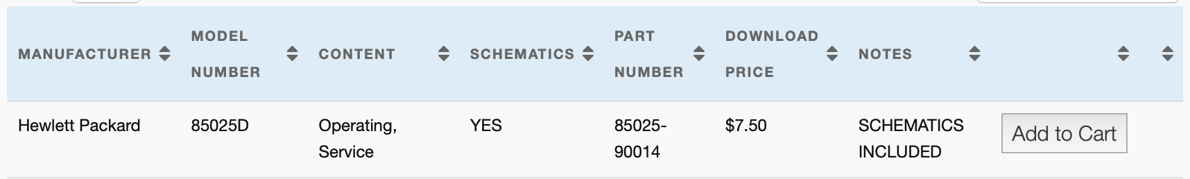

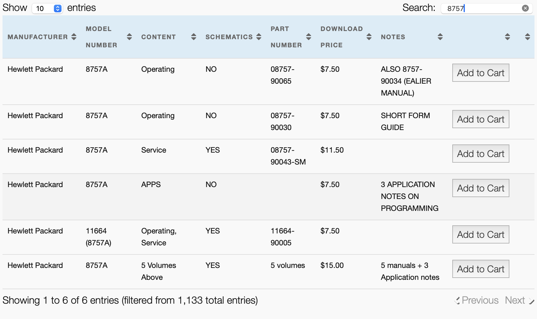

I would spend $7.50 on the service manual for the probe and another $11.50 for the service manual for the HP8757 mentioned in Post 2.
Or blow an entire $15 and get all five manuals for the HP8757. Like you said: No need to reinvent the wheel.
https://artekmanuals.com/manuals/hp-manuals/ I've gotten quite a few manuals from them over the years. They're good quality.
Tom
