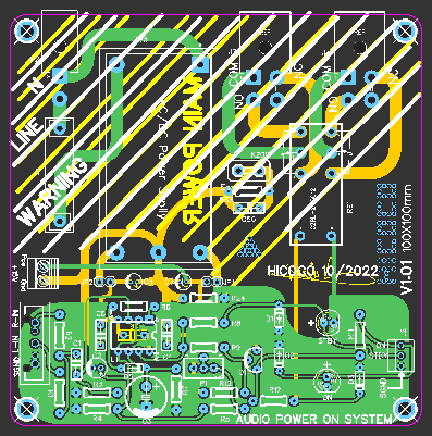

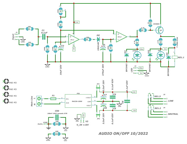

I made one PCB for my Active Speaker, For Gerber PM...
