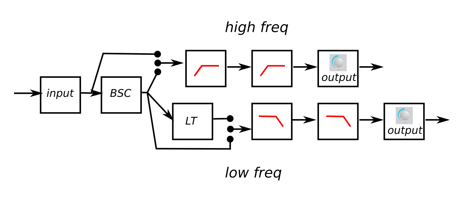

I've attached just a top level block diagram. Each block here is an opamp.

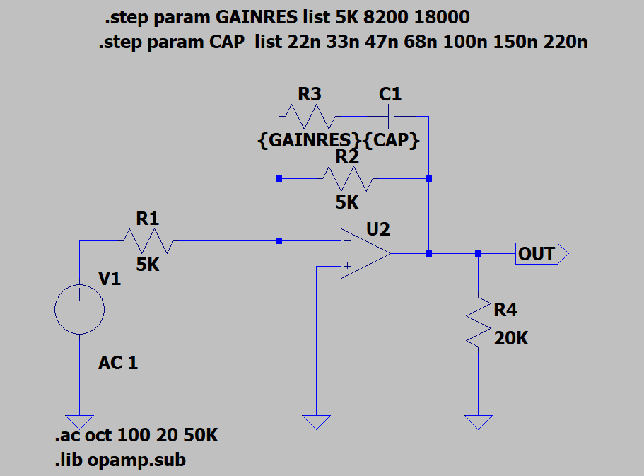

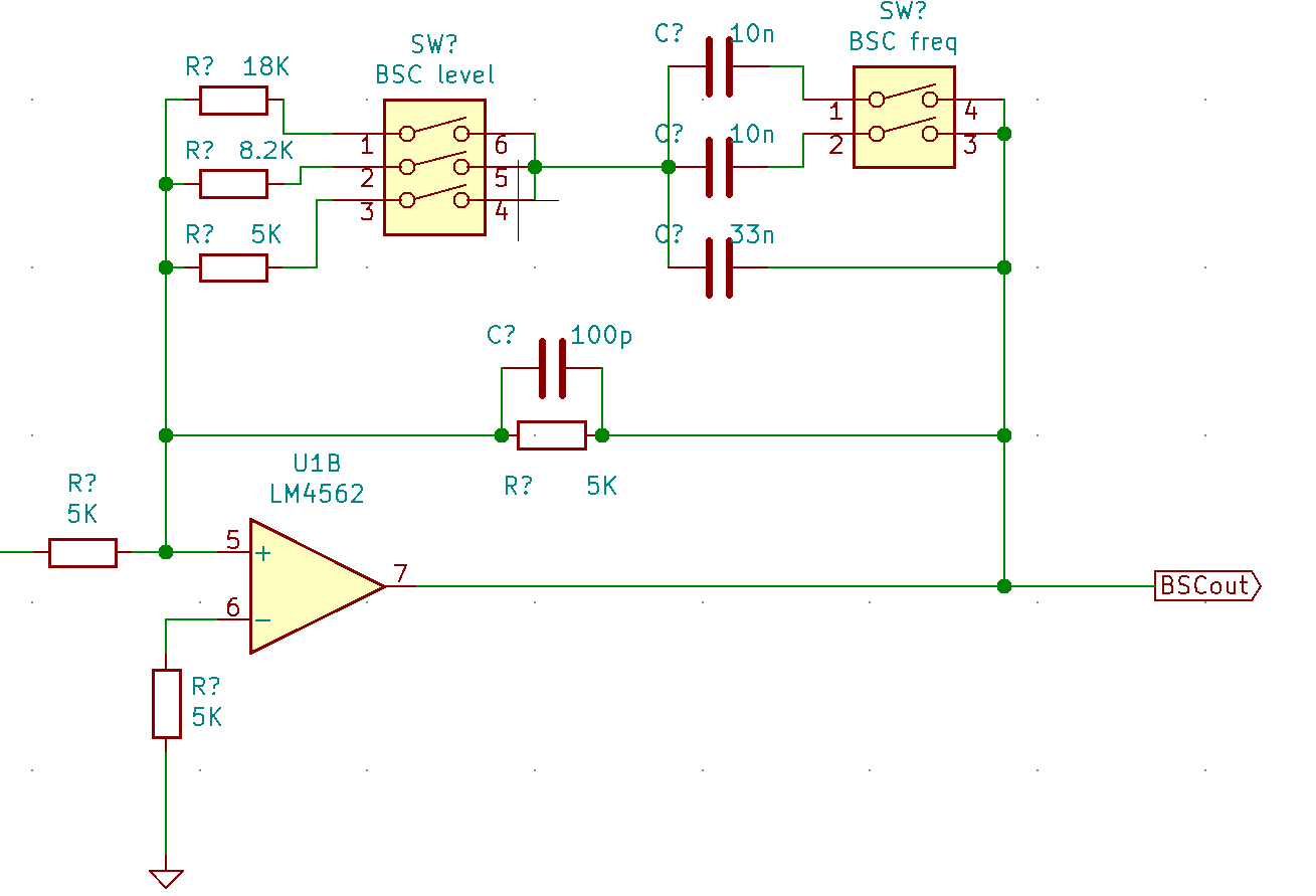

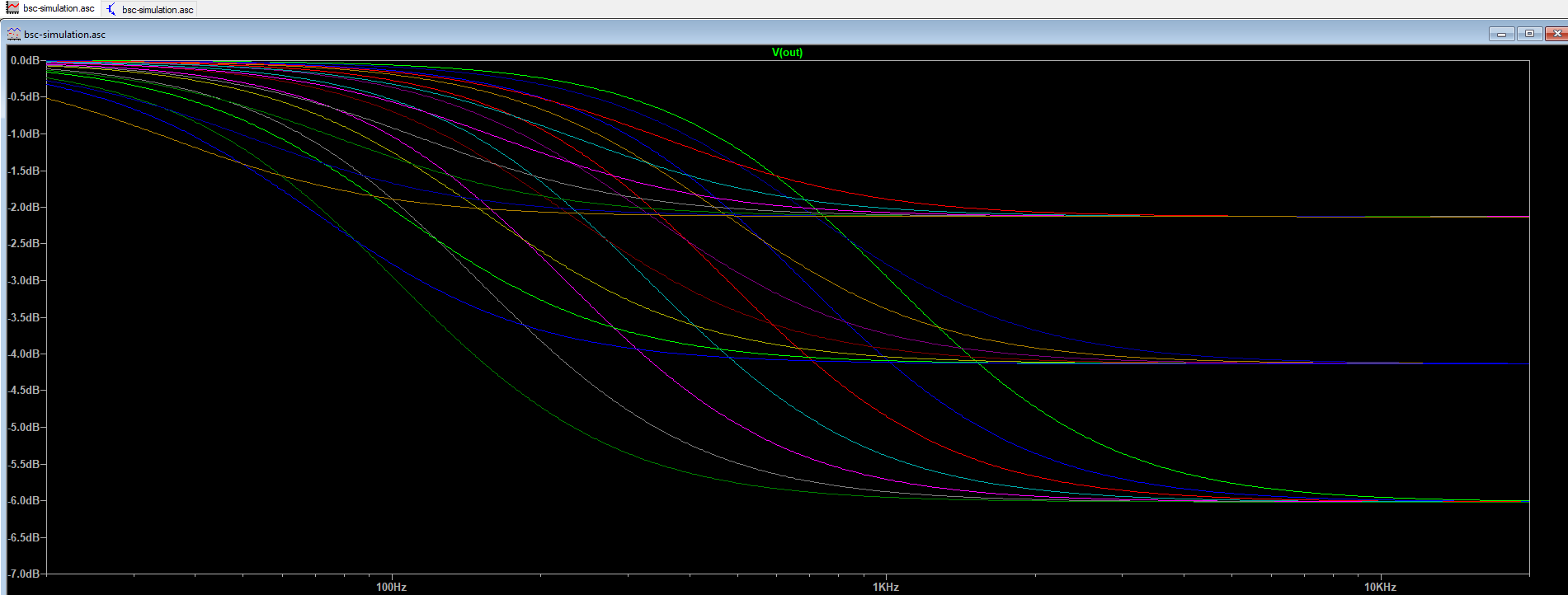

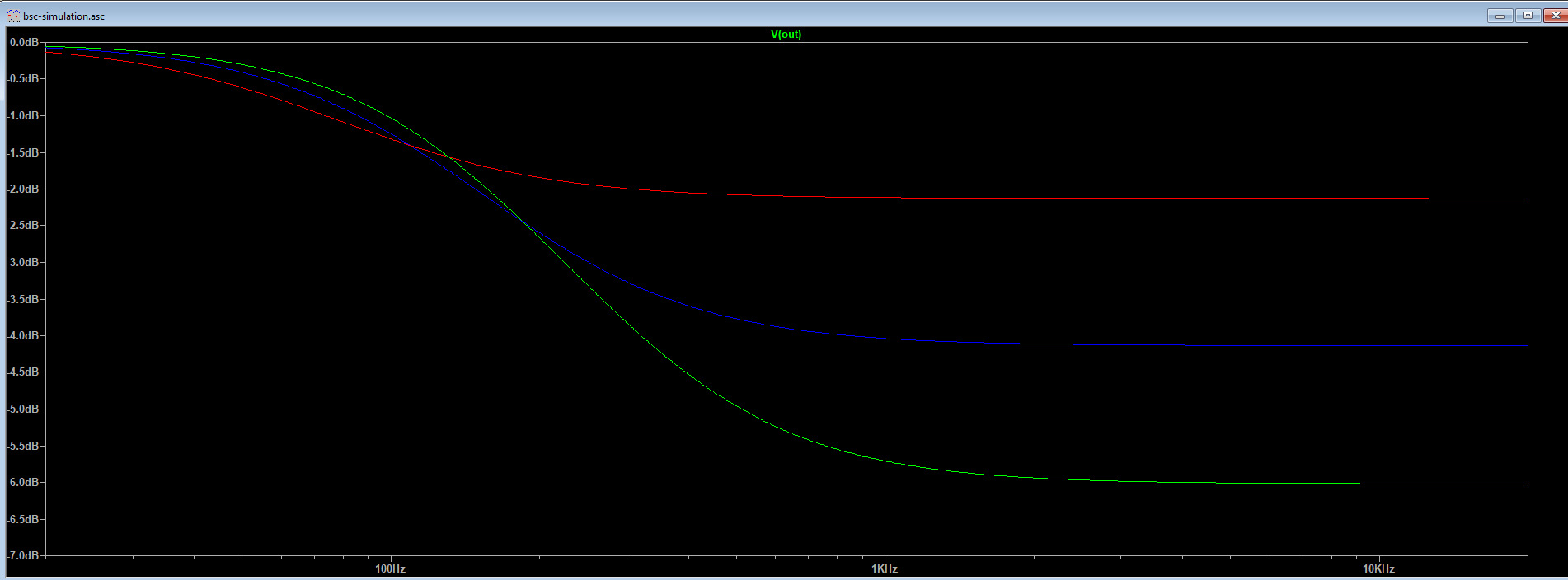

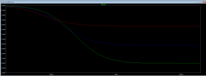

Tried figuring out baffle step. There's a simple circuit with an RC shunt at the input of a unity-gain buffer opamp, but I thought it would be more "interesting" to have filter components in the feedback loop, so I found something from Doug Self's book.
The equations he has given didn't seem to make sense with the response curve shown, so I tried some simulation. I found the curve shape I wanted, and played with stepping through values of the gain-control resistor and the frequency-determining capacitor. Simple formulae about an Fc didn't seem to make sense, they weren't correlating very closely or obviously with the shapes of the graphs. So I decided to leave the graphs as graphs. I'll let the builder choose the size and frequency of the shelf.
This is one part of the circuit which will need tweaking based on listening tests even after the speaker is built, because it depends so much on individual listening tastes and on room response. So, I decided to make it flexible for the builder to change the gain control resistor value, and the frequency-determining capacitor.
Shelf height control
The resistor value needs to be 5K, or 8.2K or 18K, to give you a 6dB, or 4dB, or 2dB shelf. That's enough control to meet pretty much any situation I've encountered. There's a 4-way DIP switch to let the builder choose this. The fourth "way" in the switch lets you completely eliminate the resistor, which means no baffle step at all. This can be used for experiments to "take BSC out" and see how it sounds. (If you really knew from the beginning that you don't want any BSC, you would not populate the resistors and capacitors and DIP switches at all to begin with.)

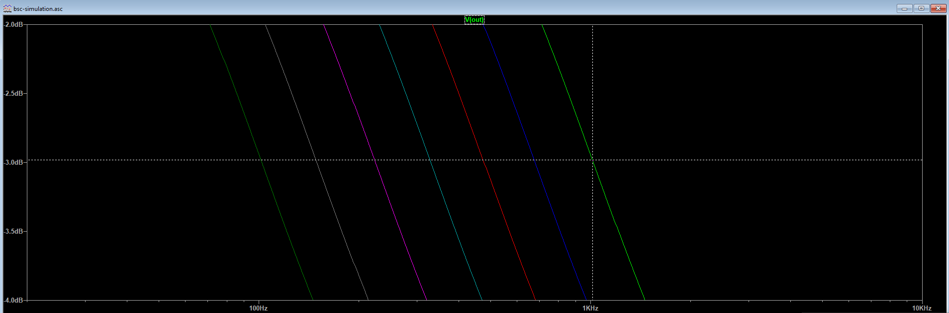

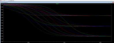

Shelf knee frequency control
I've plotted graphs to let the builder choose -3dB points from 1025Hz to about 100Hz, assuming that he's opting for a 6dB shelf size. Basically, it made more sense to me to see the graphs and "visually" decide what to try. From my table, the builder can choose the frequency determining capacitor. I've allowed for two additional capacitors in parallel, and a 2-way DIP switch, so that the builder can add a bit more capacitance and lower the knee frequency and try it out in his actual listening environment.
  • 22n: 1025Hz
  • 33n: 675Hz
  • 47n: 475Hz
  • 68n: 330Hz
  • 100n: 220Hz
  • 150n: 150Hz
  • 220n: 100Hz

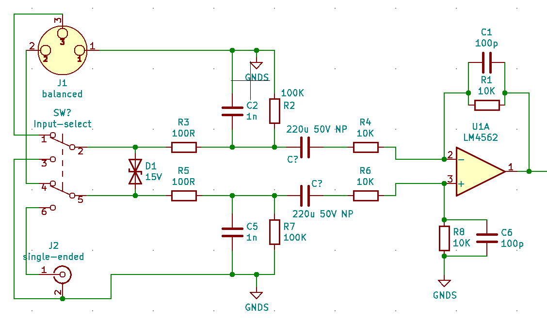

Input stage schematic
I'm thinking of using this circuit for the input stage.
Though I've shown the XLR, RCA and DPDT switch as symbols here, they'll be removed from the final schematic file because they'll be off-board, and I'll just put a 1x4 connector on the board edge to get the wires in.
Nothing much new and innovative here. Values shown are "normal", but the feedback resistor can be increased if more gain is needed here, if the later stages don't have much gain and the builder wants to run the circuit hot to increase SNR. The choice of non-polar electrolytic capacitors of a large value for DC blocking, as shown, may not find much support from audiophiles who believe all electrolytic capacitors are Very Bad.

Thanks for the kind words. [emoji2]
I'm going by Doug Self's extensive discussion on various balanced input circuits here. The 3-opamp in-amp topology is a classic. Another popular solution is to use a purpose-built That chip. But in normal domestic audio-frequency signals, at 100mV or thereabouts, not tiny signals like a fraction of a mV, with cables just a few metres long, Self says this single-opamp topology is good enough, and so I'm going with that.
This is not a world's best gold medal winner circuit. I want it to be more than good enough for "normal" situations that's all. If I build it and later face problems, I can always design a version with a different input circuit later. Designing and building have become easy these days.

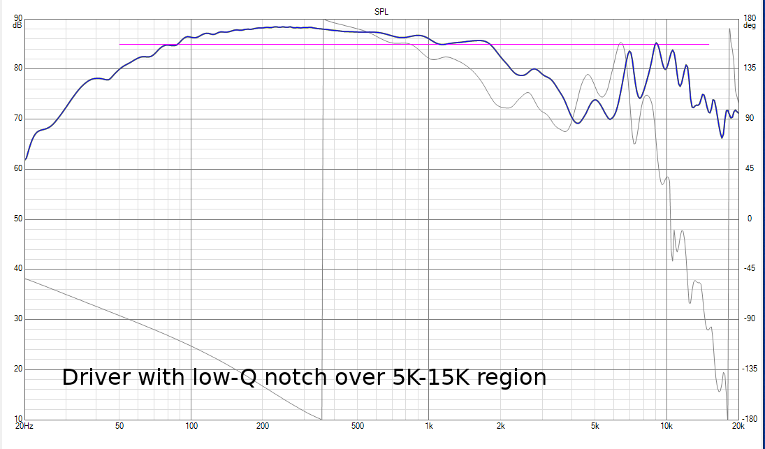

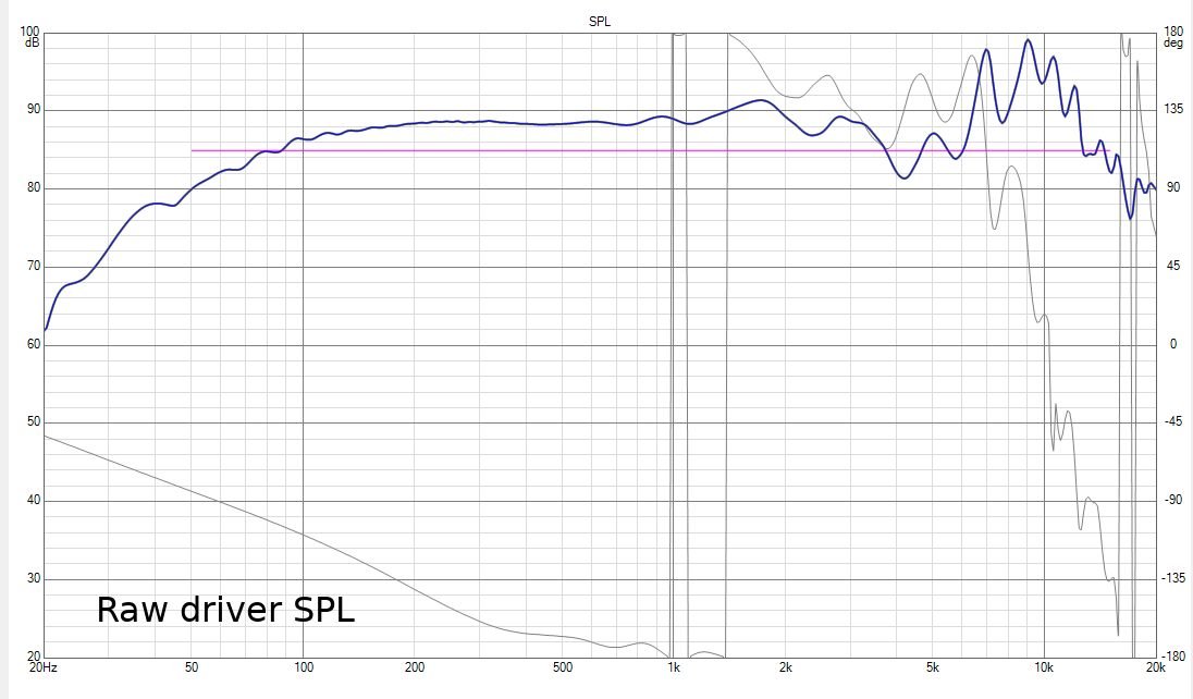

The last bit was the notch filter. I have one spare opamp, so I was looking at any notch filter circuits which wouldn't be terribly narrow (or high-Q) and would need one opamp. So, the Bainter notch was out, though it's supposedly very easy to configure -- it needs three opamps. So I picked this one, borrowed from the Baxandall tone control, actually. This gives me a wide, low-Q notch, which may be useful to suppress cone breakup regions of midbass or midrange drivers.
One doesn't really know how useful a notch filter is till one applies it to some real world bad boys from speaker drivers. So I picked the Dayton RS180 aluminium cone midbass driver, famous for high performance and vicious cone breakup. Loaded the driver SPL curve into VituixCAD and tried applying the notch filter. I tweaked the parameters to get the notch to spread just right, across the cone breakup region. I've attached the SPL curves here with and without the notch filter. You can decide whether this kind of notch is useful. I thought it could be handy in some cases. I'm still not done experimenting with notch circuits -- there's one more I have found, which may be useful. Will post results once the sims are done.
As you can see, many of the components do not have values. When my design is done, some of them will get values, others will remain blank and I'll write a note explaining where to get values from.

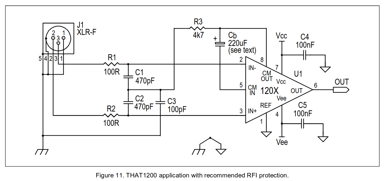

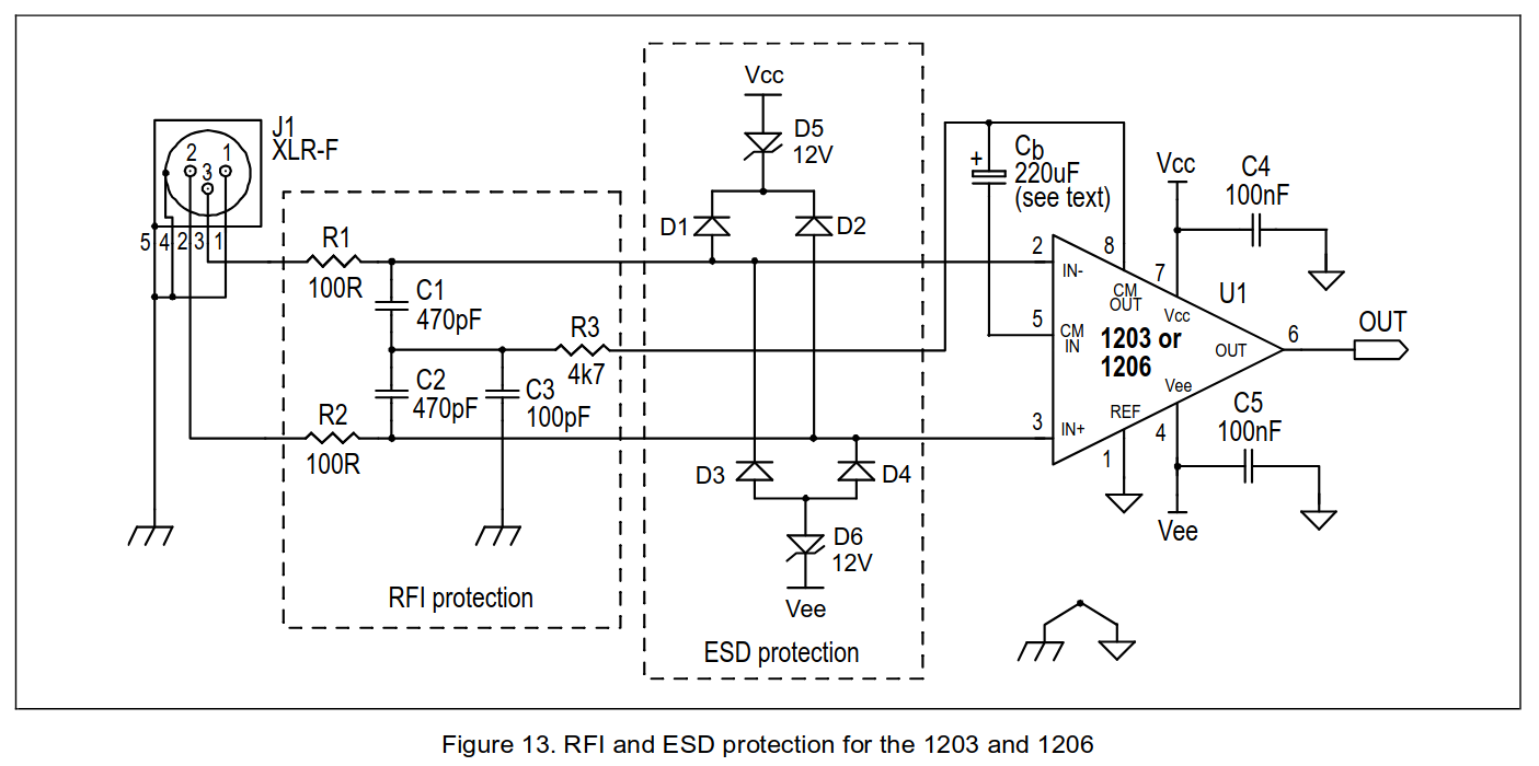

I've decided to replace the opamp-based input with a THAT 1206. The application note gives this circuit:
I'll just use this unless one of you tells me it needs work.
Instead of the THAT chip, there are more modern chips like the LME49724 (or its successor, the OPA1633) and the INA165x. I am thinking of using the INA 1651 single-channel chip. This circuit for a 2-ch line receiver (INA1650) is given:

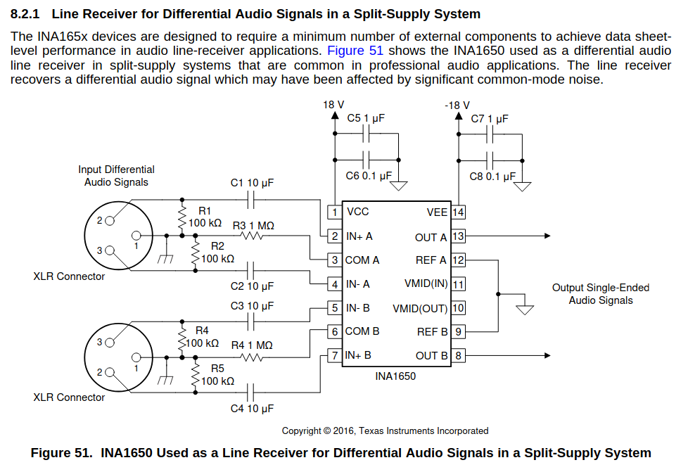

There's this circuit example too, using the INA 1650. I will not need the output-side capacitors etc, because in my case, the single-ended signal will feed the active xo.
It may be a good idea to add the ESD and RFI suppression components to the input tracks before the IC.
None of these new chips are available in DIP packaging, only in SMT.

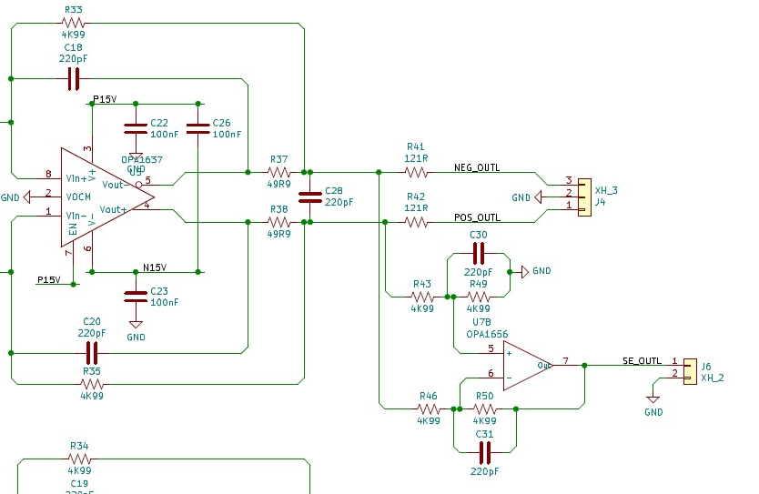

In the BTSB "Best Thing since Sliced Bread" balanced-input board, this is what is happening after the differential amplifier:
After the differential amplifier IC, there is an opamp being used to convert the balanced output to single-ended. Is this necessary? Is this being done just to drive more output current? If the output current from the differential amplifier is adequate to drive the balanced outputs, is it not necessary to drive the unbalanced outputs too?
