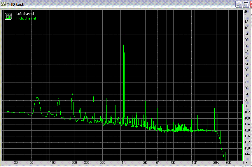

Hi Dave,
For my own information here, do you mean something like this:
Yes... looks like a PP amp with little or no 2nd order, but a fair amount of 4th and some higher. Anything above 3rd the ear really finds objectionable, and the lack of 2nd means the 3rd isn't as well masked. An ideal spectrum would have some 2nd, a bit less 3rd, and vanishingly small higher order components.
dave
Disabled Account
Joined 2007
dave
Thanks,
Looking at the scale the higher harmonics are about -100db, including the 4th. That's a long way down.
Are you sure this is hard to listen to?
