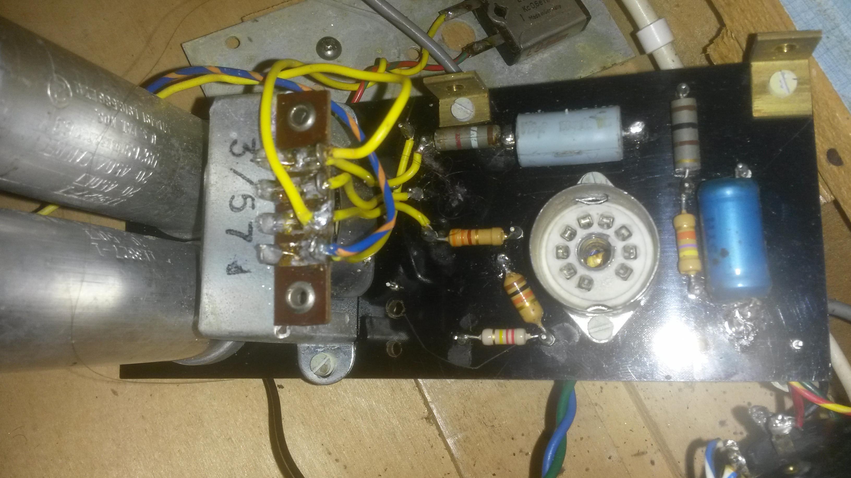

A triode/pentode tube. Like ECL82. Pin 6 is pentode plate and pin 9 is triode plate.

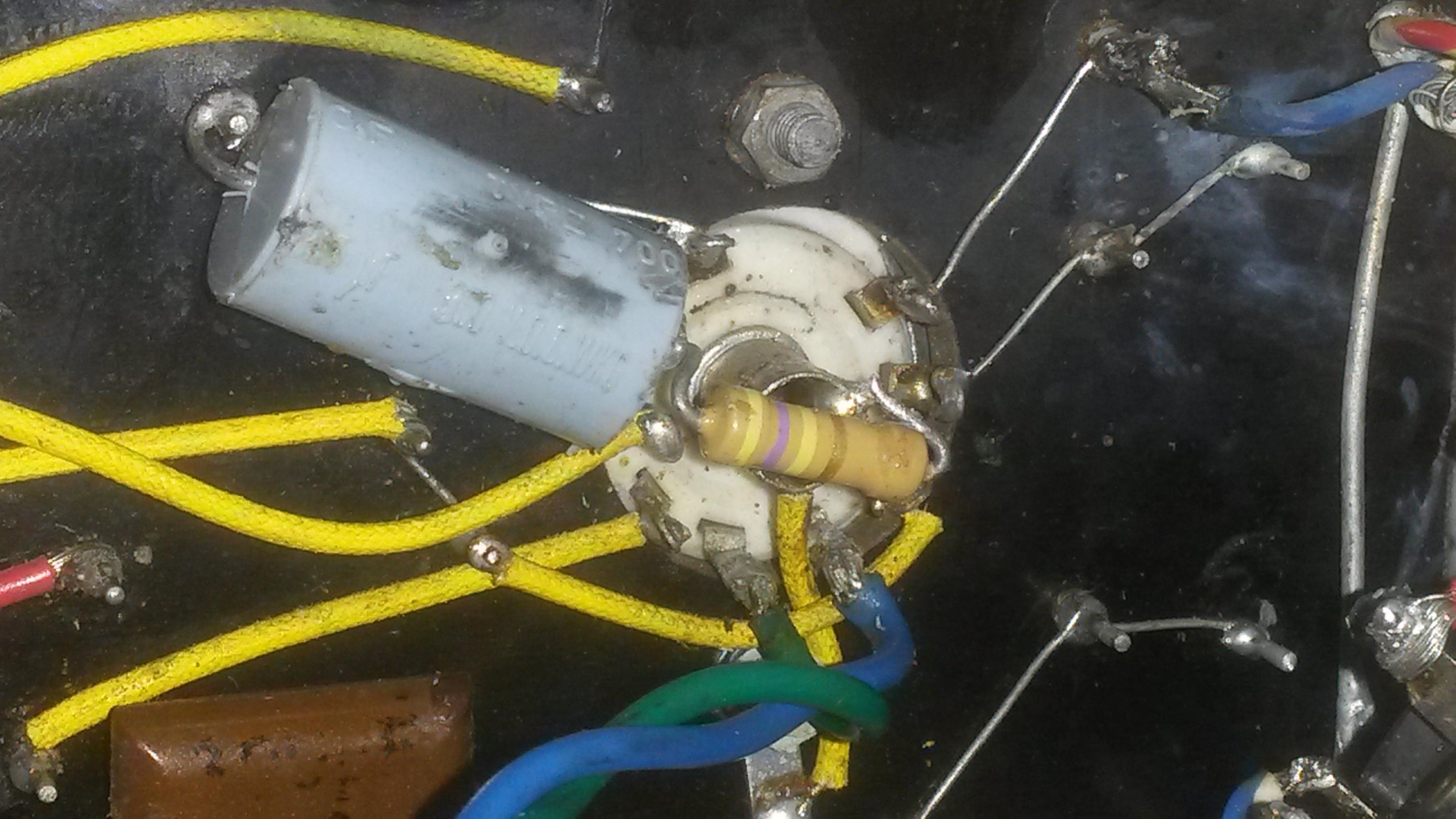

I'll look into the possibility of the ECL82, previously I didn't think it was this but i am getting 288 volts on pin 9 of the socket and 345 volts on pin 6 (both readings taken without valve).
Do these sound realistic for an ECL82?
The input signal from the pot is on pin 1.
Thanks again

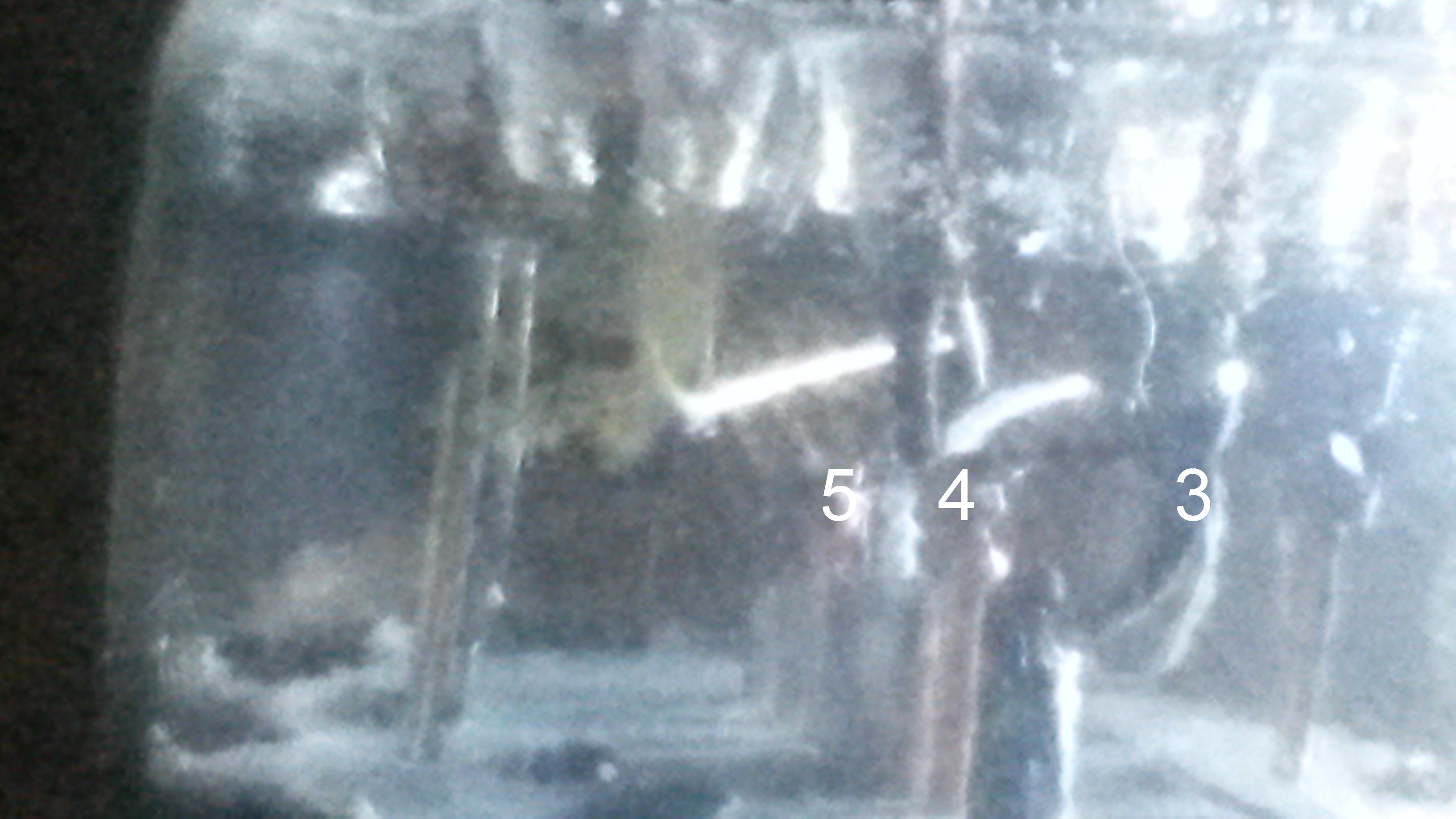

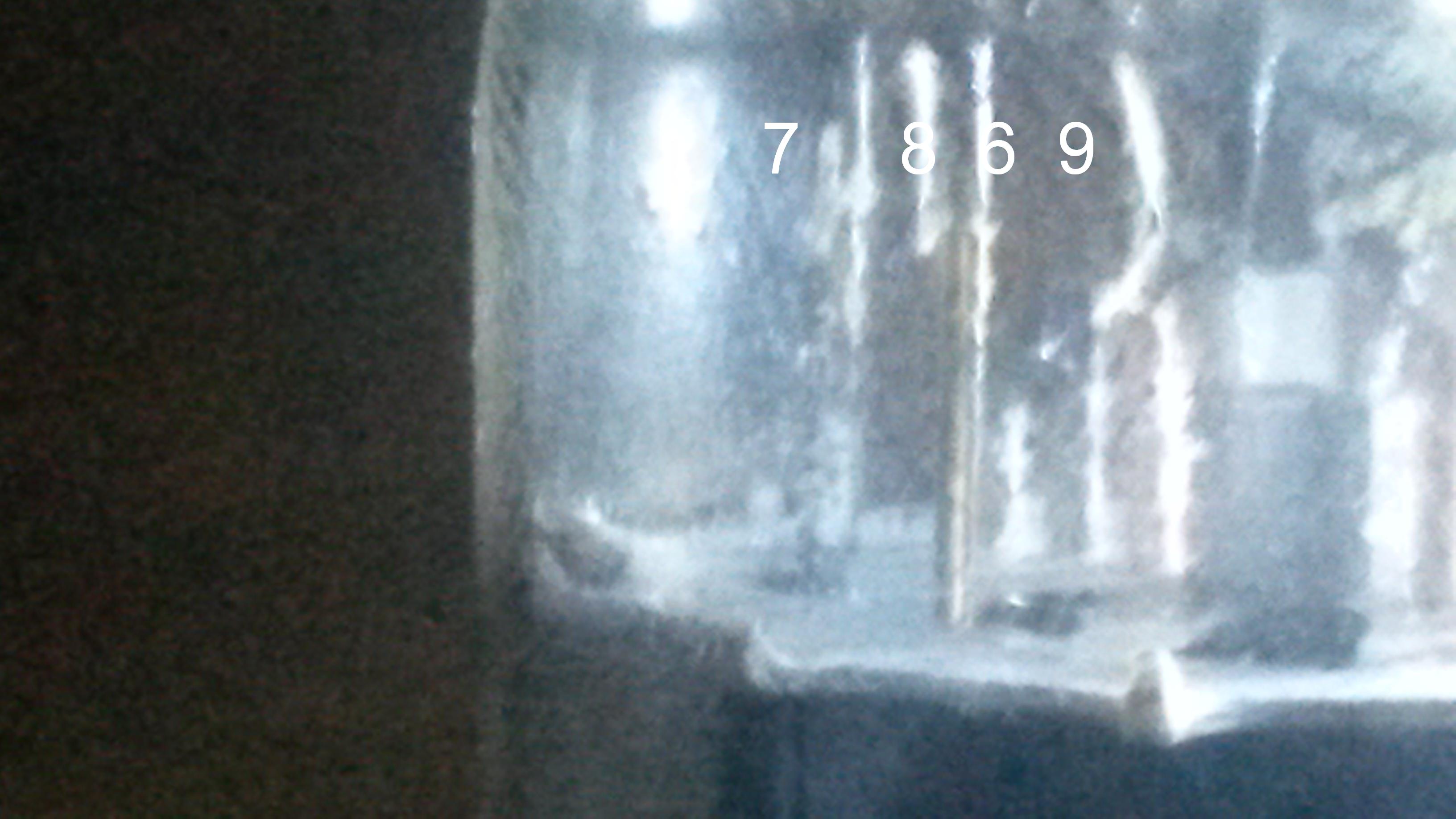

After a good look, it's definitely a circuit for a E(P)CL86.

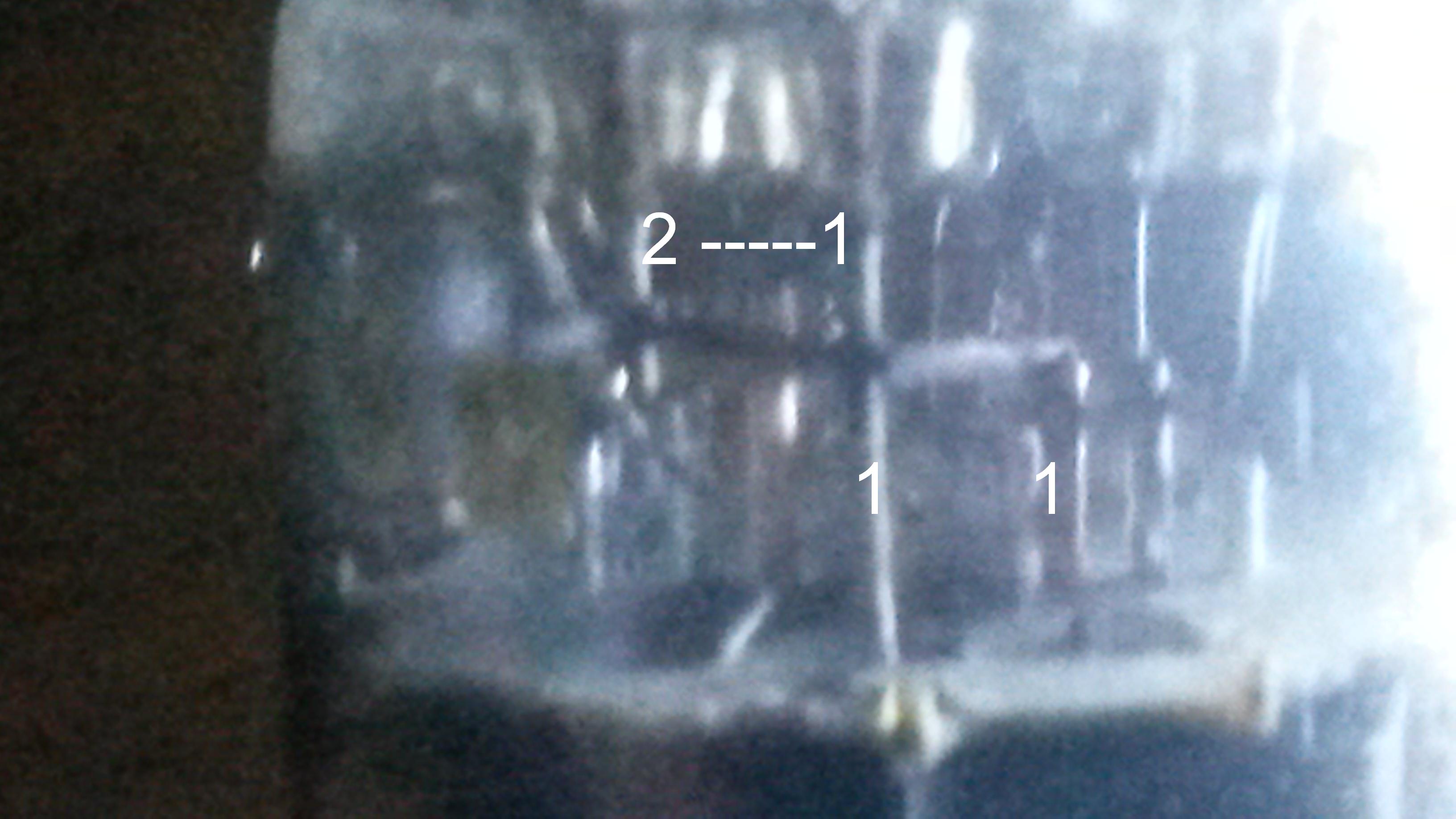

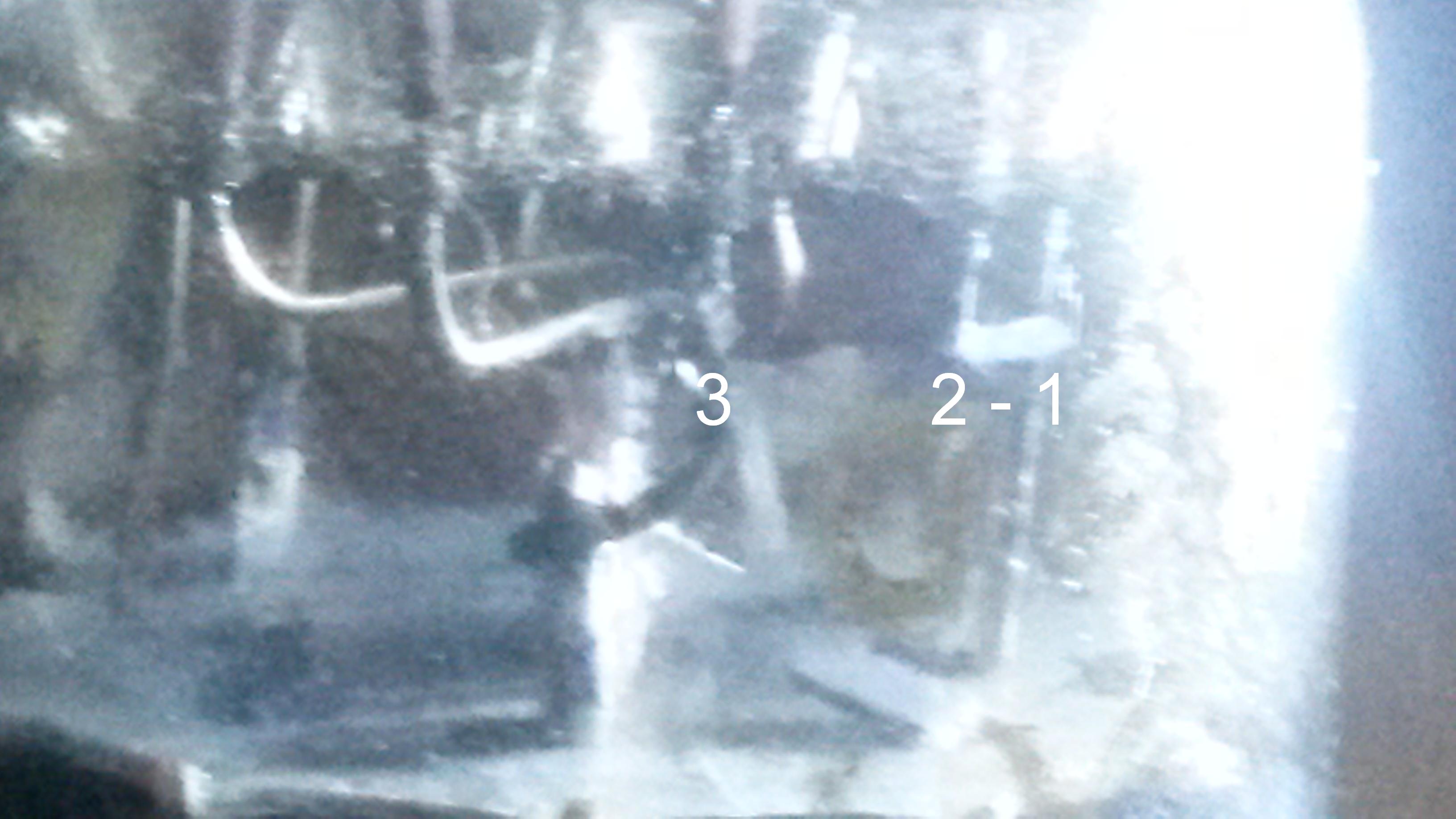

If pin 1 and 2 are connected in that tube then it is not the one for that thing.
Could be a 6BW6.

The PCB circuit is for an E(P)CL86 or 6BW6? 🙂
and...
The valve supplied is not for this circuit / PCB?
