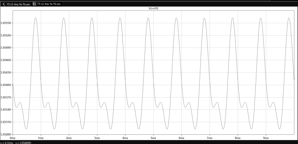

Someone asked about the voltage across R9,10.
This is a plot of 1W 1kHz into 8R.
As you can see the voltage is largely constant (good match between push and pull).

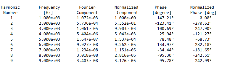

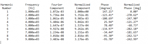

But some 1kHz fundamental is still visible (push-pull not 100% perfect).
And 2nd harmonics is clearly visible, as also confirmed by the FFT.
Patrick
