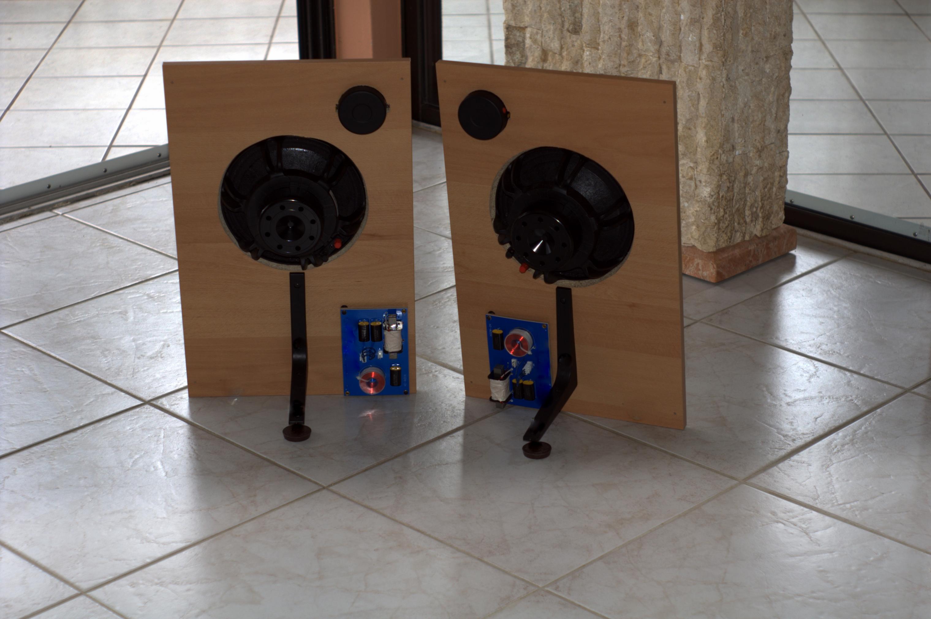

The crossover topology is fairly typical for this project. The woofer is crossed at 2000 Hz (initially), 2nd order electrical LR-2. The tweeter is crossed at 1800 Hz, 2nd order electrical. There is an l-pad on the tweeter which yields a 2dB reduction in SPL and the polarity is not reversed with that of the woofer.
The apparent overlap of the woofers x/o is an intended part of the design. Unique to this circuit is a variable rheostat which is shunted at the woofer’s terminals and adds variable resistance to the crossover circuit as well as the load the amplifier sees. This affects the LF crossover point and effectively scoops-out the midrange, in a manner that can be dialed-in by the listener. In this design, it is an effective way to compensate for dipole roll-off, as there is an additional 8dB of SPL produced by the LF driver when compared to that of the selected HF driver. Keeping resistance at the 2 primary legs of the potentiometer between 8 and 30 ohms, will result in a total load of 4-6 ohms per side, which should be safe for many SS amps. Dialing in the resistance settings will effectively fine tune the LF crossover point somewhere between ~1000Hz @ 4 ohms and ~1800Hz at 30 ohms with an infinite range of points in between. In my environment, a final resistance setting of 18 ohms produced the flattest on-axis in-room measurements and yielded a total load of 5.6 ohms per side that the amplifier sees. The additional 2dB reduction of the tweeter as noted in the previous paragraph (level match) was determined only after a suitable crossover point was selected and measured. One can simply alternate between dialing-in a crossover point, then tweeter attenuation, in that order for an infinite array of points within the intended range of this design. I suppose the rheostats could ultimately be replaced by particular values of series and parallel resistors once a proper x/o is achieved, but I enjoy the flexibility as well as the ability to demonstrate my design concept on-the-fly.

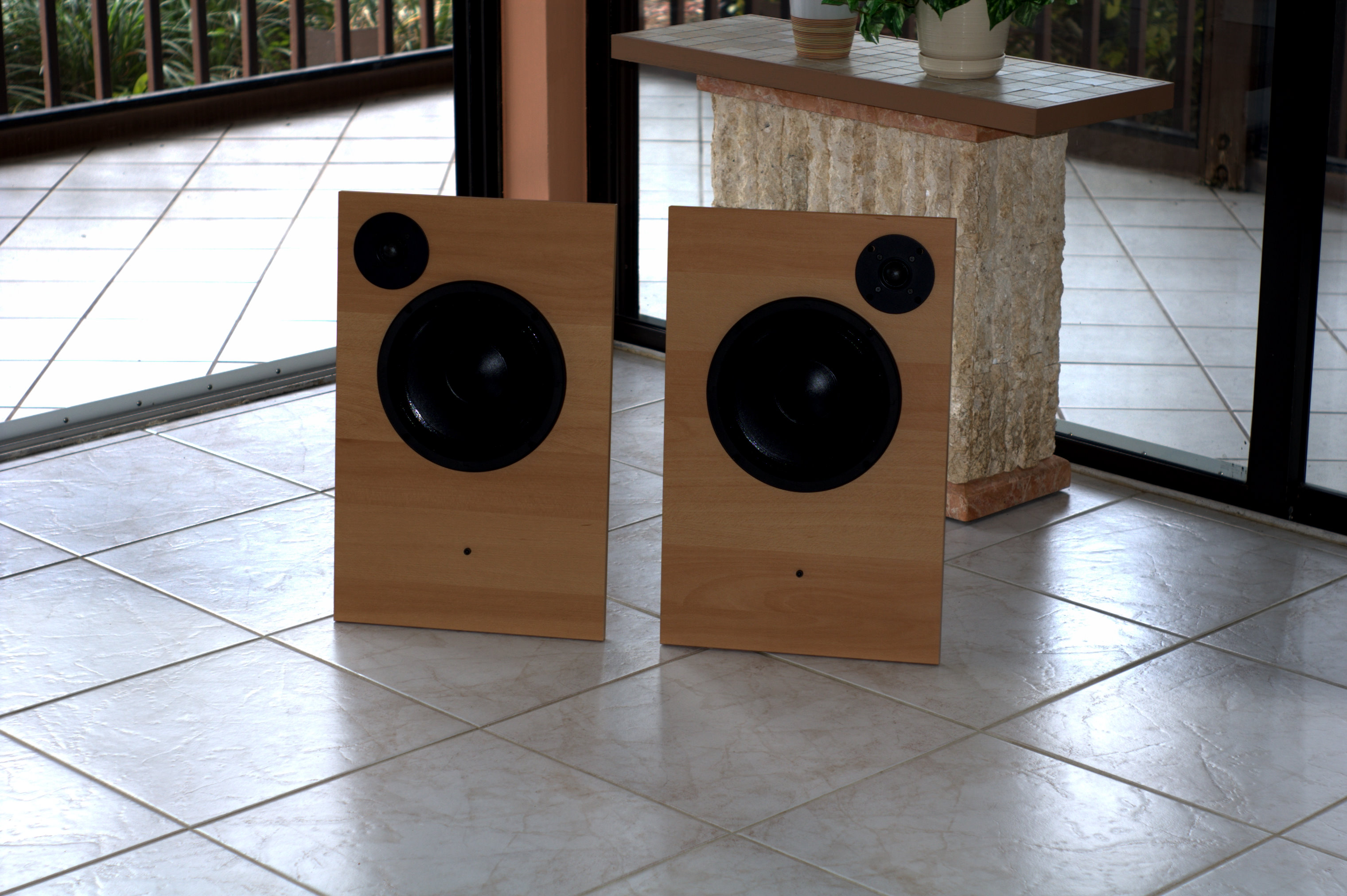

Final baffle size is only 15” wide by 24” tall. The woofer cut out is chamfered in the rear and centered 14” from the bottom. The tweeters are mirror imaged; their centers are 3” from the top and 3” from each side respectively. The baffle sits on 3 sorbothane pads in a tripod configuration, the rear pad is situated on an adjustable foot which moves +/- 1.5”, allowing baffle tilt toward the listener.
How do they sound? Powered by a single NAD 30 watt integrated amplifier, these things are smooth. They also play loud at low volume settings and do not strain when you crank 'em. The B&C suspensions are very stiff and take about 200 hours to fully break-in. As they do, the midrange smooths-out and the bass gets more powerful, but remains well defined, weighty and clear. Listening to Brian Bromberg on acoustic bass sounds amazing, as does the piano work of Keiko Matsui and vocal presentations from Cat Power and Diana Krall. All-in-all sometimes simpler IS better. I also like the ability to easily transport them and get great (and consistent) results from a variety of amps and venues.
