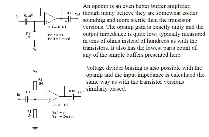

The OP can use a Quad 405, IF he builds a buffer for the PAS. Even something built around FET I/P opamps will do.

Here's a low cost option. The board can use an FET input IC, set up for unity gain.
It's possible to mount this inside the PAS, and run the pcb off the +/-12V filament supply,
in which case nothing else is needed other than the op amp. There is ripple on the filament supply,
but the op amp circuit will reject it well enough. Dual OP Amp Board Preamp DC Amplification PCB for NE5532/OPA2134/OPA2604/AD826 | eBay

With one little board, and a dual OP on it, I can have, from my Pas3, an output impedance low enough to be used with a Quad 405 ? And powered by the voltage for the filament ? Cool !!!
A OPA2604 is exactly what I need, or there are best suited OP for what I want to do with ?
An thank you for all ! 🙂
And powered by the voltage for the filament ? A OPA2604 is exactly what I need.
Use a 100k or higher for the pcb's input resistor, and a DUAL fet input op amp
that is unity gain stable. The OPA2604 would work.
To modify the pcb: Replace R1 with a 100k. Remove R3. Replace R4 with a wire.
Then you have a unity gain buffer with Rout = 47R, that can easily drive a 20k amp.
