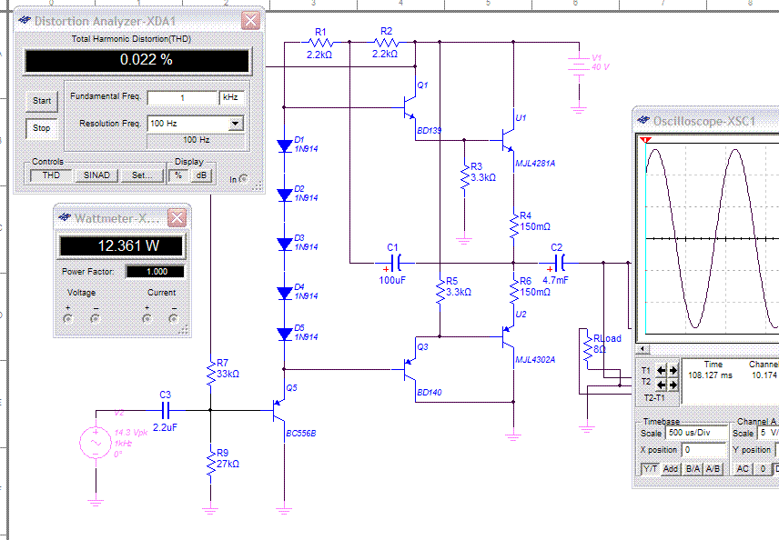

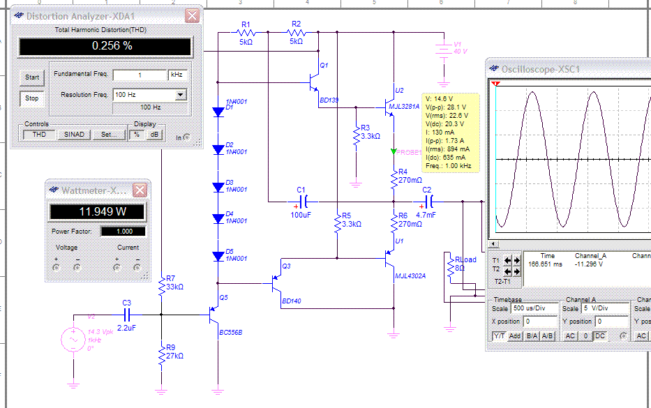

Close to the original, with some changes.. I tried a few different combinations, with different results with a few devices.
Using a diode string of 5 and increasing the bootstrap R's put the idle current and full power current close to his specs.
Anyone have other possibilities in mind? Different devices? I'm just probing around in the dark here, as I'm not as knowledgeable as I'd like to be.

0.02 % THD
at 12 Watt RMS
is a very good output stage
Refering to my own (and Hugh 'AKSA' Dean) criteria = Max 0.05% THD
for my hi-fi amplifiers.
I have this target value, because there are no certain evidence
that human ear + mind perception
can hear distortion at 0.10 % THD levels.
Of course, your THD figure may be a little bit higher in real circuit.
This comes from the fact that you use Ideal 40.0 Volt Supply, in spice.
This and some copper rail issues in your PCB practical layout
will add some distortion, for sure.
How much, depends on your Power Supply, including transformer size + Caps filtering + wiring.
Also real loudspeaker is a more difficult load, than pure 8 Ohm resistance.
One guess would be, that you will endup around 0.05-0.10 % THD.
At 8 Watt RMS output into speakers.
As www.firstwatt.com tells us, a good sound quality at First, 1 Watt and below is most important.
And your output stage will perform very well, in real life,
at those output levels.
At least, this is my own thinking, speculation.
But we do not know if I am right.

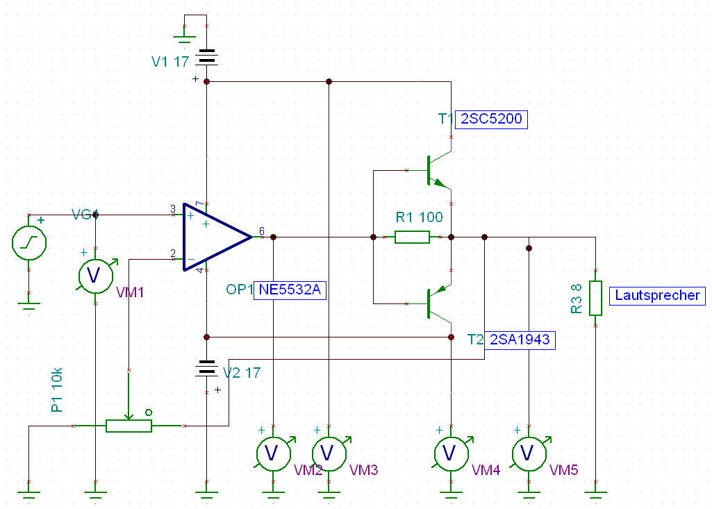

There are different "adjustment free" topologies. I know the follow:
1) Quad 405 (current dumping)
http://www.fralu.de/images/qaud405.jpg
Quad 405 Information Page
2) simplefield current dumping
http://www.mikrocontroller.net/attachment/63841/Audioverst_ker.png
http://www.elv-downloads.de/service/manuals/400W-Verstaerker/07903-400WattVerstaerker_km.pdf
3) servo controlled bias and offset (see attachement and older TAA edition - only N-Channel MOSFET amps)
The topologies from #22 and #23 are actually not "adjustment free" for the idle current through the output cause the depend of tolerances to the threshold voltages (diodes, Ube power buffer).
