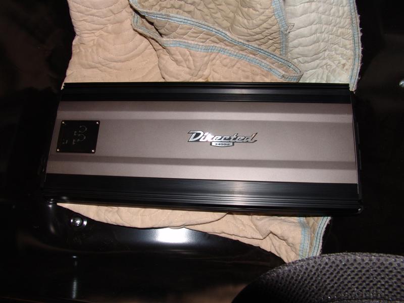

The title says it all. In a nutshell a friend and I had a stereo installed in a Yukon Denali XL. The amplifiers that keep burning up are Directed Audio 2400Ds. There are a total of 3 of these amplifiers powering 3 JL Audio 12W7s. Two of the amps have been sent back to Directed and replaced. Those amps have now blown again within 6 months after being replaced.

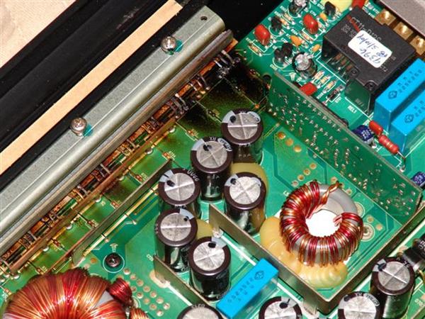

BTW both amps ended there existence via an entire channels output stage letting the smoke out. See pic

From the photo, it's difficult to tell which transistors actually failed. Can you post an overall photo of the board and two more, each showing 1/2 of the board?
It's rare that outputs fail as those you've shown. It's typically power supply transistors that make a mess like that. If the outputs failed, you can be confident that the power connections in the vehicle are not the cause.
that looks more like the amp's mosfets for the SMPS blowing up.

djQUAN said:that looks more like the amp's mosfets for the SMPS blowing up.
thats what i was thinking.
The failed FETs in the picture are in the power supply. The 'outputs' are on the other end of the amplifier. You need to check them with a multimeter set to 'diode check' or ohms to determine if any have failed. If you find a transistor that reads zero ohms (or near zreo ohms) between any 2 of its 3 terminals, it's defective. If any of the transistors in the audio section have failed, the power distribution is not the problem and you should check anything/everything connected to the output of the amplifier. If there are no defective transistors in the output section, the amplifier's switching power supply may have a weak point in its design.
