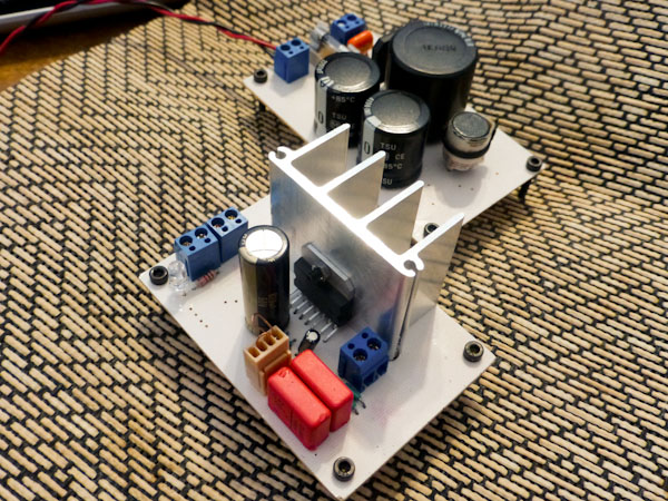

TDA7297
After a while since my last post, this is what I have brewing at home lately… as before low wattage chipamps on a BTL configuration say 10 /15 W this time TDA7297 from STM for which I have made 2 slightly different PCB’s for a cleaner testing rig and planning for a third incarnation to include small implementation details that have been rising during testing. Also did another PCB for the supply almost identical as before on a CLC configuration which gives around 13.7V loaded.
Here is a pic of the actual implementation

Did check on that, but there is no change soundwise. Will see if other chips are better on this regard, still thinking on the 1553 could be the ansewer.
