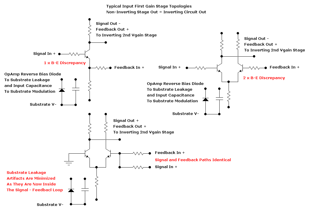

Inverting vs. Non-inverting Feedback Amplifiers
In order for the full advantage of feedback to be realized, the feedback signal and the input signal must follow the same path through the circuit, otherwise errors will be introduced.
If non-differential input is used, feedback is applied to emitter of input transistor, introducing a B-E discrepancy. When using differential in (circuit) non-inverting mode, there is a 2 x B-E discrepancy.
With the exception of DiFETs (OPA627/637), all opamps will have an additional source of error due to reverse bias diode-substrate leakage that exists for all components on the die (Substrate is connected to V-), and input capacitance-to-substrate modulation.
Substrate leakage artifacts are the root cause of the "Opamp Sound".
The solution is differential input where input node and feedback node are identical. This will also ensure the application of feedback does not introduce any new distortions.
Makes no difference if op amp, discrete transistor, or tube implementation.
