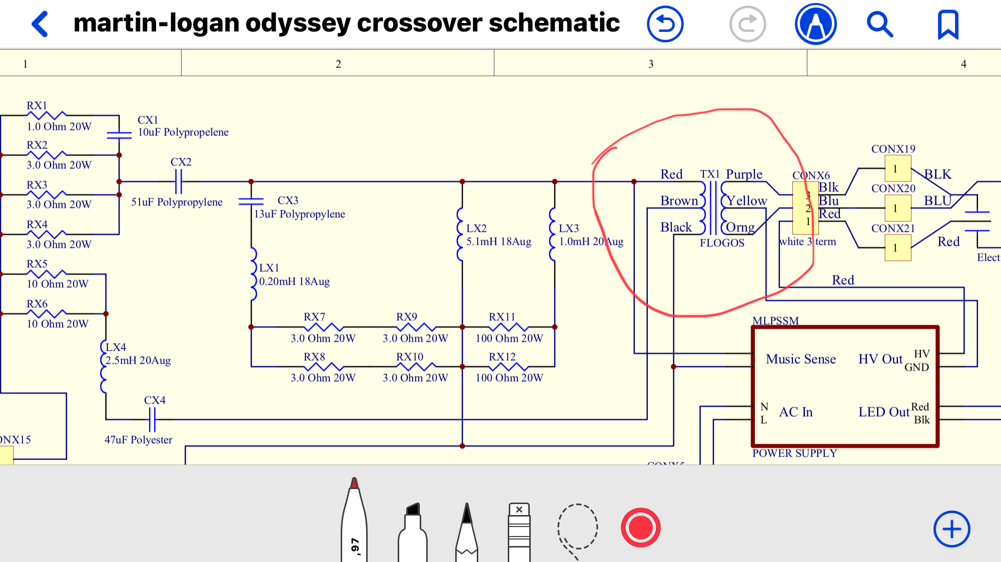

While we at this may I ask why does ML step up trafo has a ct on primary side.

That is the cross-over network. Can't see the whole schematic but if this is a hybrid, it separates the lows for the woofer and the mid/highs for the panel.
It may also provide equalization of the freq response and/or impedance flattening to make life for the amp a bit easier.
Calvin will know more details.
Jan

…why does ML step up trafo has a ct on primary side.
If the main primary winding gives 70:1 step-up ratio, connecting to the CT gives 140:1 step-up ratio. This provides additional flexibility in equalizing the dipole roll-off of the ESL panel when the wavelength gets longer than the panel width.
Dipole phase-cancellation in ESL speakers
For Fullrange designs, it could be used similar to the Audiostatic Mirror drive setup.
Audiostatic's "mirror drive": DIY possible?
In the Odyssey, ML appears to use it to help shape the equalization of the dipole roll-off.
A smoother, less peaky curve is achieved than the usual underdamped 2nd order HP filter approach.

In older designs, ML connected shunt inductance to the CT rather than actively driving it.
My only thought on this was that it allows the use of lower value inductors, so might have been cheaper or just physically smaller.
Toroids for ESL's (compare Figure A vs Figure B)
