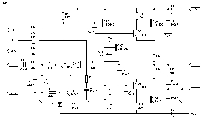

The transistor's Hfe is not really the deciding factor in your amplifier's voltage gain. Using this circuit (which is a great DIY circuit for anyone from beginners to EE's) as an example, the ratio of R4 and R5 determines the voltage gain. R5 must = R2. R2 determines the input impedance of the amp. Q9 controls Vbias, and so Iq is controlled by VR1. Q9 is mounted on the heatsink to automatically adjust Vbias as temperature changes so the OPS won't go into thermal runaway. This is basically the same for almost all amps, but MOSFET amps don't require thermal tracking.

😱 Ahh! Sorry about that! I never even looked at the OPS config. He's right. With CF (complementary feedback, the collectors of the OPS go to output), Q9 follows the drivers, with EF (emitter follower, the emitters go to out), it follows the OPS. Also, with EF, the drivers' emitters go to the OPS's bases. My bad.
