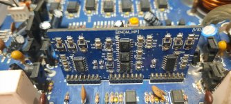

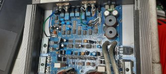

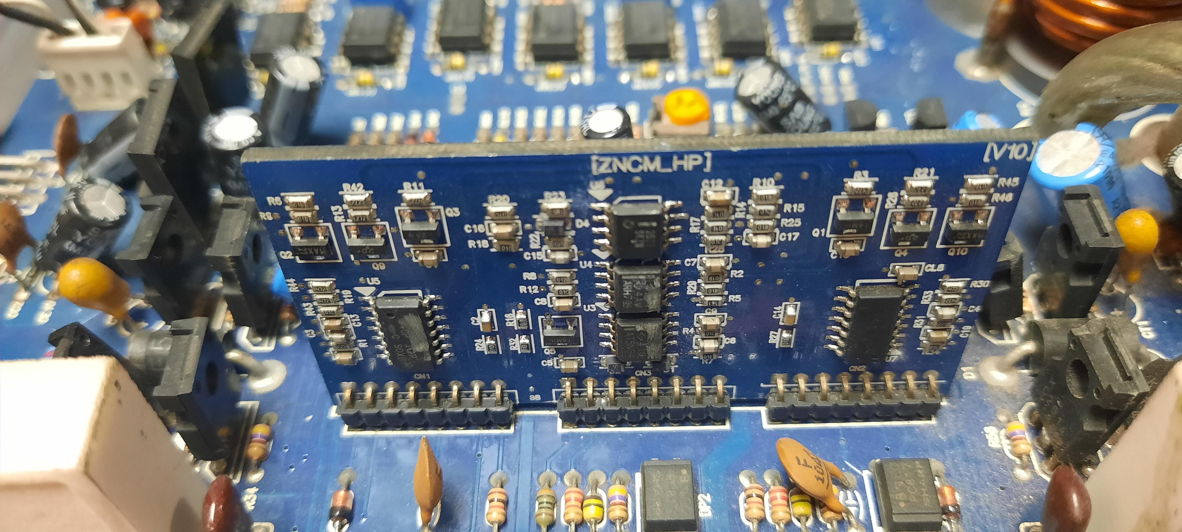

Well, in the end I managed to get the parts from a local store, however the amp is muted, when putting the load on a speaker it starts to oscillate, but I still don't get any audio on the output and if I press the master slave button it only gets hear a bang this every time I press it
I attach requested photos

check the voltages on the class d card and they are present at +5 -5, the audio signal does not arrive at pin5 of the central header you will have a diagram close enough to track the audio signal or any suggestion of where to check

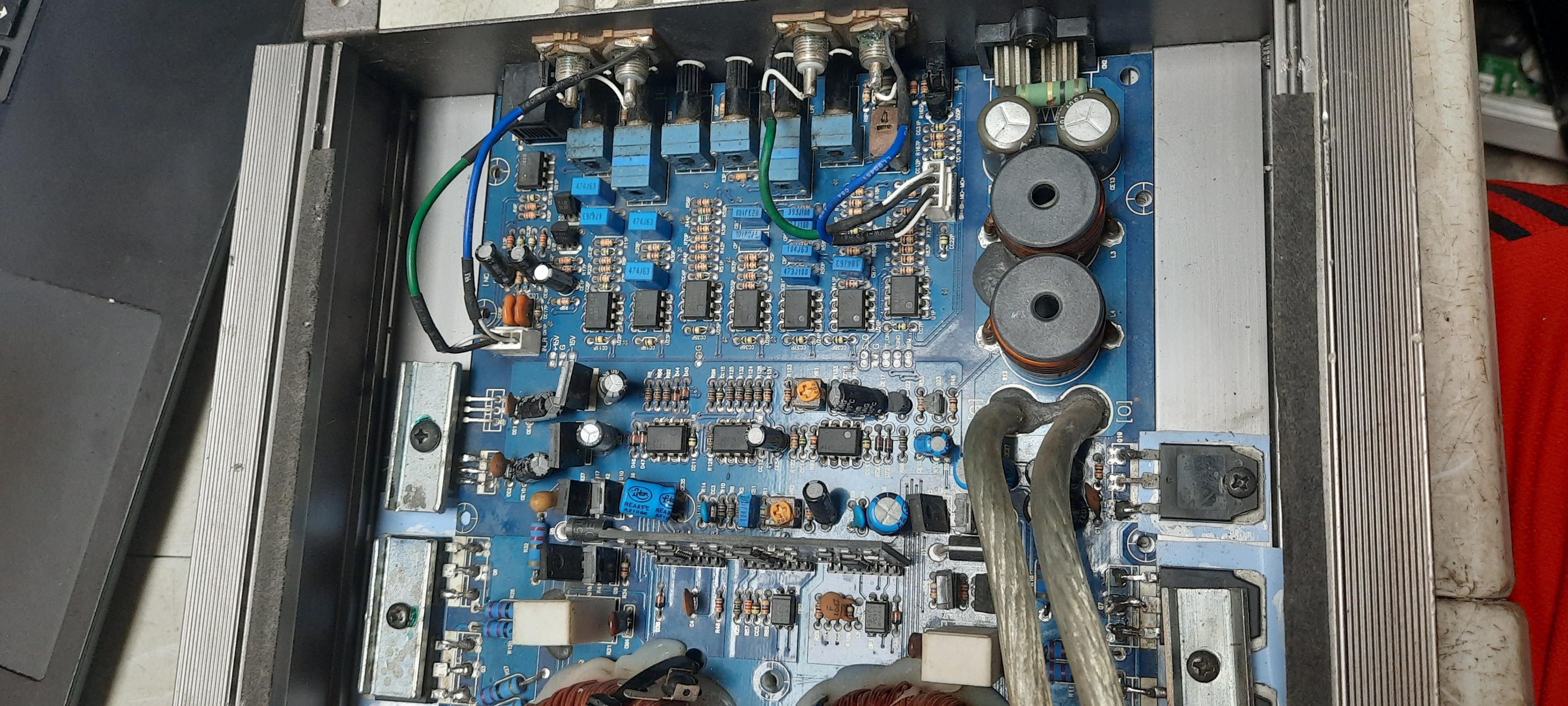

those pots are extremely dirty. Can you post a full photo of the board? I don't recognize the vertical inductors and can not see them on any xfire amps I searched for. The card if in question has been replicated by a couple people but AlbertLeRoux can help if you need a new one, also believe AmpLab has them as well however they are both in the US.

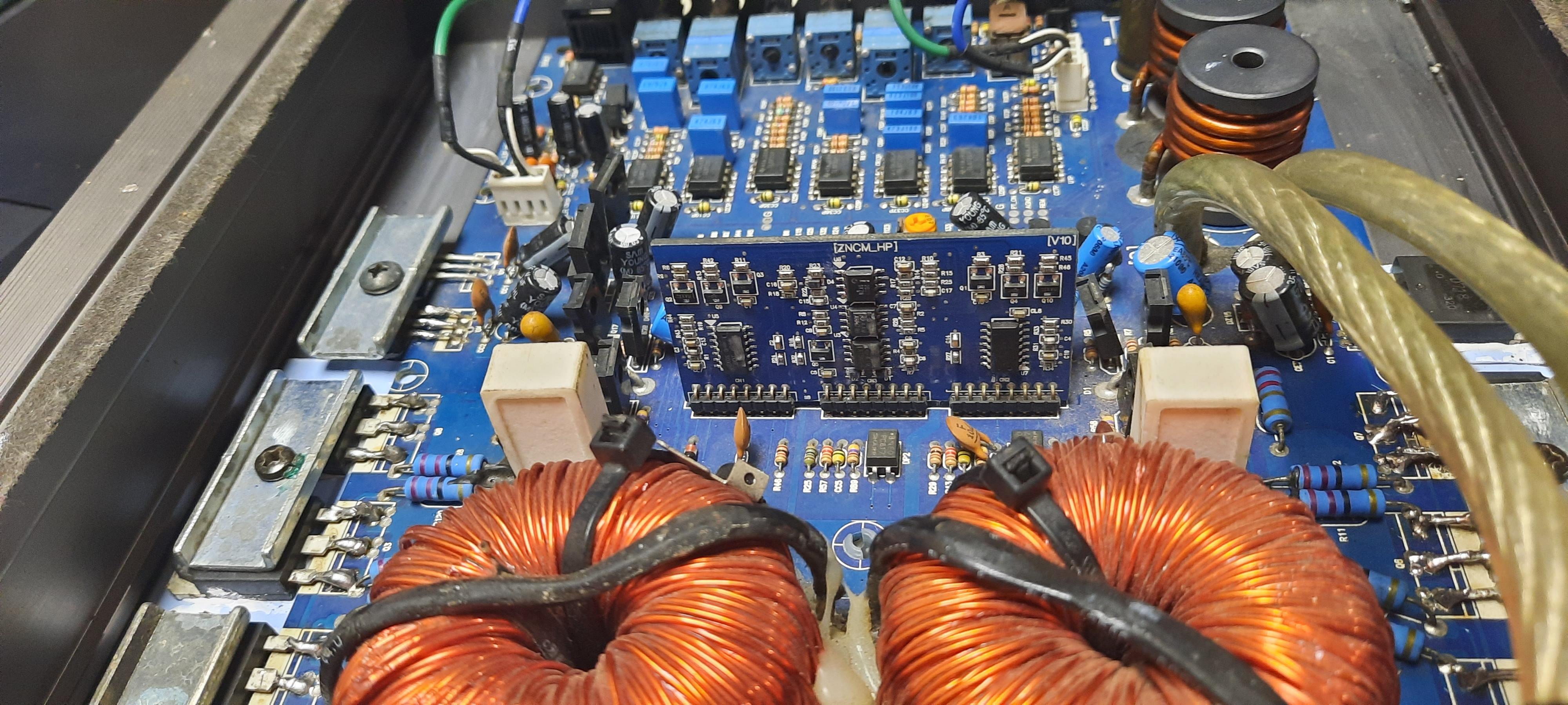

I am taking this amplifier again and I don't think the problem is the card since the amplifier is oscillating correctly, sorry for my English but the problem is that the audio does not reach pin 5 of the bd card, I found the integrated one marked in blue in the image that did not work I changed it and the audio reaches the other two operations that are in green but still does not reach pin 5 of the middle pin board
