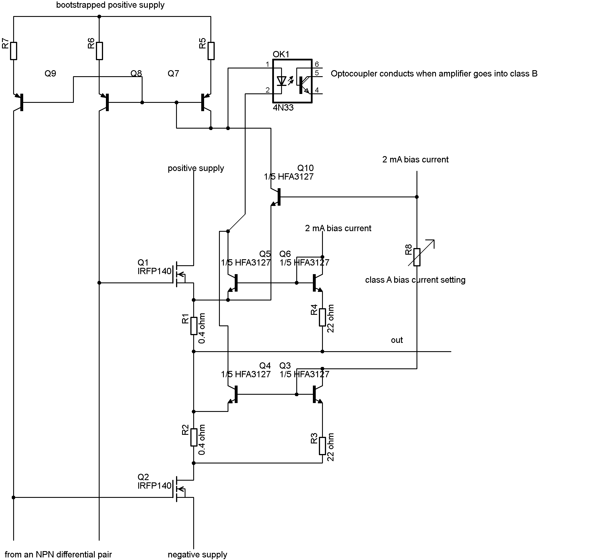

In 2012 I had an idea for a non-switching class-AB amplifier with class-AB control loop (similar to the one in Electronics World February 1996) that also has a class-A mode. With a potmeter, you could continuously vary the bias current. The amplifier would indicate by means of an LED when it goes into class AB at the output current peaks. That way you could use it in class A without wasting lots of power when you listen at low volumes.
Now five years later I still haven't built it (mainly because my old non-switching class-AB amplifier is good enough for me), so I thought I would just post the untested idea in case anyone else is interested. Attached is a simplified schematic, an explanation and the full schematic will follow later.

The schematic shows an output stage of an amplifier. The earlier stages are to provide two signal currents in anti-phase to the gates of Q1 and Q2, and to draw DC bias currents. For example, the inputs of the schematic can be connected to an NPN differential pair.
OK, first forget about Q10 and replace the LED of OK1 with a short circuit. You then basically have a class-AB control loop of the type that Johan H. Huijsing and Frans Tol invented in 1976, but with a different non-linear network.
When the current through Q1 gets too small, Q5 turns on, and via the current mirror it increases the gate drive of both Q1 and Q2. Similarly, when the current through Q2 gets too small, Q4 turns on and again both Q1 and Q2 get more gate drive. When Q1 and Q2 are at their quiescent point, Q4 and Q5 both conduct a bit. Neglecting the voltage drop that the currents through Q4 and Q5 produce across the 0.4 ohm resistors, the control law is exp(-0.4 ohm*IDQ1*q/(kT)) + exp(-0.4 ohm*IDQ2*q/(kT)) = constant, with kT/q ~= 26 mV. This is all exactly the same as in my Electronics World article from February 1996.
With Q10 added and the potmeter increased to a few hundred ohms, it is Q10 that will control the quiescent current. It senses the sum of the voltages across the 0.4 ohm resistors, changing the control law into something close to IDQ1 + IDQ2 = Vpotmeter/0.8 ohm. That is, as long as Q10 is in control, the output stage works in class A.
When the output signal current gets so large that the output stage can not stay in class A anymore, either Q4 or Q5 will kick in and will ensure that Q2 or Q1, respectively, is not switched off completely. That is, the circuit transitions into non-switching class AB. The LED of optocoupler OK1 turns on when this happens. The other side of the optocoupler drives a monostable multivibrator that drives an LED (not shown on the schematic), which indicates to the user that the circuit has gone into class AB.

Hi Marcel,
In the particular case of BJT OPS there is an unique optimum bias level. Anything over or under this optimum bias will result in high level of distortion
The classB crossover distortion is caused by variation in amplifier output impedance with load current level at crossover point.
The optimal class B biasing for minimal crossover distortion requires that R * gm =1 where R is the total ohmic resistance seen from the emitter towards the base of one output emitter follower (one output power BJT).
This resistance is : Re + re + Rs/(beta +1) where Re is the emitter resistor on which you measure Vq, re is the parasitic internal emitter resistance, Rs is the total base + source resistance. If Re is dominant, then the condition becomes gm * Re = 1 which means Io * Re = Vt = 26mV. This is the usual condition (Self) because gm = Io/Vt where Io is the bias and Vt is the thermal voltage 26 mV at room temp.
If Re is made smaller to avoid losses, then re may not be neglected in front of Re and gmR=1 becomes gm ( Re + re ) =1
This means Io Re + Io re = 26mV and you are measuring the first term.
It is then normal that at optimum IoRe should be lower than 26mV.
In other words, if you want optimum class B bias and also as much as possible Class A, you can not do it by increasing bias over 20 ...
26mV (20mV for 0302/0281 with 0.1ohm Re), voltage measured over one emitter resistor. What other option do we have if we want more A class? - to increase the number of output devices biased at optimum class B current.

That's an interesting thought! A more old-fashioned variant would be to mechanically couple the volume and bias current potentiometers. In either case, you will need to take some safety margin because you usually don't know the line levels very accurately, nor the current that your loudspeakers need at a given signal voltage level.

Well, what will happen when class A idle current will be exceeded by the requested program level and the OPS will abruptly enter in class B, which, by the way, has an idle current heavily over-biased?
Then you get slightly more distortion on occasional signal peaks, while the softer parts of the music are still processed in class A.
In any case, your whole analysis applies to a very specific topology that I'm not using, namely a bipolar complementary emitter follower stage with emitter resistors, with the stage being driven from a lowish impedance and with the way the current is distributed between the transistors set by the transistors themselves. I use a current driven MOSFET output stage with a class-AB bias loop that forces the current distribution law. To the best of my knowledge, my output stage doesn't have such a distortion minimum anyway.
Attached is the main schematic. The right-hand side wasn't scanned in properly; the rightmost diode is actually a 3V9, 400 mW zener and the upper side of the rightmost 22 nF capacitor is meant to be connected to the output relay.
