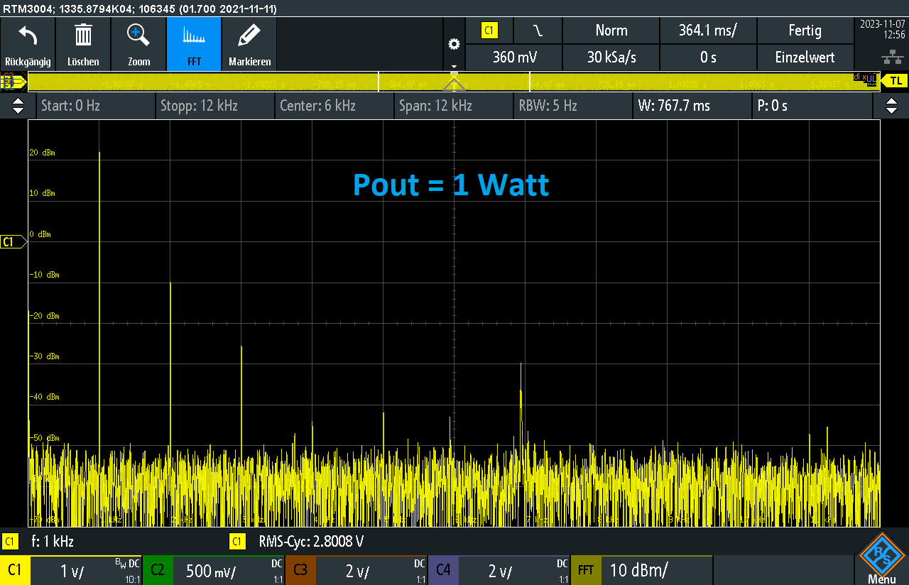

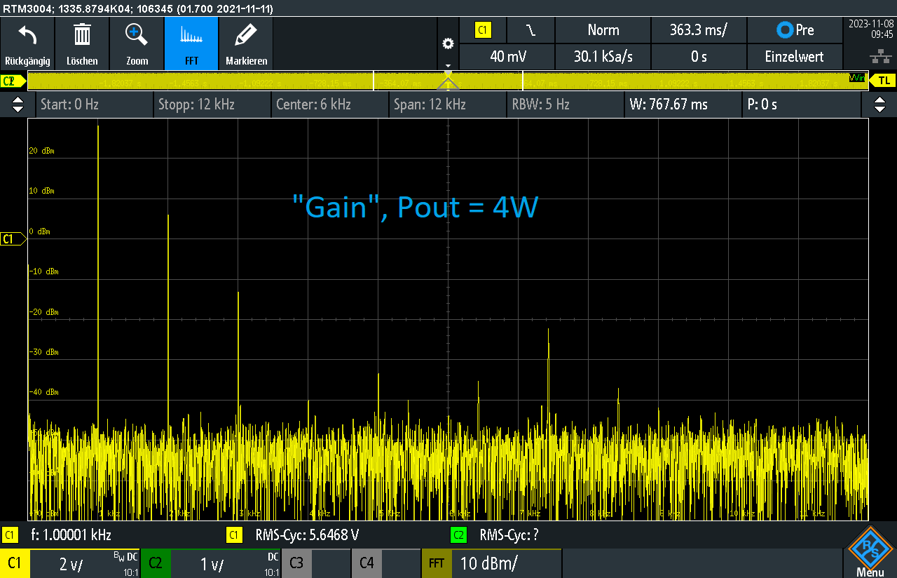

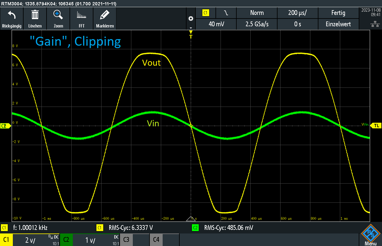

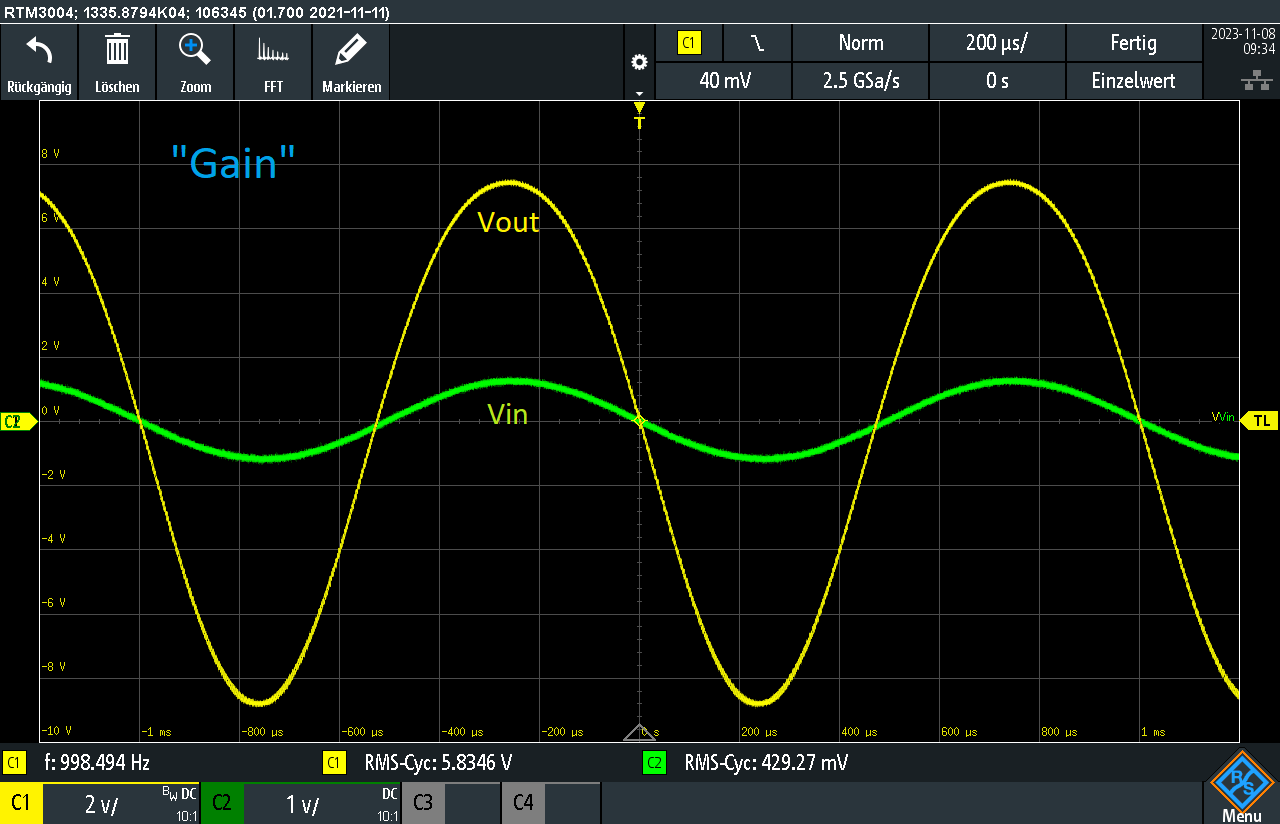

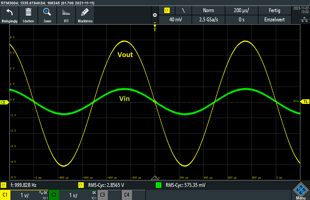

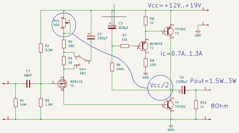

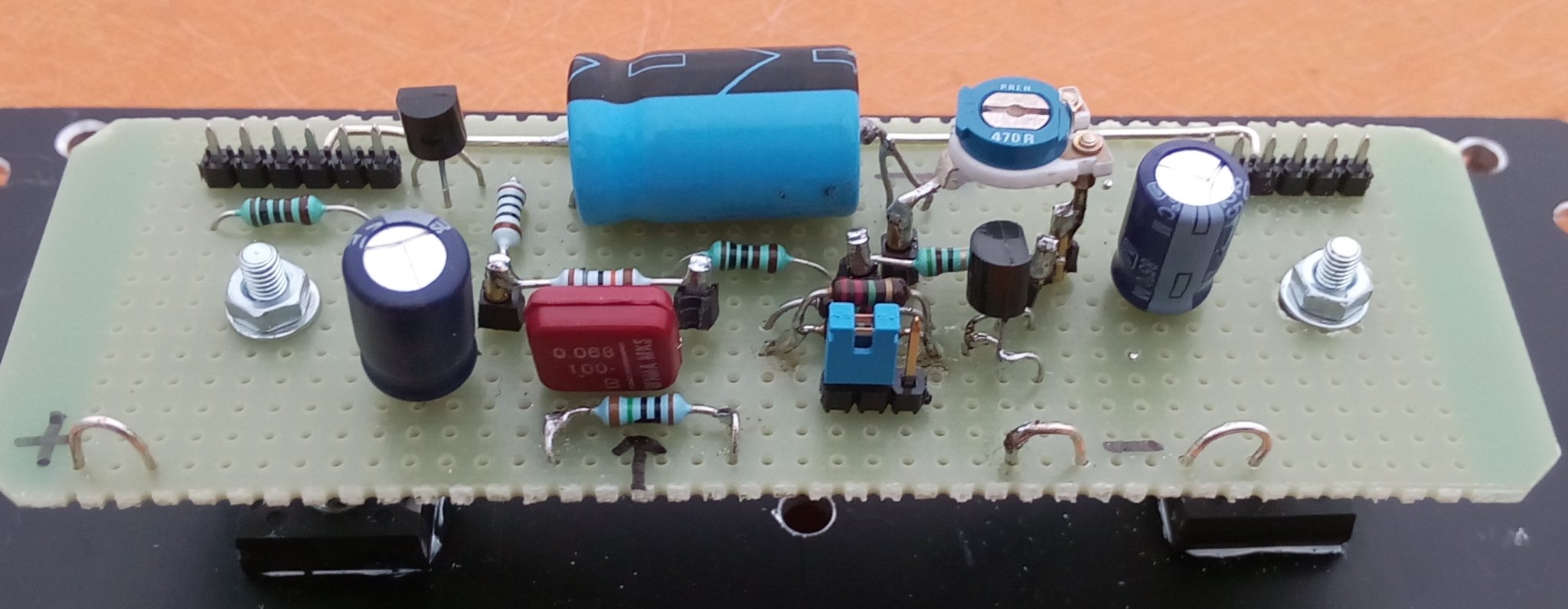

Amplifier with the current output, JFET and BJT circuit
The audio tracks look like this:
You see what you hear: Class D lacks high tones. But that's not all. I don't understand why the tops of the first waves are cut lopsided.
