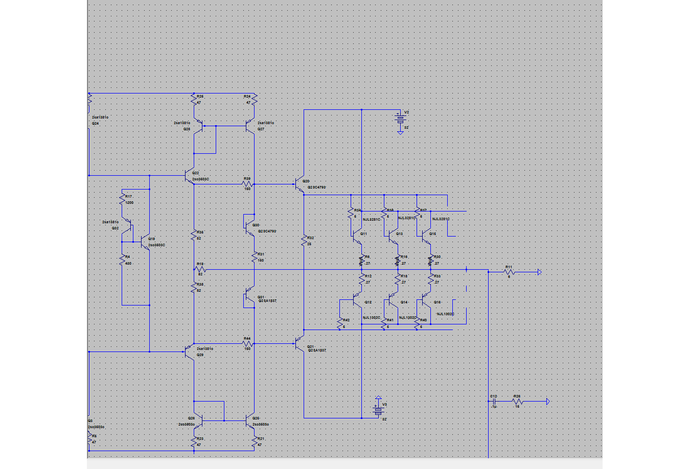

R R Dijk Member Joined 2005 2022-11-30 1:14 pm #22 2022-11-30 1:14 pm #22 Double, i thought it could be a different predriver / driver. Like a amp with gain of 1. Within the loop maybee? Maybee ending up with something like output stage with similar to error correction? Here is my attemt : Attachments Uten navn.png 15.5 KB · Views: 633
