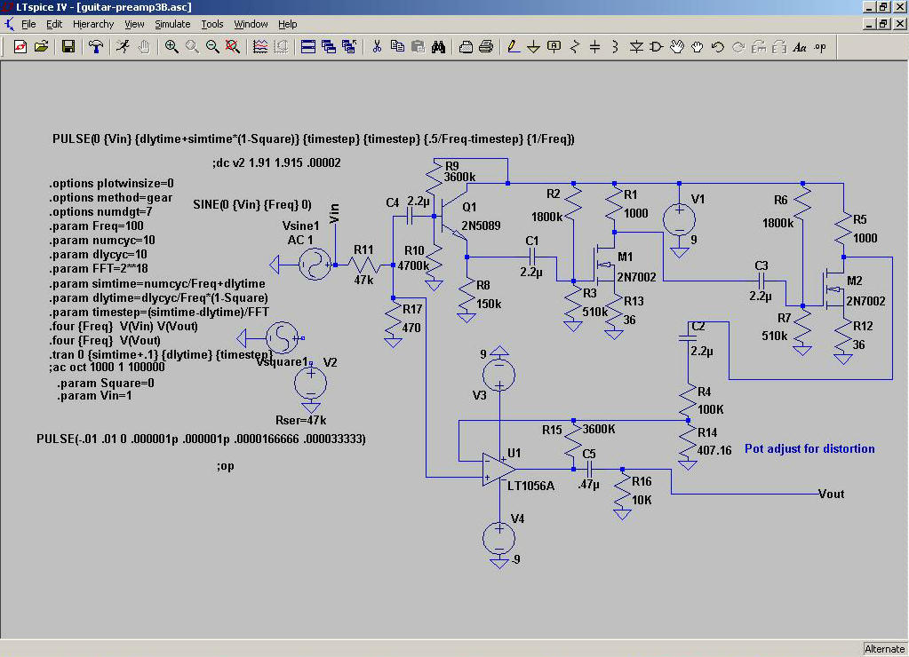

Thank you RJM1.
Can you comment a bit what your circuit does
and how and why it works.
These guys with electric guitars have done this for ages.
Also thanks to jerluwoo.
I will try your circuit.

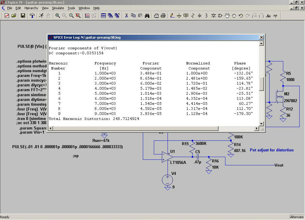

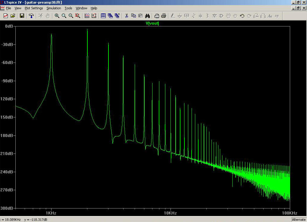

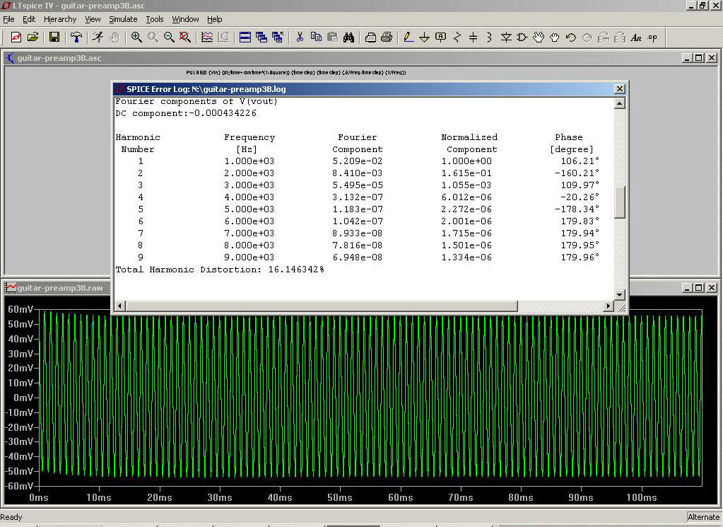

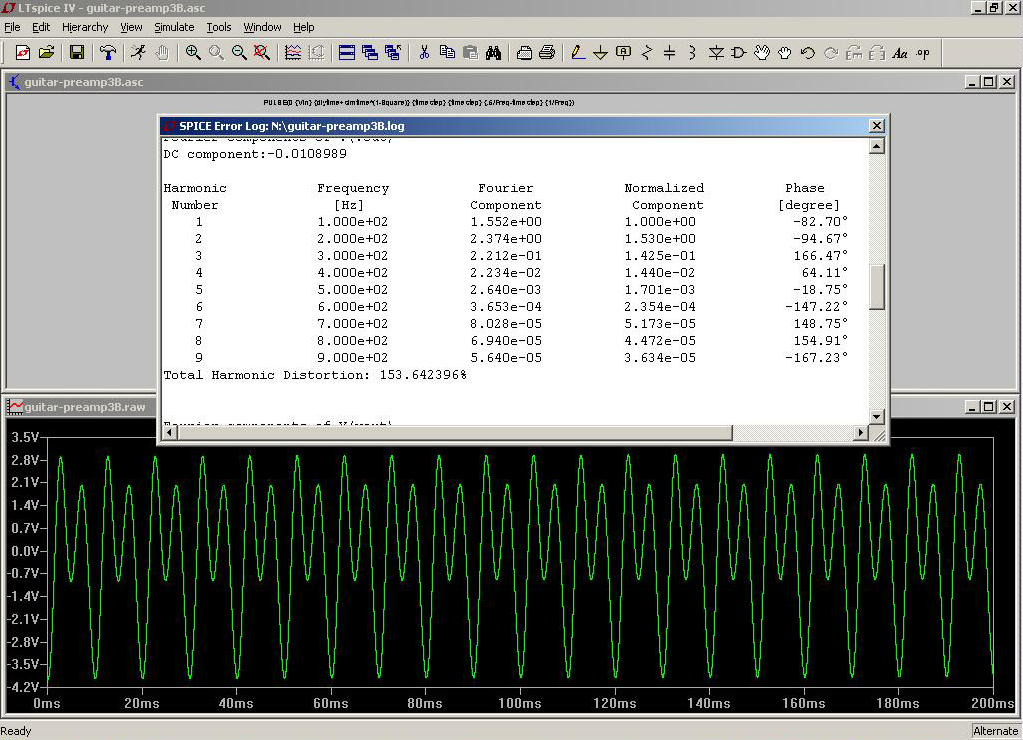

The three transistors each amplify signal and their output is 180 degrees out of phase with the input (plus some delay). this signal is added to the input signal which cancels most of the fundamental. The signal is then amplified by the op-amp to give approximately the same output level as the input with greatly increased distortion products.
(Vin -(Vin + distortion))* gain = output

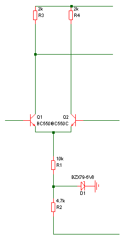

Use an input differential with a poor current source , typicaly a resistor connected to a zener voltage reference.
Yes, we can add distortion to produce a "favorable" sound. But distortion is distortion, whatever the order.
But when distortion is already adequately low, then I'll pay attention to the harmonic structure. I.e. not wanting even extremely lower THD by sacrificing harmonic structure.
The "poor" ccs as posted by wahab, will create good harmonic structure but the distortion is intolerable. But it has one merit. When the circuit has poor stability, I will check if that ccs will solve my problem.
Depend on circuit, higher bias will tend to bring not only lower distortion, but also good harmonic structure. So I always check if adding only a few hundred mA will turn the structure positively.

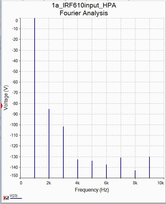

2nd harmonic is a frequency doubling.
If you DSP that in the time domain,
need not suffer 3rd or higher or IMD.
In immediate terms: A full wave
rectifier, followed by square law
distortion produces a pure 2nd.
But only if the input was a pure tone.
If a mix of tones, you get IMD also...

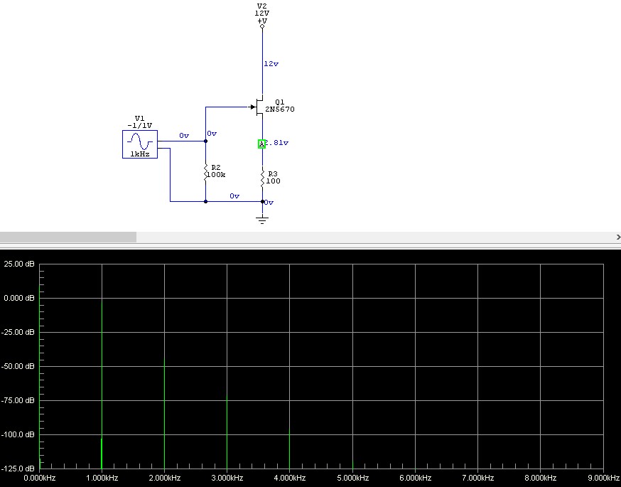

The circuit above is half a Gilbert cell, with deliberate and controlled leakage from one portA analogic multiplier (e. g. a Gilbert cell like MC1496, CA3054) fed with the right signals (amplitude and phase) will also produce second harmonic. This technique was used in sythesisers.

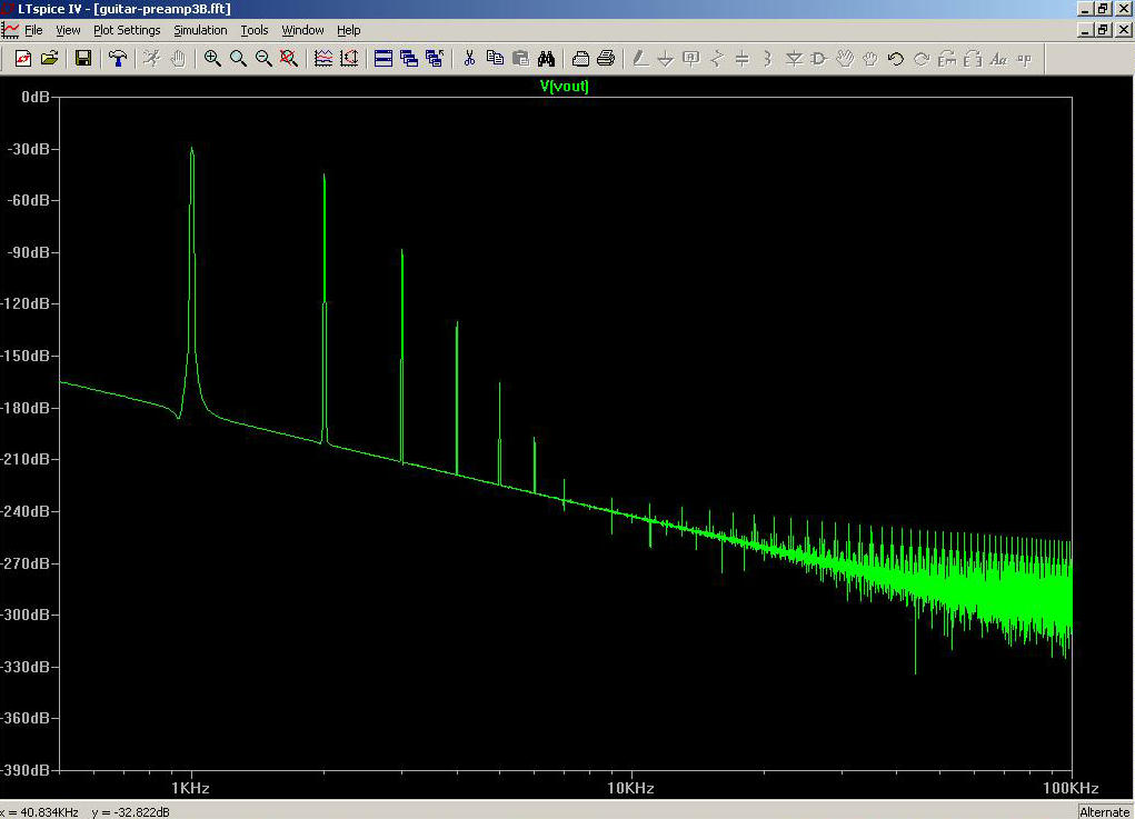

Interesting topic, i also would like to learn how, I do remember at the time I was still playing with LTSpice, I noticed that if you get a pretty good 2nd harmonic profile the harmonic distortion also increases.
