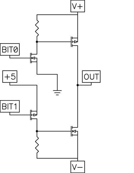

Hi all, this is not audio related but I figure the concepts are very much in the realm of everyone here and was wondering if anyone had an idea about it.
Basically, I'm trying to build a circuit that will take a high/low signal from a microcontroller and output either a +V, -V or 0V at relatively high power (approx 10A continious, 50V).
Any help is greaaaaaaaaaaaaaaaaaaaatly appreciated 😀
Cheers!
Two bits for control.
+5 on bit 0 gets you v+ out
0 on bit 1 gets you v- out
o on bit 0 and +5 on bit 1 gets you 0V out
+5 on bit 0 and 0 on bit 1 gets you excitement.
probably want some source degeneration resistance on
the input devices to limit their drive current.
