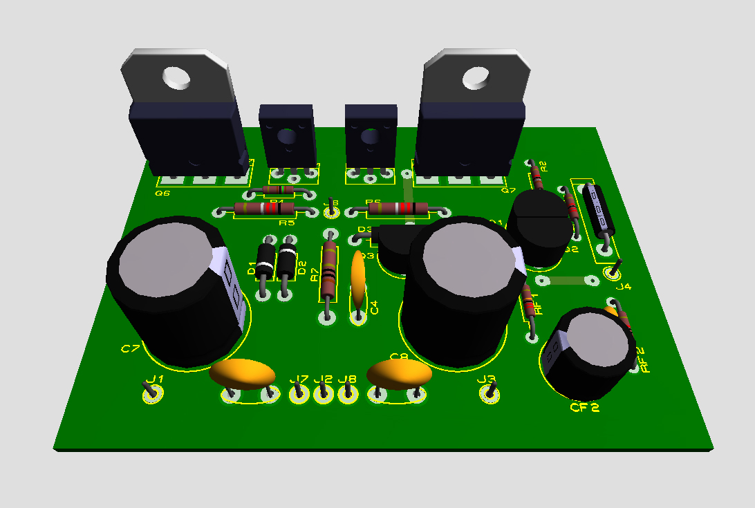

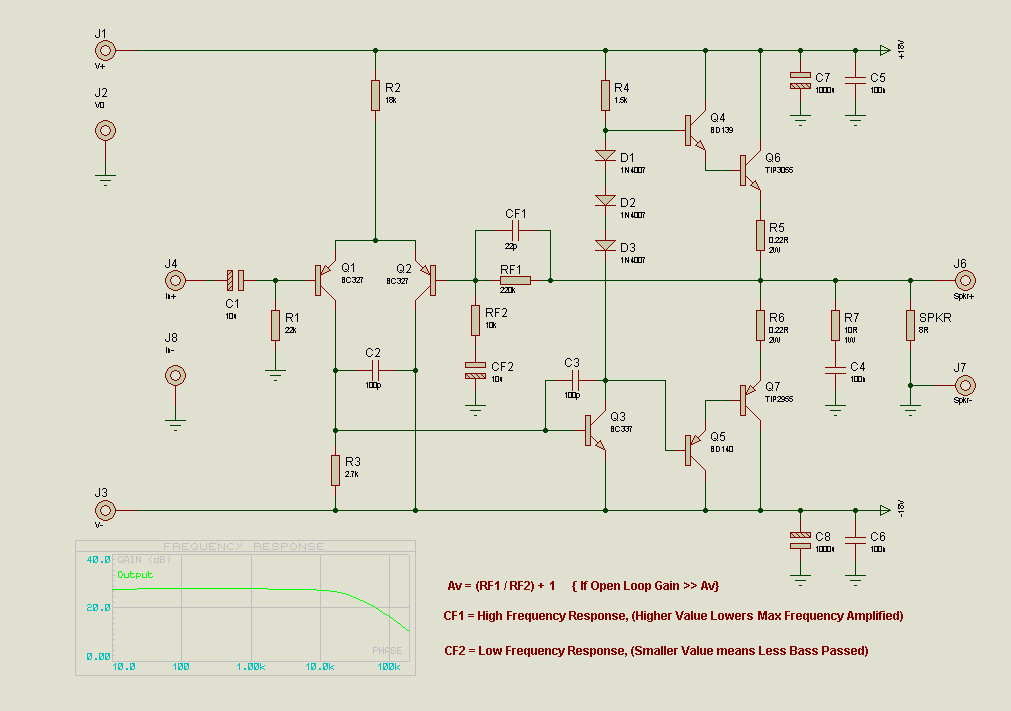

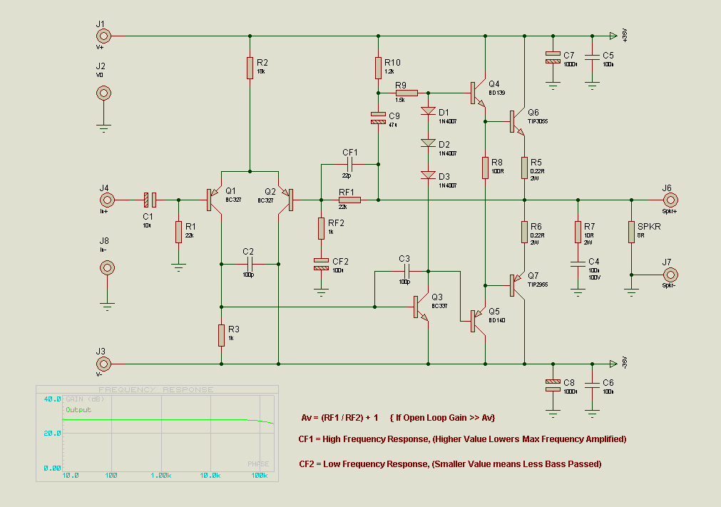

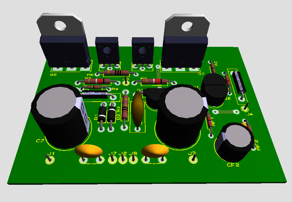

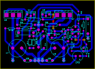

Been Busy getting coponents for my build of Studio Reference Amplifier by Apexaudio,
Ive looked at Alex mm 's PCB's and Ive taken some placement from his great ideas.
So here is my Ver1.0, one i think that will finally be my first trial build.
After building ill see how it behaves itself and make changes as needed.
Ill be using tonar transfer method so tried to keep tracks a fair distance away form each other.
Lol if it smokes, ill fall over.
