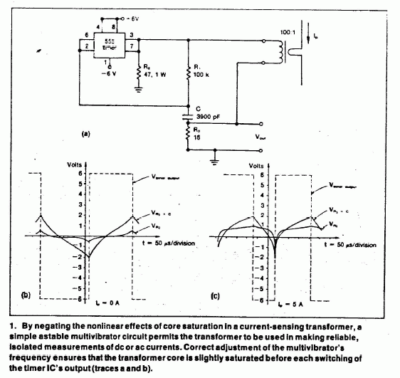

Thyristor short is a good method. Must detect overload with a method that does not affect sound quality. Switching current transformer possibly.
Goal is to protect speaker, right?
Solid State outputs hard to protect and have best sound. These parts are cheap. If one of these fail, you still need to protect the speaker.

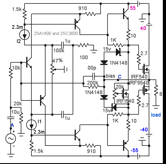

I think the bypass caps on the input transistor emitters are too small. Maybe something more like 100uf each would be better.

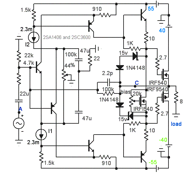

Hi Graham, You were right about the turn on surge. I guess I was wishfully thinking that the positive and negative charging currents would balance out the circuit then. I have moved the bypass capacitors to ground and added the resistor at the junction point to lower the ac gain. Thanks for your accolades.
Hi mwh-eng. Probably use an opamp as a comparator with hysteresis and place a magnetic field detector near the output path to detect the current. Amplify that signal and detect its average level to trip the comparator at a certain point.
Hi Graham, I forgot to say that those mosfets are rated for only 100v. If 200v ones are used at higher voltage, one has to watch out for power dissipation and current rating. If mosfets are paralleled, then the gate resistors should be increased to a couple hundred ohms to prevent parasitic interaction between them. But then the problem is that the frequency response and sound quality decrease.
