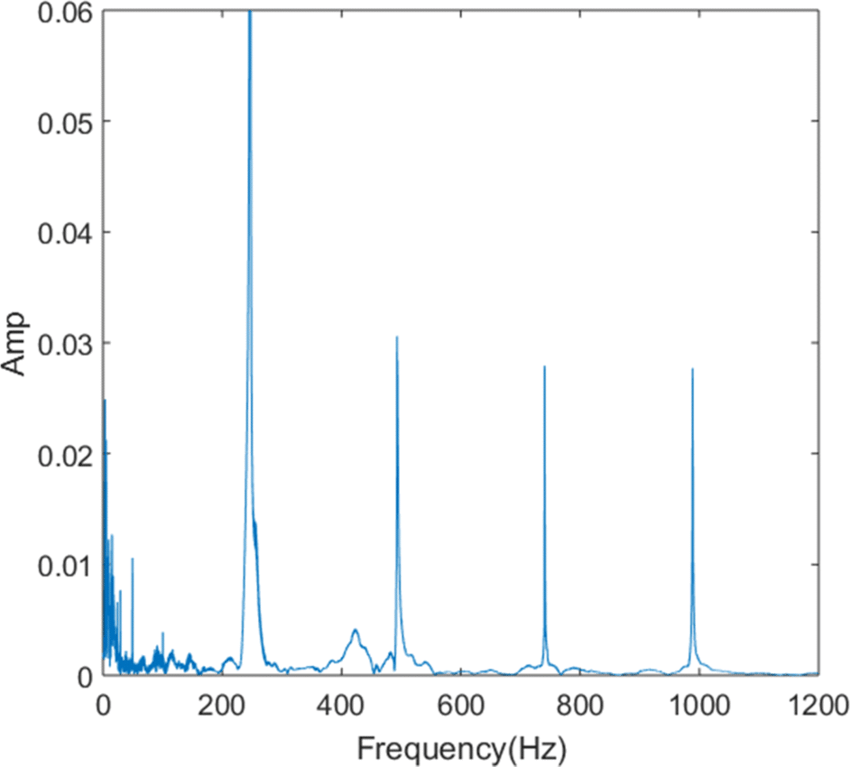

I ask and wonder because of the attached spectrum from a piano note. There is very high harmonic content already from the bare instrument. (Is the same is true of many (most?) instruments?) How could one hear a tiny addition to the already present much higher amplitude harmonics? (2nd harmonic in that image is only 30 dB down?)
Is the problem more from products which are not found in the musical scale and/or normal spectra of the instrument? Is that what sounds bad? Along with noise?

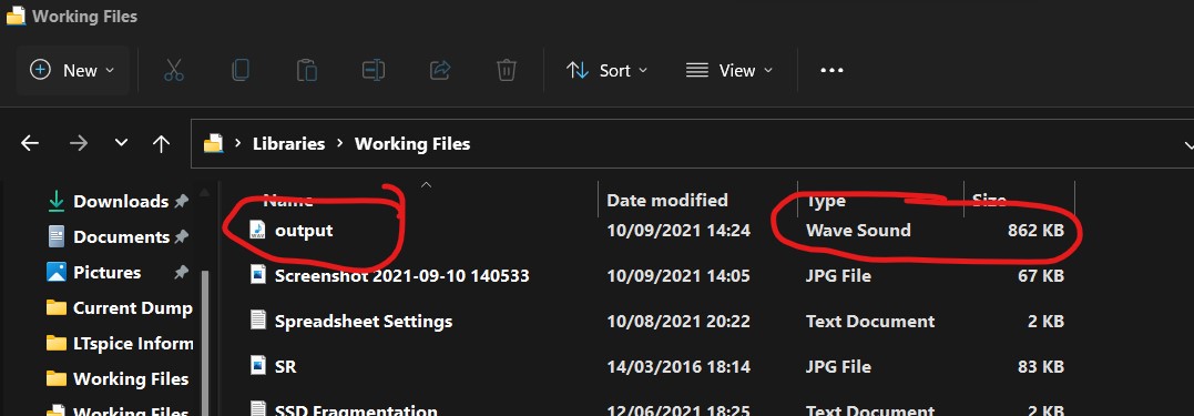

This attached file is the one I used today and it records 10 seconds of audio (because the sim runs for 10 seconds).
Look at the spice directive:
It has to be exactly as written but you can alter the file path. Working Files is just a folder in my Documents. Output.wav is what you want to call the file. It must use the .wav extension. It must be 16 44.1k (16 bit 44.1kHz) and V(Vout) is the name of the point on the simulation you want to capture the audio from. it is the voltage at point Vout on the sim.

So when I run that sim which I did a couple of minutes ago it produce this.
Getting it to work with a music file requires you to have a .wav file of the music on your PC and you have to alter the input voltage source of the sim to use that file.
Doing a stereo set up is a bit more involved because you have to duplicate the amplifier (easy in LT) and also split the .wav file into stereo and that is where Audacity comes into its own.

Very good questions. Yes, it is a natural line of thinking as to the audibility of harmonic distortion when musical instruments create a substantial "forest" of harmonics to begin with, as you say.What is a more important figure of merit? IMD? Noise measurements related to the forest of products produced?
This is, I believe, the reason why it takes so much low-order HD to be audible, while higher-order HD is more audible as they seem to be naturally generated in smaller amplitude, typically.
Noise is not a good thing either, but if you can't hear the noise from your listening position (easy to test), then it's nothing to worry about. So I think that leaves the following to ponder:
- higher-order HD products (4/5/6/7/xxx) - although very high orders may be outside the limits of hearing anyway, e.g. a 5th order HD on a 5 kHz tone is 25 kHz
