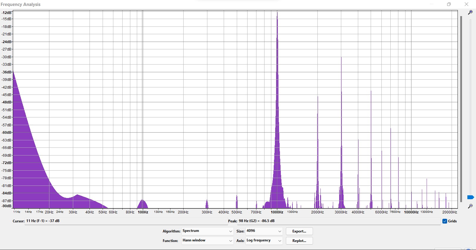

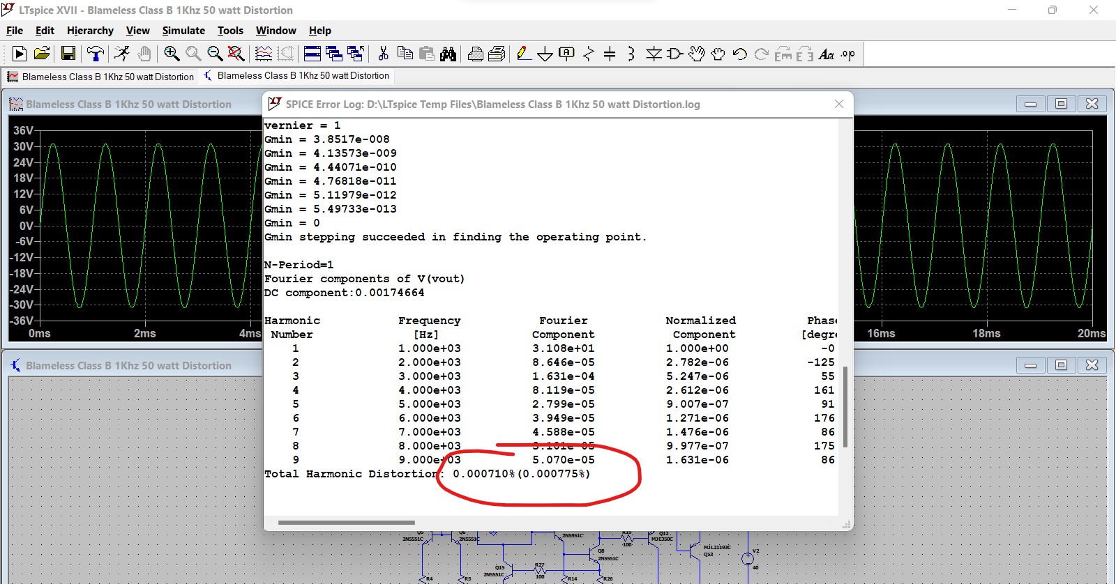

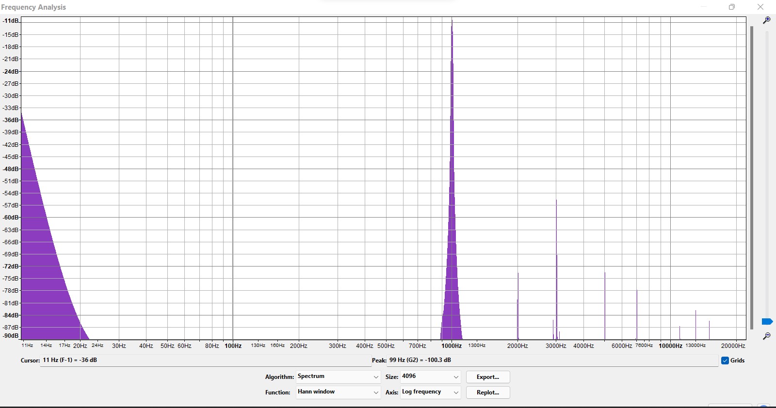

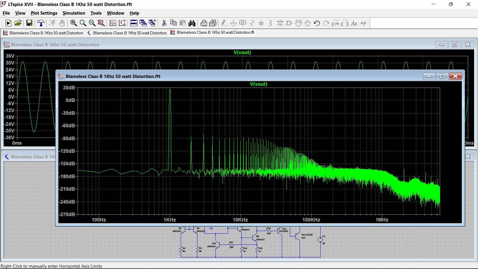

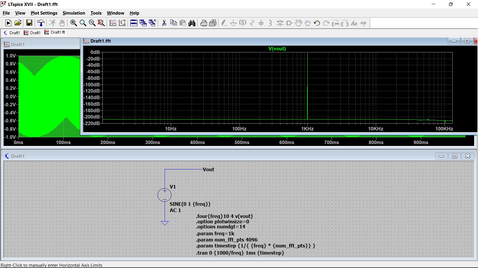

What I suspect you aren't grasping is that it is not just the raw numbers such as 0.03 vs 0.09 vs something else but also how that distortion is made up.
A pure signal source such a sine wave will have just a single frequency component to it such as in the first two images. This is just a 1k sine but the sim has been configured to show super high precision. There is just a single 'spike' at 1k showing the signal. There is nothing else. There is no distortion to this one. It is pure.
When that signal is fed to an amplifier (real or simulated) the amplifier adds its own unique mix of distortion. All amplifiers distort in some way.
This shows the output of the popular Blameless Class B amp at full output. Notice all the extra harmonics at 2kHz, 3kHz and so on. The make up (the relative amplitudes of one harmonic to another) is what can appear to give an amplifier its own unique character.
It looks bad but the raw numbers show the total distortion is very low.
An amp like your NAD has a single ended input stage and the make up of distortion would be quite different.
So the actual % level doesn't always tell us what an amp will sound like.

i take it then, in the 3rd simulation shown on here, and the term harmonic distortion is not nessesarily what is, or at all heard directly but that of what is generated in the components etc that eventualy could/can be heard as some kind of actual audible distortion.
Any additional frequency component the amplifier generates from the pure input signal is called harmonic distortion. So if you apply 1kHz and the amplifier generates an output at 3kHz then it is producing 3rd harmonic distortion.

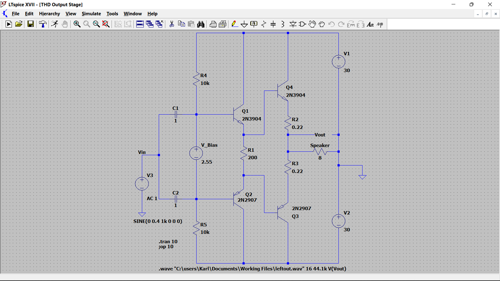

You might like this 🙂 You can record the output of simulations, not just simple ones like here but also simulations of complete stereo amps playing music.
So this is the classic output stage with normal, low and then no bias. Each MP3 file plays for 10 seconds and each should sound very different. The levels have been normalised to be the same.
(had to put those in a zipped folder, the option to add MP3 to the forum has disappeared 🙁)
Each image shows the audio file looked at in Audacity (free program) and shows the spectrum of harmonics. Ignore all the very low frequency stuff which is an artefact of the laptop sound card.

that wasnt done in spice though was it? you can very MUCH hear the difference
the third one, sounds quite dull in comparison to the first,which is too bright and has a sharpness to its edges, almost grating
