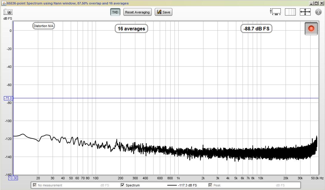

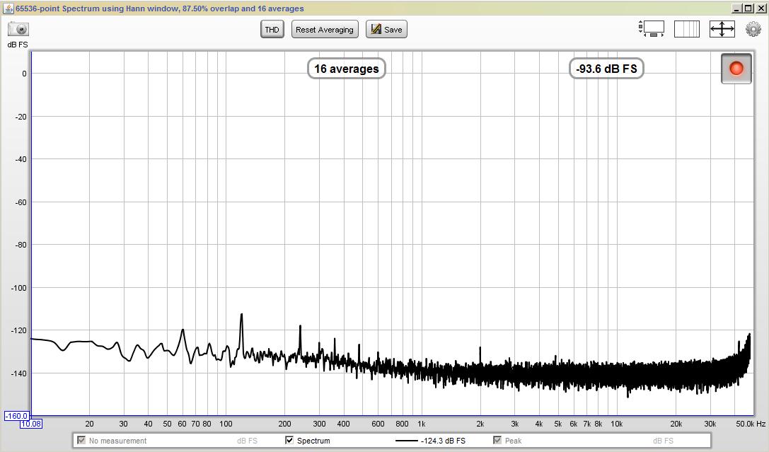

OK, I did a little more playing around and have some new results to show. I think it is related to what Andrew is saying above in some ways.
Andrew: I might already be doing what you say with the MAG. The amp board had an onboard PS originally consisting of a bridge rectifier and two smallish smoothing caps. I removed these. The new outboard PS rails are connected via wires leading to the pcb where the smoothing caps leads were located. I run a single ground wire from the buss bar to the ground on the pcb, and this might be what you are hinting at when you say to "Move the MAG away from the PSU Zero Volts.". The amp pcb has a single ground for both power and line level, not well laid out. This is the reason why I return the speaker grounds directly to the PS - to keep the current out of the amp pcb ground.
So, I remeasured the system this morning, and the result is shown in attachment 1 "IN MORNING amplifier on but no input signal". The PS noise and harmonics are still present.
Next I inserted a 1R resistor into the pcb ground wire (connecting the MAG and the zero volt line). This resulted in a significant reduction in the PS noise and harmonics. This is shown in the second attachment, "IN MORNING amplifier on but no input signal - 1R on amp PCB ground". I inserted the resistor at the pcb end of the wire. My thinking was that noise was being induced (the amp is just out in the open) from the PS or nearby equipment. Not sure if that is the case or not, but the result is much improved for sure.
Note that these spectra were taken with the amp on, but not really doing anything (no input). When I drove the amp to full power, it was interesting to see the ripple peak (120 Hz) increase more than 10dB. This probably means I should increase add caps and/or use a transformer with a higher VA rating. The current trafo is only 80VA rated, and the rails drop from about +/-32V to +/-26.5V at the onset of clipping. I measure about 16VAC,RMS at the speaker outputs, which translates to about 32W of power and 22.5VAC,peak voltage. So it looks like the amp can operate up to within about 4V of the rails. If I can keep the rails from sagging, I should be able to get more power out of the amp. I would guess that this is mostly due to the undersized transformer, and I think I have a larger one around I can try (it has a similar secondary voltage).
Am I on the right track here? Any other suggestions?
-Charlie
-Charlie

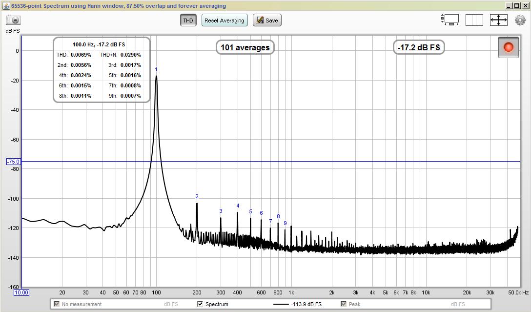

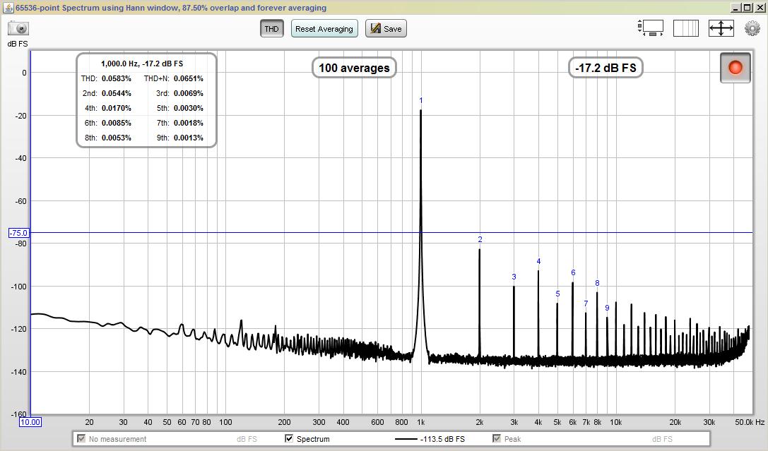

Your two pics show on the left the typical 3rd and 5th and other odd harmonics. These are usually the difficult one to get really low. Your right pic shows them much lower. I think this indicates that your resistor is altering the electrical influence rather than a loop radiation influence.
If you could get the 60Hz down then you would be much better.

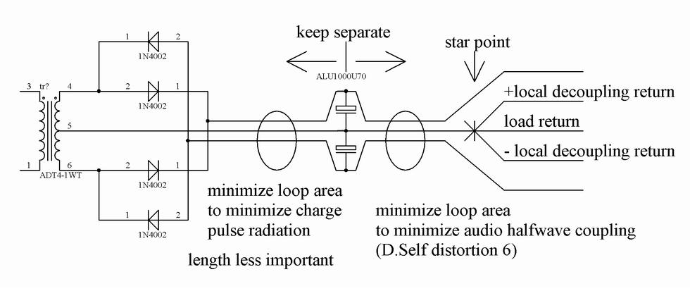

Andrew,
I think I finally might have a clue about what you are referring to above. See attachment. It's from a very long thread back in 2006 to 2007 (in which you posted often). Someone contributed the schematic. Here is the link to the thread:
http://www.diyaudio.com/forums/solid-state/90728-bob-cordell-interview-power-supplies.html
So is this what you had in mind?
-Charlie

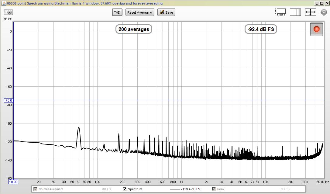

Yet another update... I have been trying to eliminate this "hash" type of distortion that I have been seeing with a chip amp (STK4191V, 50W+50W). There would not be anything visible in the spectrum when the amp was on, but with no input signal - in this case the spectrum was mainly noise. When a single frequency tone was input and the amp was operating at a power level above 10mW the hash would show up.
I scratched my head about what could be causing this for a long time. Was it noise pickup? Was it the transformer? I eventually decided that it must be the harmonics of the sawtooth ripple and noise from the diode bridge. I had tried a C-R-C type capacitor connection previously but had some problems, but I decided to give it a go after trying many other ideas and coming up with no solution.
Sure enough, the C-R-C configuration dramatically reduced the hash and noise. I am using this arrangement:
I tried some of AndrewT's suggestions about making a star for the speaker returns "away from the zero volt line of the PS" but this did not improve the situation. Perhaps that would address some other problem that I do not have in my system... not sure.
Reading that old thread from 2006-2007 gave me lots of ideas to try, but this was the only successful one. I've attached some more spectra using the C-R-C arrangement.
-Charlie

Post25 shows it well.
Twisted triplet from rectifier to smoothing caps.
Twisted triplet from smoothing caps to Main Audio Ground (MAG).
Not shown as clearly:
twisted pair from mains to transformer.
twisted pair from transformer to to rectifier. If the route transformer to rectifier is long, then the centre tap must also be incorporated into the pair to make a twisted triplet. But the Centre Tap does not stop there it simply passes on through to become the third wire in the rectifier output.
Similarly the speaker return must be the other half of the twisted pair from speaker terminals back to PCB. The Speaker Return does not connect to the PCB. It passes along the output trace route until it meets up with the Power +ve & -ve and then becomes the twisted triplet that came in from the PSU.
ESP shows a Bus Plate for the PSU Zero Volts. I cannot recommend this.
I always locate the MAG OFF the bus plate. I never locate the MAG on the PSU Zero Volts.
Finally. The ESP layout shows neutral following Live. EXCEPT where Live goes to fuse and back. The Neutral could follow as a pair to the fuse and back. But just as good and using less cable the Neutral follows the live until the LIve goes off on itlonely route to the fuse. Here is the trick. The return route from the fuse is twisted with the flow route to the fuse. This twisted pair goes back and is then replaced with the neutral again. In all cases there is a flow and retrun pair for all the mains wiring. from the IEC to the Transformer. Be as scrupulous with ALL signals/currents. Always use twisted pairs for cancellation of radiated fields.
post28:
shows massive improvements.
The no signal condition loses all the mains & harmonics in the noise. I think that peak that hits the -120dB is 180Hz. The third always seems to be the most difficult to remove.
The middle plot shows only low levels of 60, 120 & 180Hz just above the noise.
The left does not help me work out what is happening.
Is there any way to get the noise floor down?
It would help with tying to understand what is happening when the signal and no signal plots are compared.
I wonder if the grass you are seeing when signal passes, is signal correlated noise due to capacitance and inductive coupling brought about by poor trace routing?
Am I correct in assuming that your CRC and moving the MAG off the PSU has brought these improvements, or is there more to it that I have missed/forgotten in preceding posts?

Andrew,
-Charlie
this is all you will ever need........read up on the leach super amp plans.........what i did with my super leach amp is to use a 4mm bolt as single point ground to the chassis....my power amp is dead quiet even with the volume control turned all the way up....
this is the sequence for bolting:
1. power transformer center-tap lead
2. main filter cap ground return leads
3. speaker ground return leads
4. pcb ground return leads
5. input jacks ground return leads, do not ground the input jacks to chassis, use a 4.7~10ohm isolators to earth the jacks locally...
