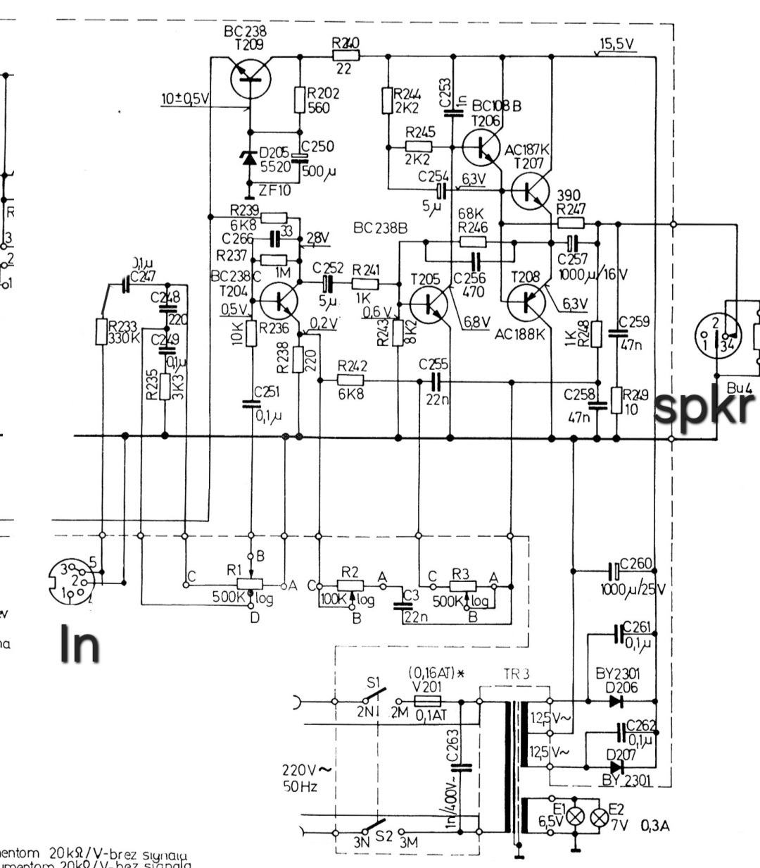

I will be modernizing old Yugoslavian radio called Iskra Savica SN120.
In the process I will remove all electronics and I need a suitable amplifier.

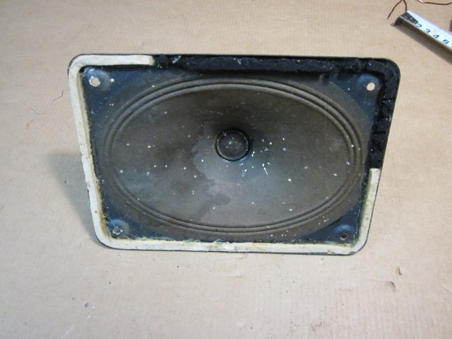

It has oval (10x15cm paper membrane) full range speaker -full range with high sensitivity.
Enclosure is not completly sealed, it has backplate with many holes, like radios did have back in the day.

Here is the schematic of original amplifier and I'm thinking of building the same one, except for better power supply:
What do you think of it? Is this class A?
Do you see any room for improvements?
Edit: I had just realised that AC187K and AC188K output transistors are germanium... can I substitite them for something newer? Also should I substitute other transistors with something newer?
I know that this amp goes nice with the speaker, would you recommend different amp anyway?
This is not the exact speaker, but it's similar enough.

You may be able to get a similar sound with a simple more conventional amplifier IF the tone control network in the feedback is connected in the same way. And if the amp is stable at any setting of the controls.
it’s kind of an interesting circuit - boot strapping both T205 and T206’s loads. And using a fully class B Ge pair driven by a class A emitter follower. All this is done to get the absolute maximum out of such a low supply rail. Just subbing silicon for the output pair will give horrible crossover distortion, but one could use a properly biased push pull pair and make it work. It will lose a little output swing, but just raising the supply to 20V would fix that, and a 3 or 4 amp TO-126 pair (BD43x or 44x) is as big as needed. With a pair of bias diodes between the bases, using a paralleled resistor to trim for 5 to 10 mA of bias current in the output pair. Small emitter resistors are probably a good idea too. The whole front end driving it could be left as is.

Keep the original germanium amplifier: it is perfectly matched to the set.
Otherwise, if you really want to switch to Si, opt for something like TDA2611 or TCA760

Assuming the Ge pair is still any good. If not one may be SOL without a switch to SI. I know I can’t get NPNs. Most of the time chip amps just don’t sound right in these applications. They usually aren’t happy about tone controls in the feedback and just don‘t sound right flat when the tone controls have been voiced into the overall design. Would that “vintage amplifier with a new twist” of yours be stable using tone controls in the feedback? If so it would be a GOOD starting point, better than a precarious diode bias circuit.
It's all a matter of personal choice, but for me I wouldn't want a chipamp in there. if there's concern about stability over the feedback tone control, you could use an active one. There lots of choice of low power amplifier circuits out there.
A replacement amp would require the same gain, about 68, and be inverter as that s mandatory
to have the tone control working correctly, otherwise with a non inverting amp it would just set the oscillation frequency.
Best it to let it as it is, an AD161/162 pair would fit even better than the original AC187K/188K but they are in TO66 package.

T204 is also inside the feedback, making the whole thing noninverting. Its capacitively coupled, but part of the overall “amplifier”.

Based on what you wrote, I would like to stick with this amplifier design, just change germanium transistors.
I think that transistors itself are bad, my attept to fully fix this radio was unsuccesful, I replaced all capacitors and also some other components and there is a problem with sound. Imagine listening to speaker with bad connection to the coil, it goes like "brr brr brr" to the bass, now imagine there is another speaker connected that plays ok... this is what it sounds like. Signal that comes to the output transistors is clean, so thats the reason for my believe.
I would modify what needs to be modified... is there anyway one could change the schematic... I don˙t have enough knowledge on transistor amplifiers to do it myself. I am usually building chip amps with schematics ready to go. If it`s not too much work, I would appreciate it.

From what I understand a part of current amplifier is class A and other part is class B... is this correct?
What do you think would be the closest match, class A, class B or class AB?
I intended to use class A, but I would prefer something that can be driven with a (if possible single rail) 12v supply and would not require as big of heatsink.
I probably misunderstand you, but this looks like the loudspeaker isn't properly centred. There are tricks to solve that.

If you very efficiently used all 12 volts, you could get to 3W. Requires 10v p-p, so it’s all that could be expected. I’d start with 18 to 20 giving it room to sag 10-15%. And you’d still want an amplifier circuit that can get very close to the rails. +/-12V would give you room to get sloppy or press the “easy” button.
One does not especially need a +/-supply - you could start out with an 8-0-8 transformer and put the ground on the far negative side, and have both +10 and +20-ish volts (after rectifier and losses).
What kind of amplifier circuit to use depends mostly on one thing - how badly you want to keep the tone control network in the feedback loop. Not everything is going to be happy about doing that. I wouldn’t bet on chip amplifiers (even TDA2003, which is about as close a rail-to-rail chip amp as you can get) to do it without at least some grief. One could wrap it around a unity gain stable op amp (ie, LF351) and do it ahead of a “flat” amplifier. Even a TDA2003. If I wanted to keep the tone controls in the feedback loop of the power stage I’d rework the original topology. It’s not “bad”, but silicon is harder to do right than germanium here. Another method would be to put emitter followers in the feedback loop of a unity gain stable op amp, and then wrap the tone controls around it. The minus input of the op amp is the emitter of T204 - keep all ratios the same. But then that necessitates the higher voltage supply because the circuit is inefficient (does not swing very close to the rails). One can make a rail to rail amp with an LF351 in the front end and still be unity gain stable, but that design exercise is NOT for beginners. There is much potential for magic smoke.
