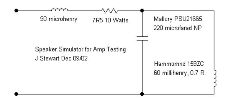

The instability on a real load is a property of NFB amplifiers using a pentode OP section. If the amp has been setup on a test resistance to be the 20 db that most build for, there will be a lot more that 20 db at any of the resonances of a real load. 20 db can easily become 30-40 db & instability is a sure thing. A penode is a current device so the voltage at the load simply follows the impedance curve of the load. The full loop NFB does not control the gain of the output tubes, it controls the stage it is attached to.
OTOH, the gain of a triode OP section in limited by the mu of the tube such that gain increases only about 2 db at the load resonances. Do the Math!😀
jhstewart, it is typically the resonances occurring outside the normal mid-range +20dB loopgain band, when forward gain of the amp has dropped by 20dB or more, and where output transformer related resonances are the cause of instability with peaking responses that can often be greater than 2dB with triode output stages. Even the venerable Williamson amp showed +6dB.
The load resonances are mostly in the audio band, they are a result of the loudspeaker itself. But any problem that might be in the load outside the OPT band limits could cause even more problems.
Unported speakers usually have one resonance, typically 50-200 Hz, depends on size, magnetic circuit, cone mass & so on. Bass reflex have two resonances in the same freq range, some self damped better than others. The impedance of most speakers rises from some mid-audio band freq out to 20 KHz & beyond. The addition of a X-over network & mid & High freq loudspeakers complicates all.🙂
I don't think any mid-band resonances will cause an instability issue, and only cause level variations, similar to tone control, speaker, or room level variations. Certainly, if the level varied close to the zero crossing loop gain frequency region, and modified the gain or phase margin, then a stability issue may arise.
Pentode approximate gain is usually taken as Gm*Rl. However a more accurate approximation is Gm*Zl, that takes into consideration of a complex load such as a loudspeaker. So if the loudspeaker impedance increases 3-4 times at resonance, the pentode stage gain will increase by a like amount.
NFB taken to the front end of the amplifier will reduce the gain of the stage it is applied to. The gain of the output stage doesn't change at all, it will still be high.
The NFB required to get the amplifier back to normal increases by whatever the pentode stage gain increase is.
So NFB that may have been set to 20 db now is perhaps 30-40 db. The problem is in the amplifier whether a signal is at one of those resonent frequencies or not.🙂
Triode output stages are affected far less. Their gain can only increase by an amount limited by mu.

That's fine, but it may not cause unstable oscillation, or gross ringing, unless there is interaction with the loop-gain zero crossover region. For example, zero cross over could be 3Hz, and mid-band gain could be -3dB at 30Hz. For sure, if an amp has a high zero crossing at 30Hz, then that may cause instability.
NFB will only fully restore mid-band frequencies, as the level of NFB drops outside that band due to the forward gain dropping (from CR coupling time-constants and output transformer inductance).

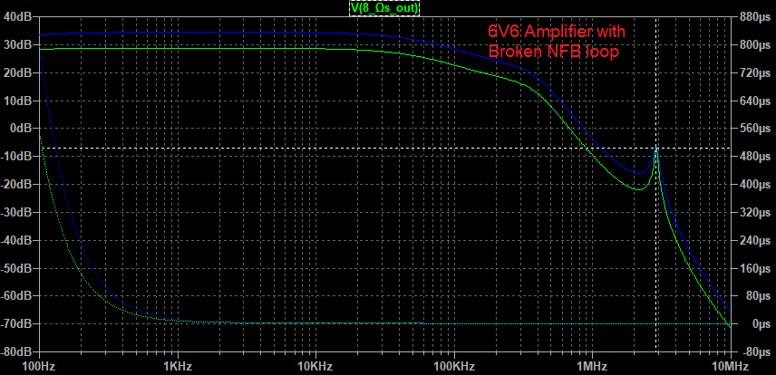

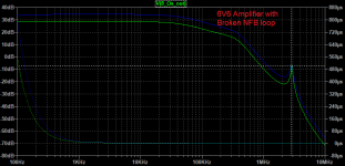

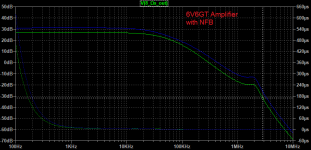

I have been attempting to stability test a small amplifier I have been testing (a small 6V6/6P6S SET) and reading this thread, and the "too much local feedback" thread, has left me feeling, that I may be on similar ground regarding
perhaps achieving only conditional stability, FB local and global, OPT resonances all having their impact on stability/transient behaviour.
(I have had an issue with multiple OPT resonances, out of band, which were constrained nicely in the absence of gNFB by limiting feedback bandwidth simply, with a capacitance (or RC) in parallel to the feedback resistor - but when global FB was added the resonances resulted in excessive gain peaking, with more power delivered to the load above the range of audibility. Mitigation measures treated the symptom and not the cause, I.e. secondary winding RC and feedback RC network, lessened the problem; but the secondary winding RC just burned up the extra power - the valves still felt the strain.)
It's been a learning experience, for sure, and this thread has helped a lot!

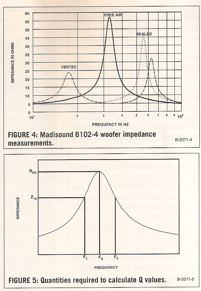

In the chapter on amplifier testing, Crowhurst suggests measuring the amplifier output impedance with respect to frequency to gauge stability. I use this method (called non-invasive stability measurement) for measuring voltage regulator stability.
You can plot Z with respect to frequency and measure "Q" (or if you have a fancy network analyzer, calculate "Q" from group delay). Without getting into the math, if Q is 1.1 or less, phase margin is 45 degrees or greater.
