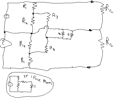

theChris said:btw, thy, do you think this would work?
(see included circut)
i would guess you could use bipolars driving the LEDs instead of just LEDs. it should compare ground to V1/k - V2/k.
this also reduces the need for high voltage ratings, right?
Referencing your pic, short both R2's, delete both R3's
and you have my input stage which swings +5v or -5v
on a 10v differential. Your extra stages swings +2.5v and -2.5v
which works too. All you need to do is convert those voltage
swings to +12v out (no fault detected) to ground output
when a fault is detected. This circuit needs to drive
the controller board which needs a ground input to trigger
and +12v pull ups.
protection circuit #1 ---> controller input #1
protection circuit #2 ---> controller input #2
protection circuit #3 ---> controller input #3
protection circuit #4 ---> controller input #4
etc.
I'm trying to figure out each protection circuit
independently, then feed each protection module
into the main controller board which drives the
speaker relay. It's easier for me to debug and test
independent circuits plus have the option to enable
or disable certain protections depending on
what you are doing with the amplifier.
I'm not doing anything new, I just want to break it
down into modules.

and the circuit responded.
But, I didn't use the 3.3v zeners,
instead I inserted a short where
the zeners would be. The circuit
triggered when rail voltage
differential exceeded 2 volts
(somewhere between 2v-3v actually).
Zener testing and real amplifier tests
will be soon.
Circuitmaker is a pretty cool
tool.
