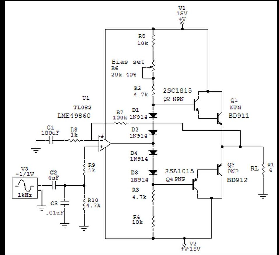

If the OP didn't want to mess with chipamp's or can't find one, a simple current boosted opamp can be made out of most anything one might have laying around in their junk box, here is one I cobbled up one day,
https://www.diyaudio.com/community/...-supply-what-could-happen.244818/post-3693072
https://www.diyaudio.com/community/...-supply-what-could-happen.244818/post-3695968
Cheers!!
jer 🙂
If logic level FETs or BJTs are oriented as common source/ common emitter, the output could be driven rail to rail. I'm not sure what would be easier to bias though.
Perhaps a current-sensing NTC thermistor can be placed in the output stage path, and used as +ve or -ve for a bias voltage divider? So if the thermistor gets hot, the bias voltage gets wider, reducing output current. (Common source polarity only.)
