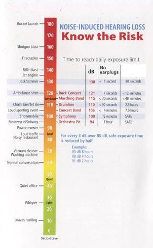

Generally, there's no need to make any precise calculations.
For an average size room, and normal efficiency speakers, about 15W should be enough for normal listening levels. The rest is additional headroom, which is a good thing and you can't really have too much, tradeoffs such as increased noise (due to higher gain), expense, power consumption and physical size aside.
If you do want to figure it out; take the efficiency of the speaker at 1W/1m and adjust based on the sound level you want to achieve at a certain distance.
Sound pressure level will increase 3dB for each time you double the power, and decrease 6dB for each time you double the distance.
So to achieve the specified SPL at 1m from a 2m distance requires 4x as much power from the amplifier.
A stereo system has 2 x speakers. This also increases output by 3dB as it is effectively doubling the input power, so you can take that into account or treat as one speaker with twice the input power.
The size of the room shouldn't make a *huge* difference in the calculation aside from how far the listener will be from the speakers. In reality it will affect frequency response the effective speaker efficiency, someone might be able to provide formulas or a table to help with that.
I've attached a chart to give a reference for how loud things are in dB SPL. As you can see, over 100dB you're getting into discomfort and hearing loss territory, but a rock concert might be as loud as 120dB so if that's what you're looking for you're going to need either a lot of power, or very efficient speakers.View attachment 895014

I've measured the sound using mobile app, as far as I can consider it accurate, the normal sound levels for me are 70-75DB and if I want really loud 80-85 so that's more than enough.
So I guess I shouldn't put that much attention when, for example, speakers say 100W RMS, it should for as fine with 50 just not as loud? Or there are other things to consider that I'm not aware at?
