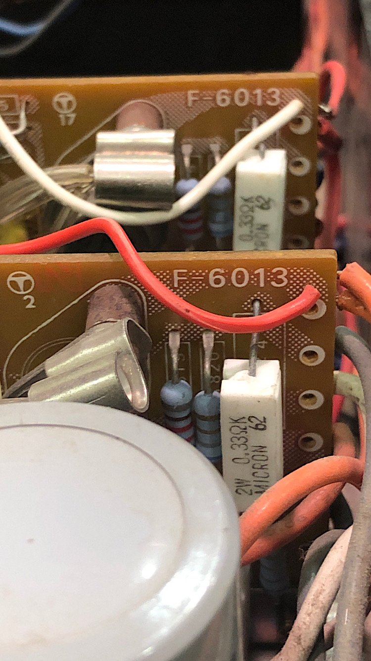

If this 5000A had the F1040 driver boards in it, they MUST be replaced with the F6013 boards.
This is an important Sansui Service Bulletin, and a proper way to go about repairing those early 5000A units, and any 5000 models made afterwords afterwards using the defective boards.
It is not an option, it's mandatory, for safety reasons and possible fire hazard.
The new boards are available through online sources if you check.
Playing around with trying to repair the original F1040 boards is foolish to bother with.

Mine has 6013 boards in it, thank you for reminder. Do you know what is the difference between them?

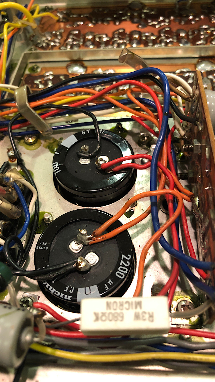

While you're waiting look it over real well, and measure the four emitter reistors too.
Each should be 0.3 ohms, but if your meter is not accurate, at least make sure they all
seem to be about the same value. Subtract the meter lead resistance from the reading.
If those resistors are ok, I'd just replace the five capacitors and then use it for a while.
Then if you like it and want to put in the effort, replace all the other electrolytics in the unit.
There are a fair number of small ones, so it would be a significant amount of work, but it
shouldn't cost too much more.
seem to be the same values.
My meter shows 0.3 ohm on all 4 resistors.
My meter kinda slow measuring sub ohm resistance and only to tens of an ohm. Should probably get myself a better one.
Sounds like you are on the right path.. Actually capacitors that sit unused for decades will deteriorate more quickly in many cases than ones that are used on a periodic basis at moderate temperatures. (Heat is the enemy of component life.)
In a case like this a failure might result in the destruction of a part you may not be able to replace. I normally replace and then troubleshoot after. In many cases all of the odd problems just disappear with cap replacement provided that the unit in question was not put away broken.
Share some pictures as you go! 😀

I’ll post pictures in every step repairing this sansui. I have a warm feeling about it future thanks to unspeakable kindness of this board members.
It's just common sense to use a Variac to slowly bring up the line voltage on old equipment
that has not been in recent use, at least if there are no visible problems to correct first.
But since you had already run it, then we go on to replacing the obvious components.
Since the emitter resistors all measure the same, let's assume they are ok for now. They probably are.
Looks good. When you first turn it on, please use safety glasses and stand away from the unit.
Have DVM(s) already attached to the new capacitors, to check the voltage.
By the way, it is important to not over tighten the mounting clamps.
They could pierce through the capacitor's wrapper and violate the voltage isolation.
