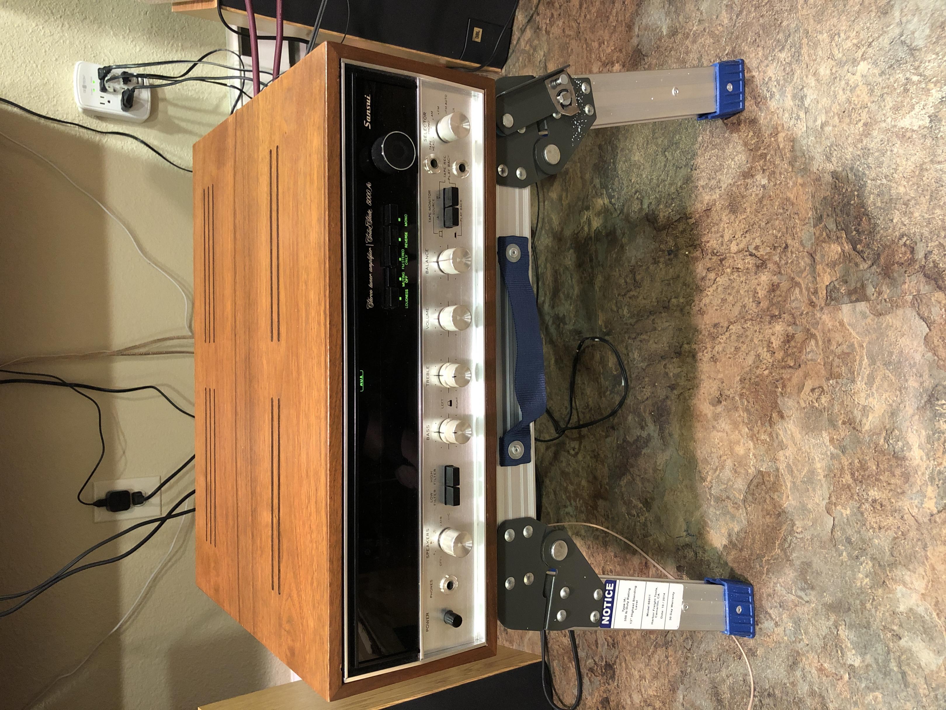

I`ve got 1969 Sansui 5000A tuner amplifier and it worked for a day. Then both channels became very weak and distorted, both at the same time. Sound became choppy and at full volume it`s just a distortion. I`d expect 1969 amplifier in need of recapping but both channels became like this at the same time make me think that problem lies in power supply since it`s shared by the both channels. Ideas?

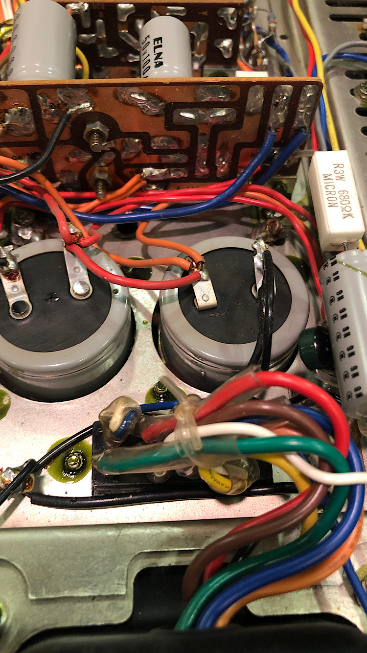

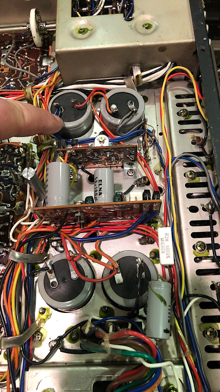

You're very fortunate that something more serious hasn't happened, after 50 years all of the original electrolytic capacitors will have deteriorated and a complete failure of one of them could result in an exploding capacitor or damage to power transformer, rectifiers or components/semiconductors in the amplifier. I would not even turn it on again until all of the electrolytics have been replaced. (not just power supply)
I’d replace all of them. Thank you.Its just I want to find a failure first. Amp spent most of those 50 years in its box. Not powered up capacitors shouldn’t deteriorate at the same rate.
Get two 2200uF/100VDC electrolytics for the main supplies, and one 2200uF/50VDC for the aux supply.
Replacing those three will probably get it working well enough to check out the rest of the circuit.
Then check the two 25VDC voltage regulators for proper outputs, and also the two electrolytic output
coupling capacitors, which probably should just be replaced. This is a single supply circuit, so the amplifier
outputs sit at half the supply voltage, before the output coupling capacitors. Use only 100V parts there too.

Get a couple of 2200uF, 100VDC electrolytics for the main power supply,
and one 2200uF, 50VDC for the aux supply. Replacing those three will let you get it working

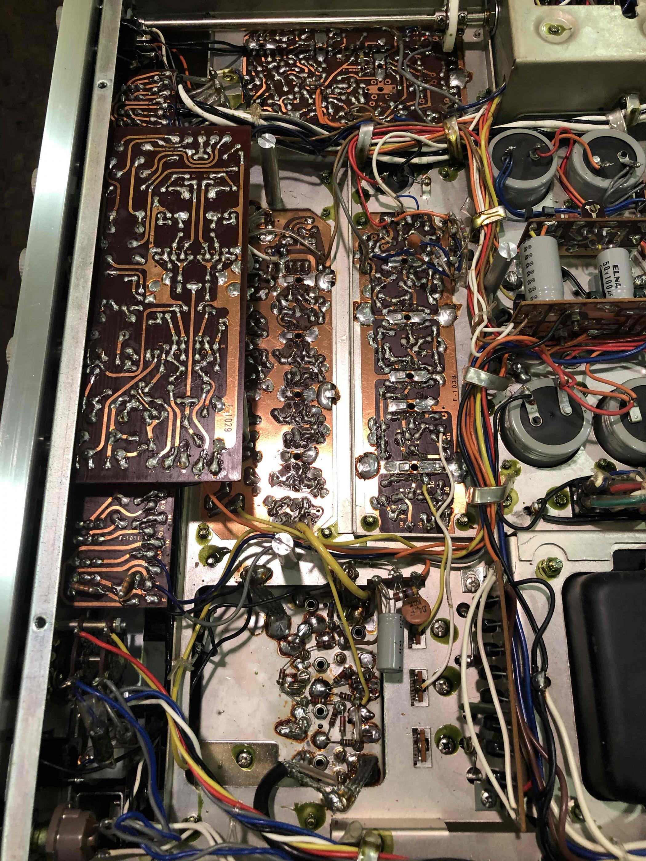

Post some photos of the circuits.
