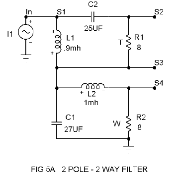

Supose I am using this crossover for 8 ohm drivers crossed over at 500hz at 12db/octive. For the moment lets assume the drivers are a perfect resistive load. Is there a easy way to model how the responce would be affected by using it with an amp with an output impedience of 4 ohms or for that matter 10 ohms.

AllenB thanks for the subjestion about Xsim. I am thinking about biamping
and untill I get a crossover I wanted to continue using passive xovers. The small
single ended triode amp I may use above 500 hz does indead have an output
impedience of 4.3 ohms. Pluging this into Xsim it looks at first glance like my
500hz passive xover will be acting more like a 400hz xover. I will probably have
to break down and do something I don't like that is measure it.
794941d1573793412-amplifier-output-impedience-question-calc_cr_12db-gif

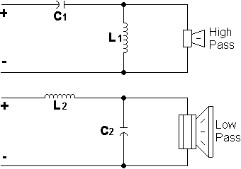

Allen, yes it may be that easy but I will have to play with Xsim some more. And like you I build amps and at the moment am undecided whether to build a Zen9 with an output impedience of about 1.3 ohms or build a F2 clone with an output impedience of 15 ohms. And I went the F2 rout I might just use a current source crossover network like Pass wrote about. Dang might just be best to build an active xover ! Oh that crossover came from Nelson's article about current amp. crossovers.

795176d1573862139-amplifier-output-impedience-question-passxoverpassxover-png
That's series crossover with voltage drive...

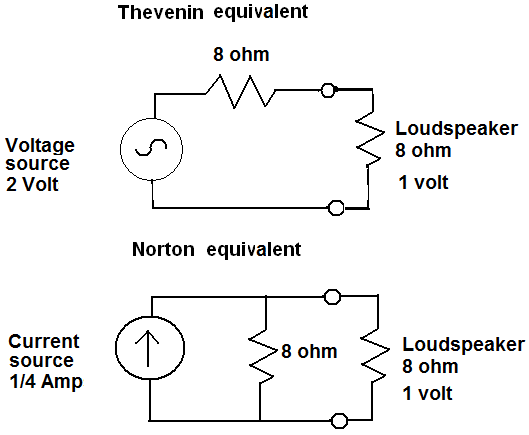

I like to use this mental model for simulation. Just putting a resistor in front of the filter tells you how response changes.
521708d1451356560-crossover-sounds-theveninequivalent2-png
