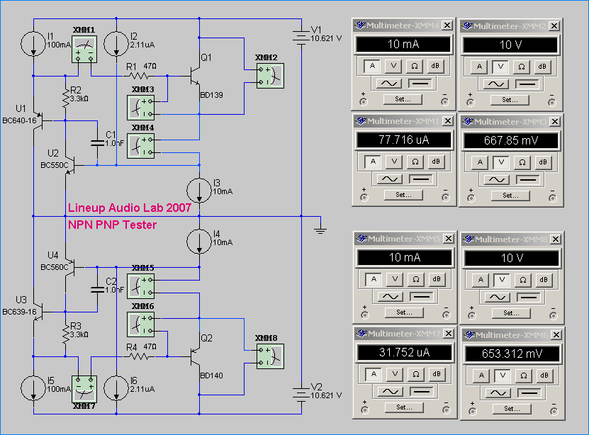

Amplifer NPN+PNP Transistors Tester Circuit
When we build our transistor amplifiers, we very often want to use
Complementary NPN + PNP Transistor pairs.
As close matched as possible.
My circuit for this, you can see in Attachment.
A similar circuit should be possible to build.
This one I use for for testing my MultiSim spice models.
About the schematic:
This test shows BD139 / BD140 Testing.
I use 10 Volt C-E. But can be changed, of course.
Also the test CURRENT can be easily changed.
In this case I use 10mA for BD139/140.
- Q1 is transistor under test
- CCS 'I2' 2.11uA, is a compensation for base current in U2.
- CCS 'I3' is where I set test current
- V+ is 10.621V, as 0.621V is compensation for VBE of U2
- The negative PNP side is a mirror of NPN test side
About my actual test result in the attached picture:
- VBE 0.667 and 0.653 Volt is alright
- Base currents: 77.7uA and 31.7uA is not alright
Because a gain difference hfe=128 and hfe=315 is too much.
So I should not use this pair for any Simulations!
I better try to find a some better matched BD139/BD140 spice models.
Finally
If you setup such a tester circuit, REAL or in your SIM, you may be very surprised!
🙄 Models of NPN+PNP that you have used may turn out to be less good .....
I really recommend you run this test, before you start designing Solid State Amplifiers.
Regards, lineup

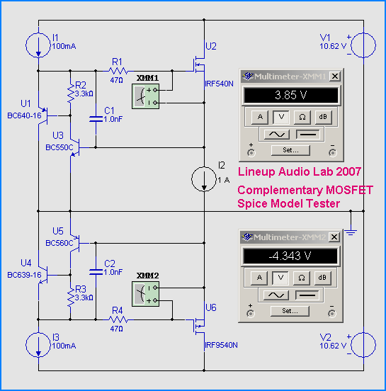

Complementary MOSFET Spice Model Tester
And here is a useful
N-MOS + P-MOS Tester
To checkout that your Spice Models are somewhat correct.
My attachment Tester circuit
shows a test of IRF540N and IRF9540N.
At 1 Ampere and 10 Volt result is:
IRF540 VGS: +3.85V
IRF9540 VGS: -4.34V
Comparing this to figures in datasheet for these MOSFETs
shows that these both models are good!
Regards

Thank you for shearing your Mosfet Tester Circuit to this forum.
I already build your Mosfer Tester to test my old Literal Power Mosfet
Hitachi 2SK134 and Hitachi 2SJ49.
However, not more than 2 minutes test both transistor BC550C and BC560C dead
maybe overload or something I do not know.
Please advice how long I should test for Each Mosfet or you have other tips to modified
the Tester.
Your kind attention and advice it highly appreciated.
Regard,
Sunami
the Tester.
Regard,
Sunami
Subject : Complementary MOSFET Spice Model Tester
OK, what about R1 change to 220 Ohm and R4 change to 470 ohm.
Any advice...?
Thank you
Any advice...?
Thank you
