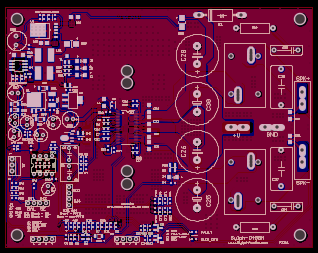

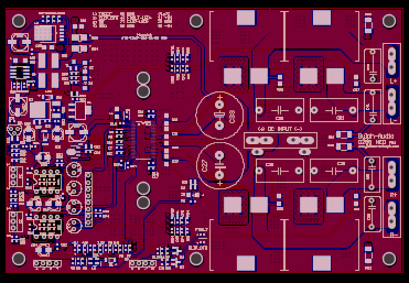

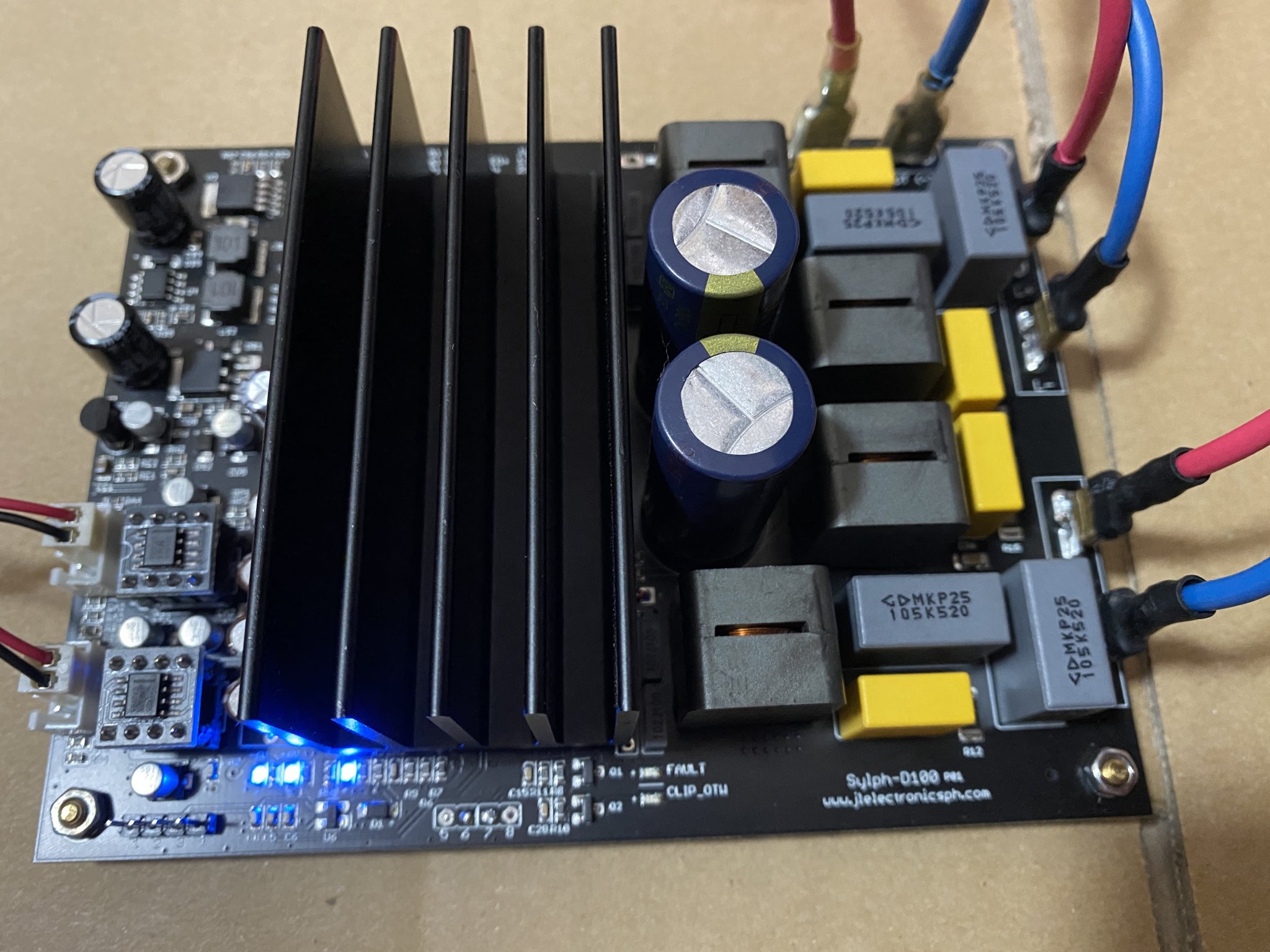

TPA3251 amp module
I'm developing a TPA3251 amp based on Sylph-D200.
5W 4 ohm performance will be around -91dB to -92dB THD+N since it will use cheaper voltage regulators. PCB length will be reduced from 150mm to 137mm.
Inductors will be Codaca 1D17A equivalent and with only 2 bulk caps.
Actually I'm noticing a better bass response with smaller bulk caps (1500uF * 2)
Attached THD measurements

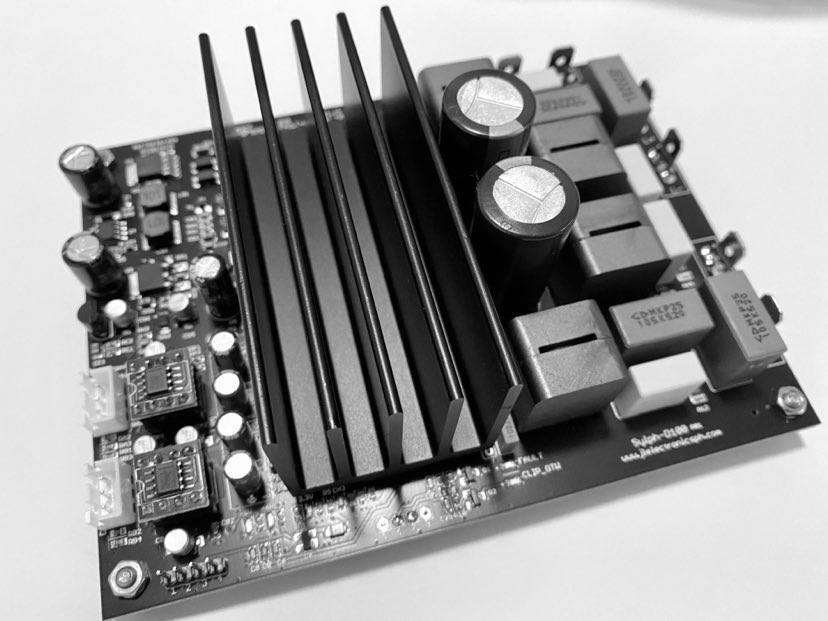

4 months have passed and this is now available (with limited quantity due to supply issues)
https://www.jlelectronicsph.com/product/sylph-d100-tpa3251-stereo-amplifier-module-ready-to-run

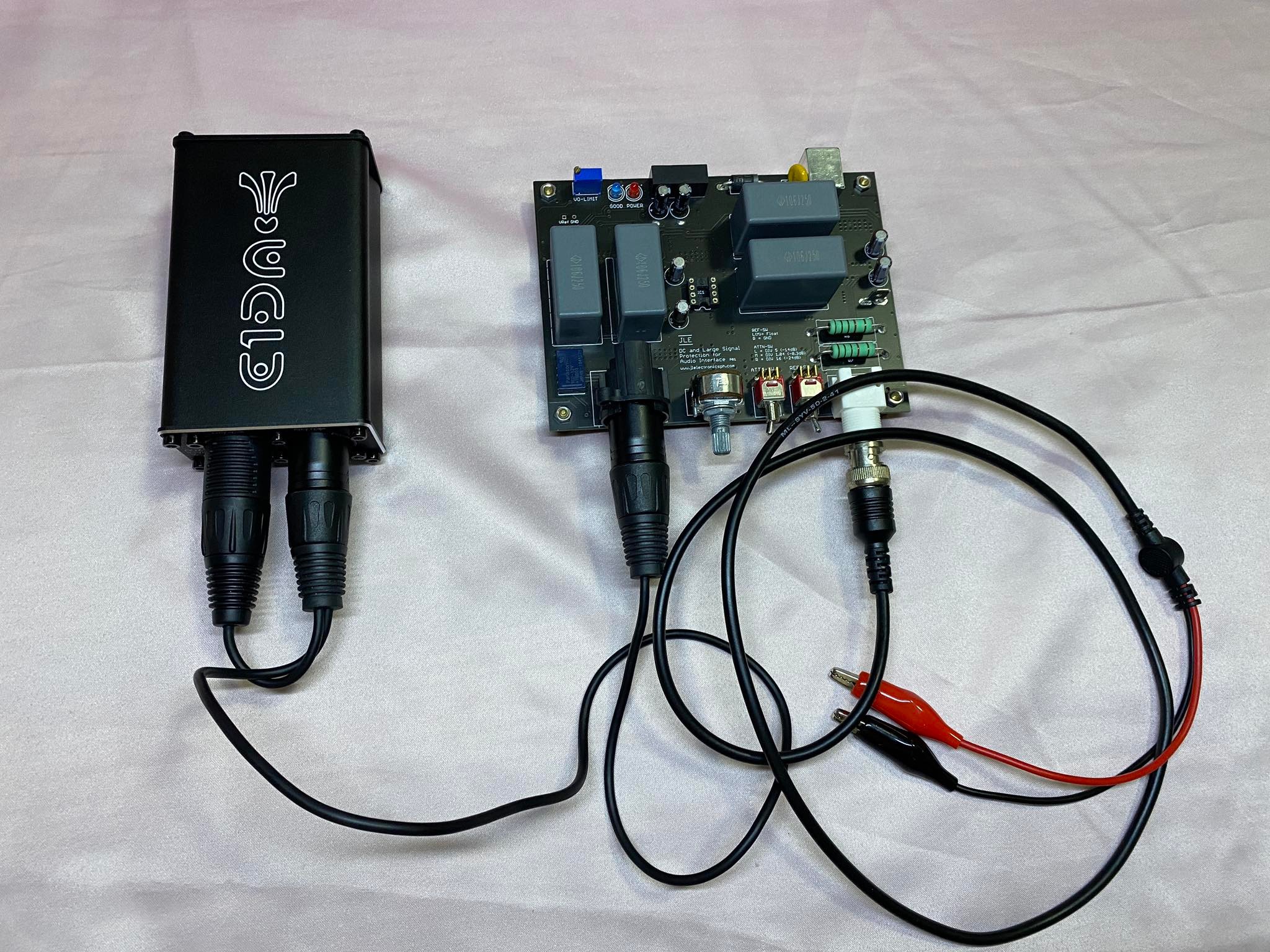

I picked up a TOPPING DX3 PRO+ as a DAC with volume knob,
Any chance of posting a picture of your setup with the JLE Interface connected and an example of how to use it for amp THD numbers?
I already sold my Loxjie D30 V2 so I can't post a picture of a complete setup.
Here's a crude connection setup if you have an ADC module.
You can adjust the Vrms output limiter (by relay turn-off) going to the ADC by adjusting the potentiometer beside the LEDs.
So if you have an ADC that can accept a maximum of 2Vrms input, you need to set the limiter output to 2Vrms to avoid overloading the ADC.
The alligator clips should be connected to the out (speaker) of device under test.
JLE Interface can only measure power amplifiers with 100dB or lower SINAD, best partner is with MOTU M4 for a cheap setup since they have similar performance.

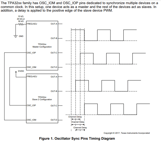

Looks really good Lester! Would this represent a signficant upgrade over a single Sylph-D200? I can see it gains a bit more power in dual mono. Can the pair of monos run from a single power supply?
In terms of power, it will be an upgrade, I already tried it on my 12inch 2ohm subwoofer last new year's eve (50V supply) and it is more than enough, it didn't reach clipping while on loud bass music and never went into protection mode.
Yes it can run on single power supply, you just have to set the 1st module as master and the other one as slave, then connect OSC-IOM and OSC-IOP of both modules. more info on this app note: https://www.ti.com/lit/an/slaa787/slaa787.pdf
