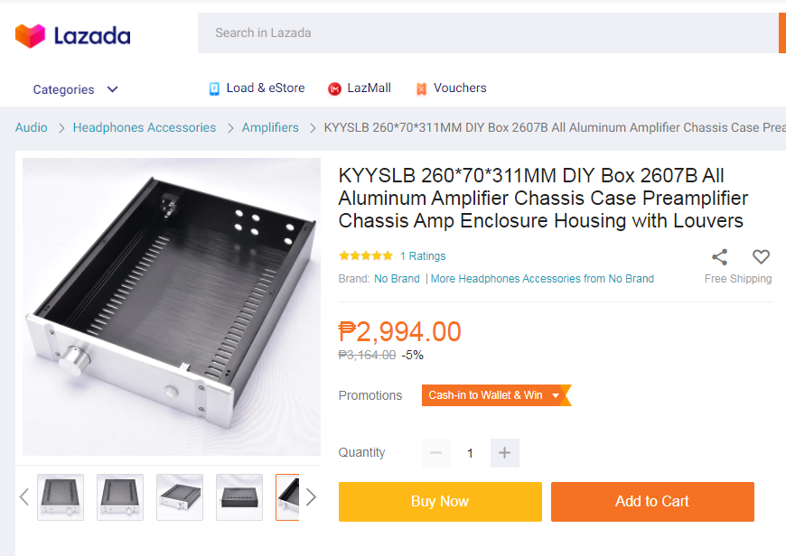

If it's just to house the module for shielding/grounding/mechanical protection, do you have something like this locally available?
https://www.amazon.ca/Fat-Daddios-Anodized-Sheet-Cake/dp/B0017Z20V4/
I am using 2 of the 16" x 12" x 3" version, clamshell-style, to house my amps.
I'm having difficulties with case work so I like it to be as finished as possible. I have around 5pcs amp chassis here that are not yet done because of it.
I also found smaller and cheaper 45USD and 60USD aluminum chassis but they don't have air vents.
