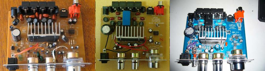

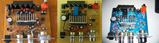

There are at least three revisions of this amplifier the main differences between them are:
  • LP-2020 PCB, All through hole components
  • LP-2020B PCB, bottom part SMD components, upper part through hole components. Relay for speaker protection
  • LP-2020A+ PCB, no bottom side components, upper side both SMD and through hole. Relay protection, and tone bypass switch.
attachment.php
First, second, and third version respectively

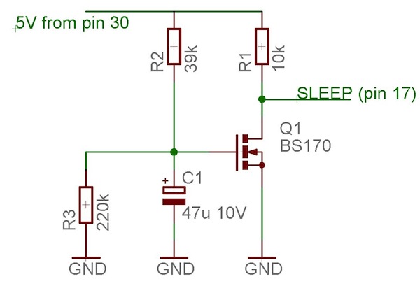

[h=Power on pop suppressor]%4[/h]
One solution is to sleep the amp during power-on using this circuit:
attachment.php
SLEEP pin needs to be isolated as is connected to ground, drilling around with any cutting tool.
What will improve: no power on pop sound, but the amp will take a few seconds to turn on.
Cost: cheap components, about 1$
Difficulty: a little soldering skill needed, medium.

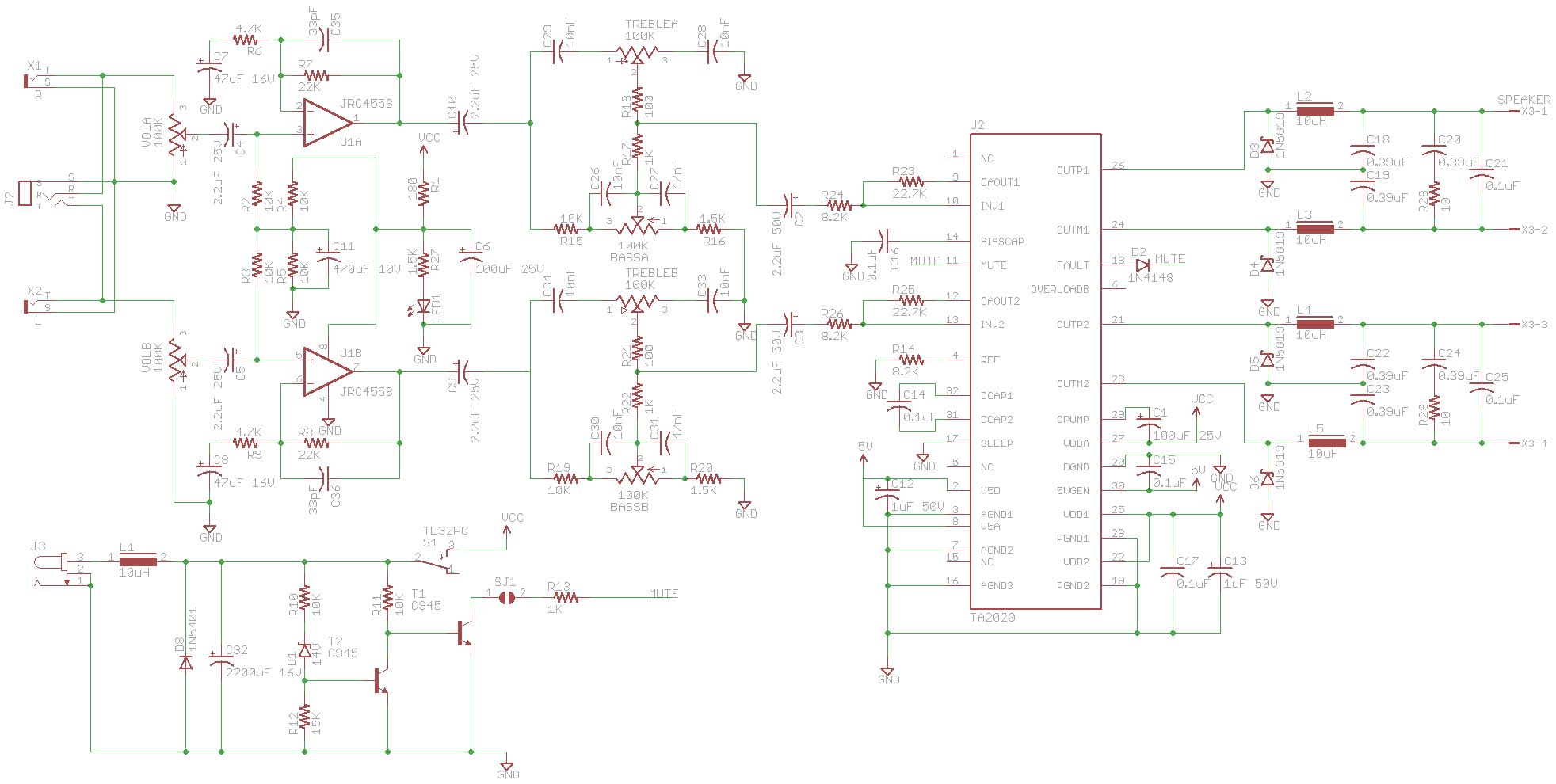

[h=Schematics]%3[/h]
Forum user Danerius provided a schematic for the first revision of the amplifier in the original thread
