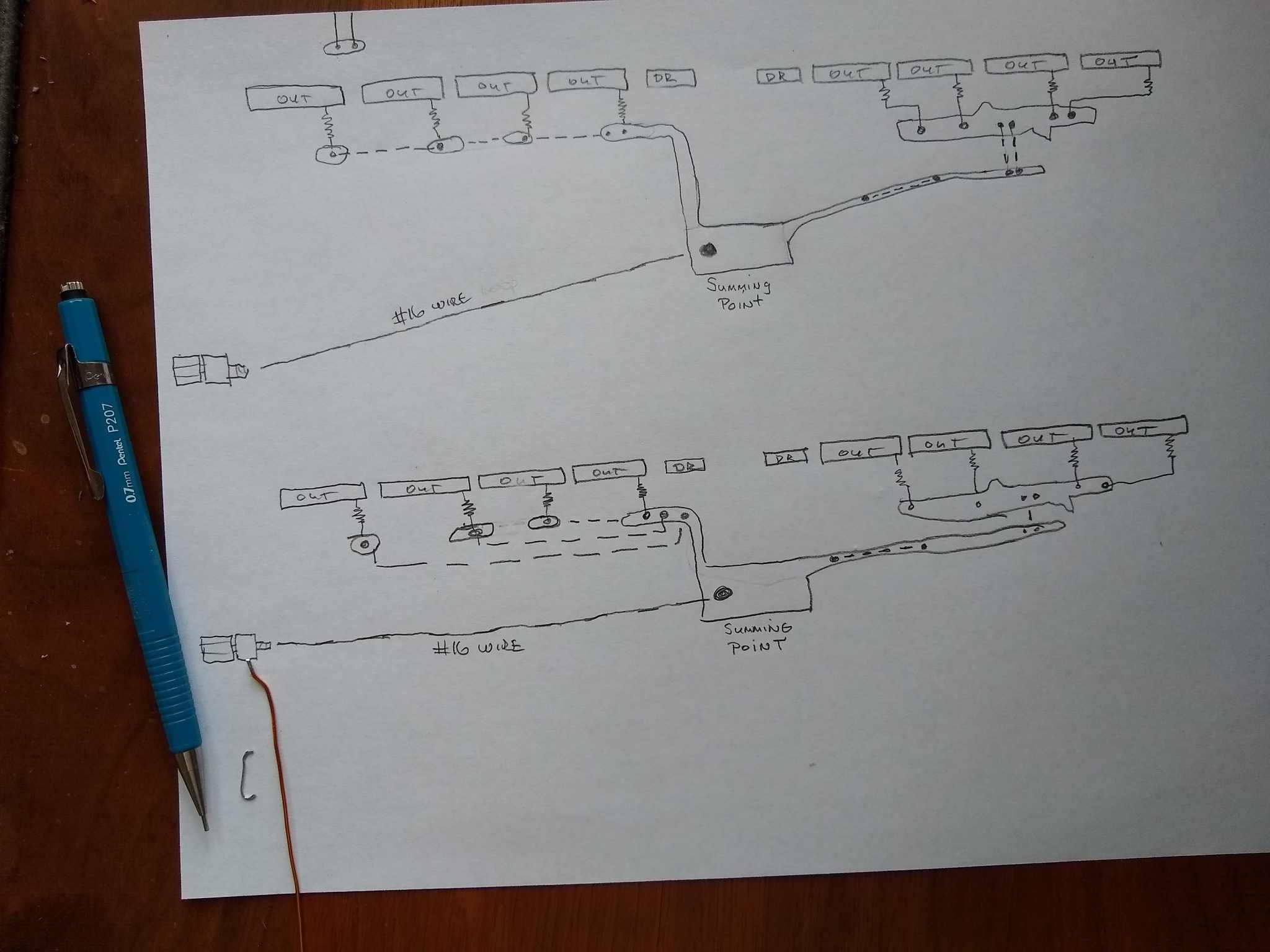

The attached diagram (one channel) is a representative example of my series/parallel mod for discussion. The top diagram illustrates the "series" musical sound wiring vs the bottom diagram representing the "parallel" detailed/firm bass sound. (Jumpers represented by dash lines)
The other channel has both push/pull wiring output paths "series" connected, thus the layout of the left and right channels are not layed out same. I chose this side to also illustrate the different push and pull wiring paths used on the same channel. Let's say one half(left) is daisy chained connected the other parallel connected. The other channel has both push and pull daisy chained.
In the diagram there is the original size jumper wire, and the substituted copper wire. I did scope the output, I detect no oscillation.
Discussion; the sound changes when changing from one, daisy chain, to parallel wiring to the summing point?

The resistances of the source resistors swamps the tiny differences in pcb traces layout, so you could also focus on matching those very closely.
So, basically you are comparing a star connection to a bus.
Not surprised they sound different. A star ground is really favourable in a preamp grounding/ps rail distribution but i really have no experience how this concept behaves in a power amp output. Not sure i have even seen this done before.

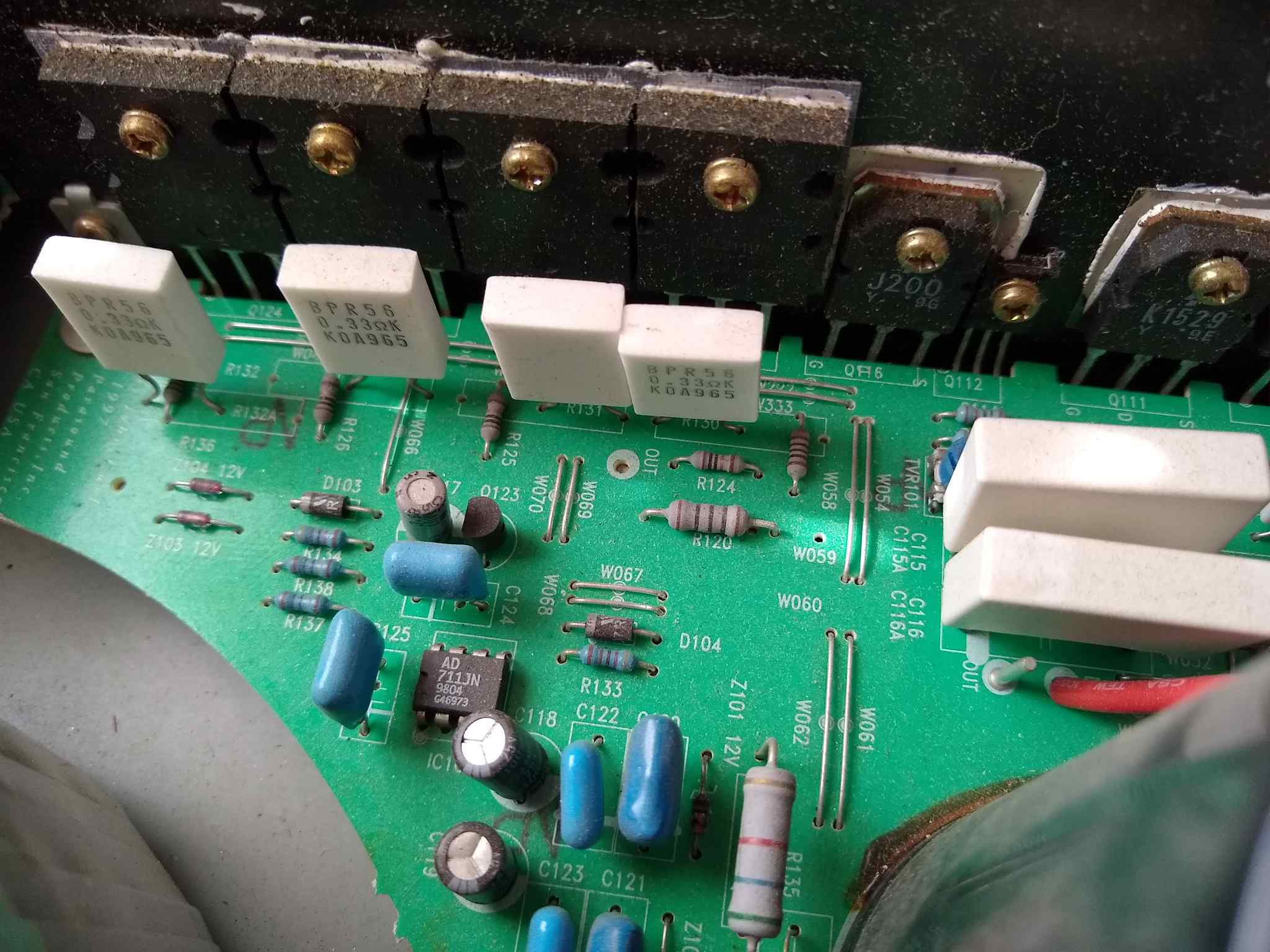

One factor I haven't mentioned is the rather small board traces carry the output. Some of them have paralleled laid jumpers filled with solder to increase ampacity. So I think both points, star vs bus and/or tiny path impedance seem to make a change. Even at the relatively large signal levels. Think, the far left end transistor output vs the one closest to the summing point. This may be crazy thinking, but how about a signal arrival timing difference between transistor and differing impedances. The ever so slight difference (daisy connection) making for a mid warmth. The "star" making for more concise timing or impedance path equality.

One more crazy idea. I haven't confirmed this but the PS path follows a similar daisy chain path and the outboard transistors are on the end of that supply. Marry together, furthest from the PS and furthest from the summing point(?). Highest impedance PS path, highest output impedance path. Each transistor PS/output impedance decreasing as it approaches the summing point
Good thought, I have to check... Because it's a single sided board, to physically determine the where abouts of the connection will require disassembling the amp. Stay tuned!
A quick check shows that the feedback connection for the, will call it the push side is connected after the 4 outputs transistors are summed. However on the pull side the feedback is connected between the junction of the 3 and 4 output transistors. Both channels are done this way.

The apparent reason for this is that when all is boiled down complementary transistors are approximations of what is ideal in reality.
With N material in a transistor the carriers are electrons and as charge carriers these are more mobile than holes in P material.
Differences there are between NPN and PNP power transistors will show up with increasing frequency.
How high frequencies are summed in each half prior to merging is my pick for the apparent hierarchy differences in each half of the scheme you have altered.
Sometimes when you see something unusual it can be by design and one should pause to think about it.

Two issues. One, with the top diagram circuit, is the feedback in error because of the connection between 3 and 4?
Second, when I have used a "parallel or star" connection as in the bottom diagram, the feedback from 1 and 2 on the pull side on both channels are lost due to the loss of the connection between 3 and 4. On one channel the the feedback is lost while the other channel retains the feedback from transistor 3. This is because of differing pad connections.
Shouldn't the feedback between transistors 3 and 4 be moved the the summing point? Does the feedback from 4 subtract from 1+2+3.
I'll answer my own question. It's just fine to connect feedback to 3 if you don't break the 3 to 4 connection. I should of been more careful of physical connection and not assume symmetry. So it ends up a typical "simpler" explanation in the end.
