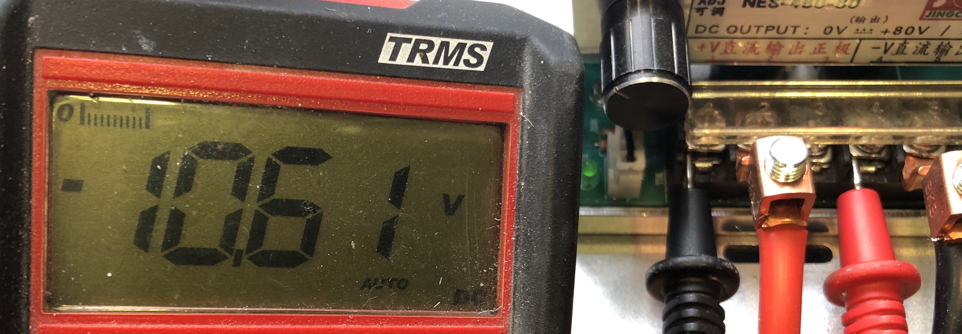

If you want to learn please follow directions. measure your PSU first. red and black marks on green plastic not enough.

OK, done for the first learning :
It should be like so ?

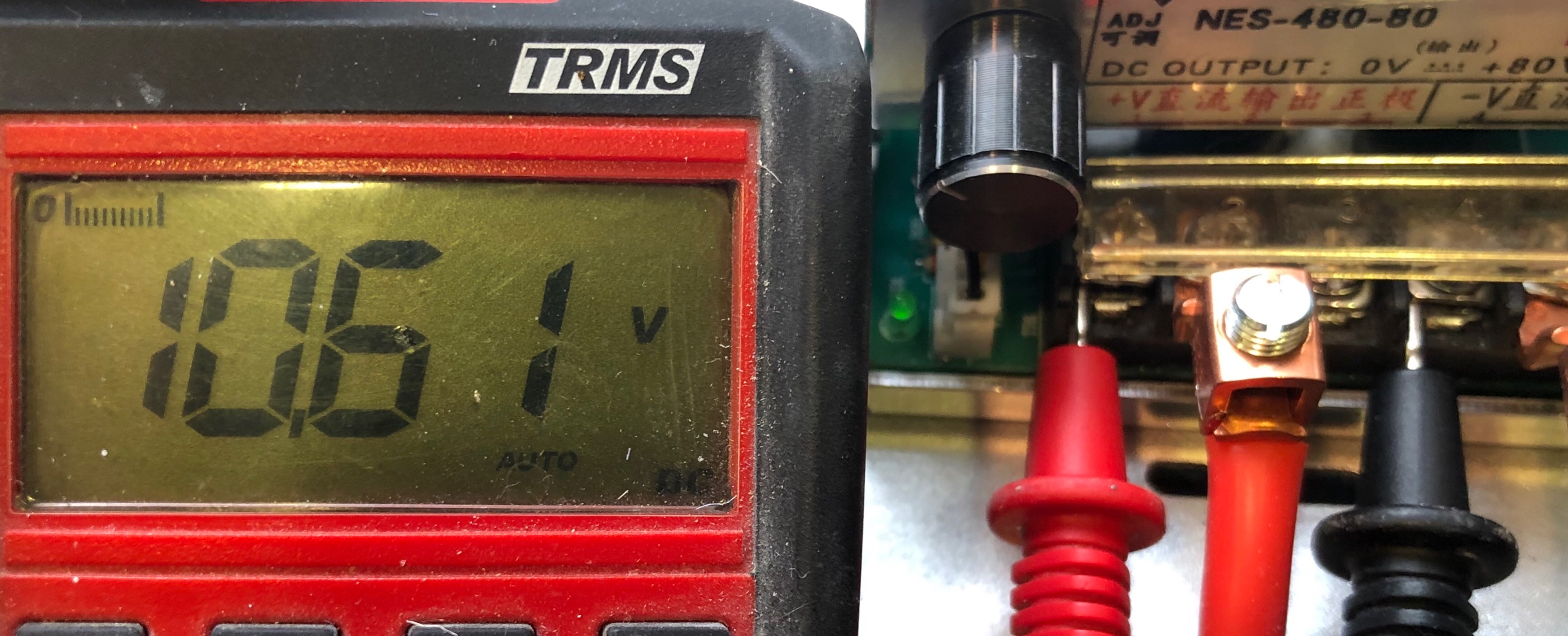

Is your DMM capable of displaying negative voltage reading? Reverse leads on your last pictured measurement. It should show “-“ a n front of voltage number.
If you don’t understand what you doing this exercise is pointless. Try to understand single vs dual rail first.
Yes. Hooray!

PSU marked V- G V+. amplifier B- G B+. make sure its connected V- to B- G to G V+ to B+. if that is correct go ahead power it up. you gonna be fine, just keep clear from powered up circuits.

Hi Dani,
The power supply seems OK. Left if minus, mid is ground and right is positive.

Hi amigos, first : let me say THANKS for your help... That was my first double Rail PSU, unsually I do not use those kinds of power supply.
Here the final result, seems to work fine. I am still listening to my HD Audio music and I will let you know my feelings about the Wondom IRS2092
