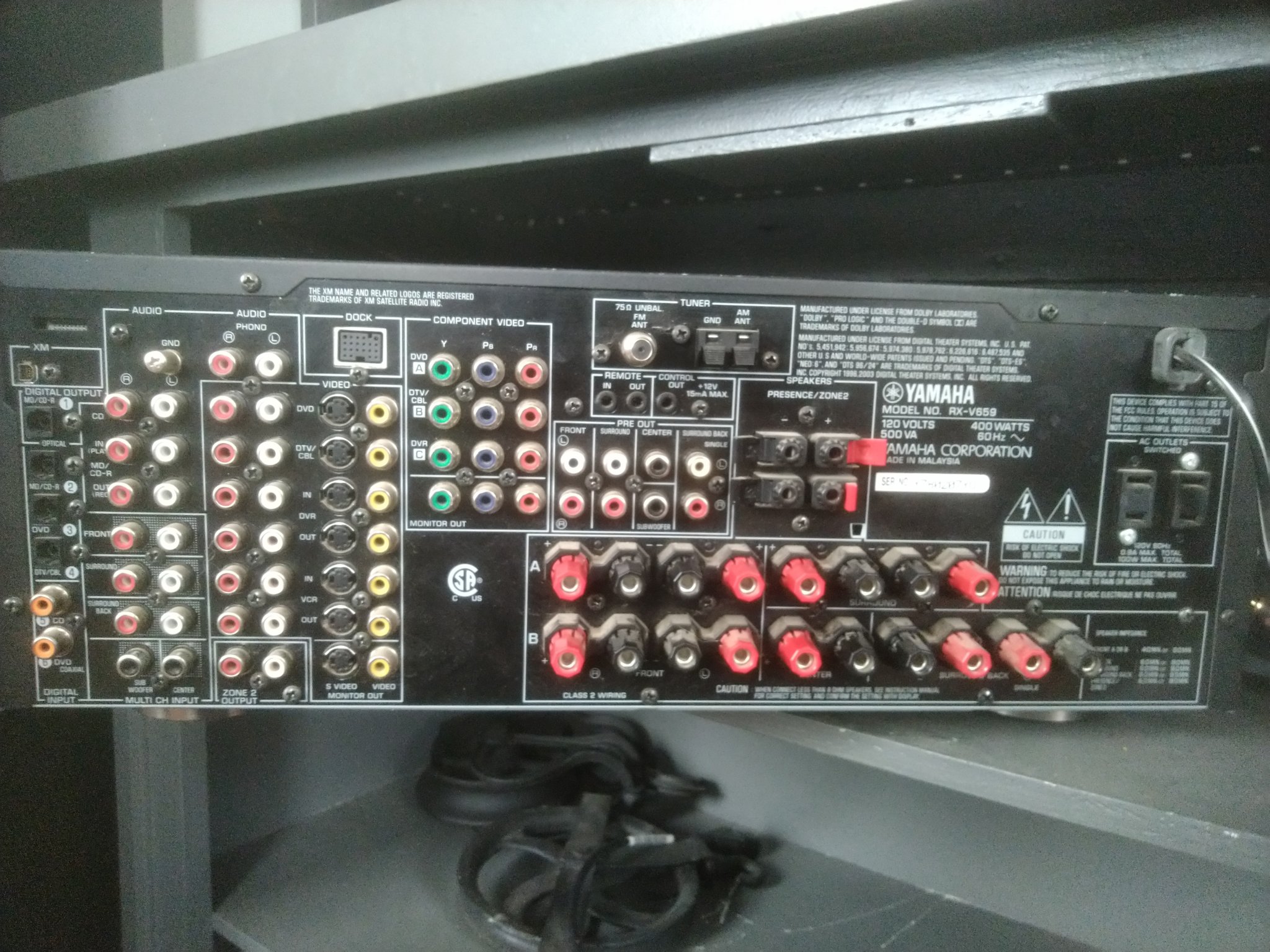

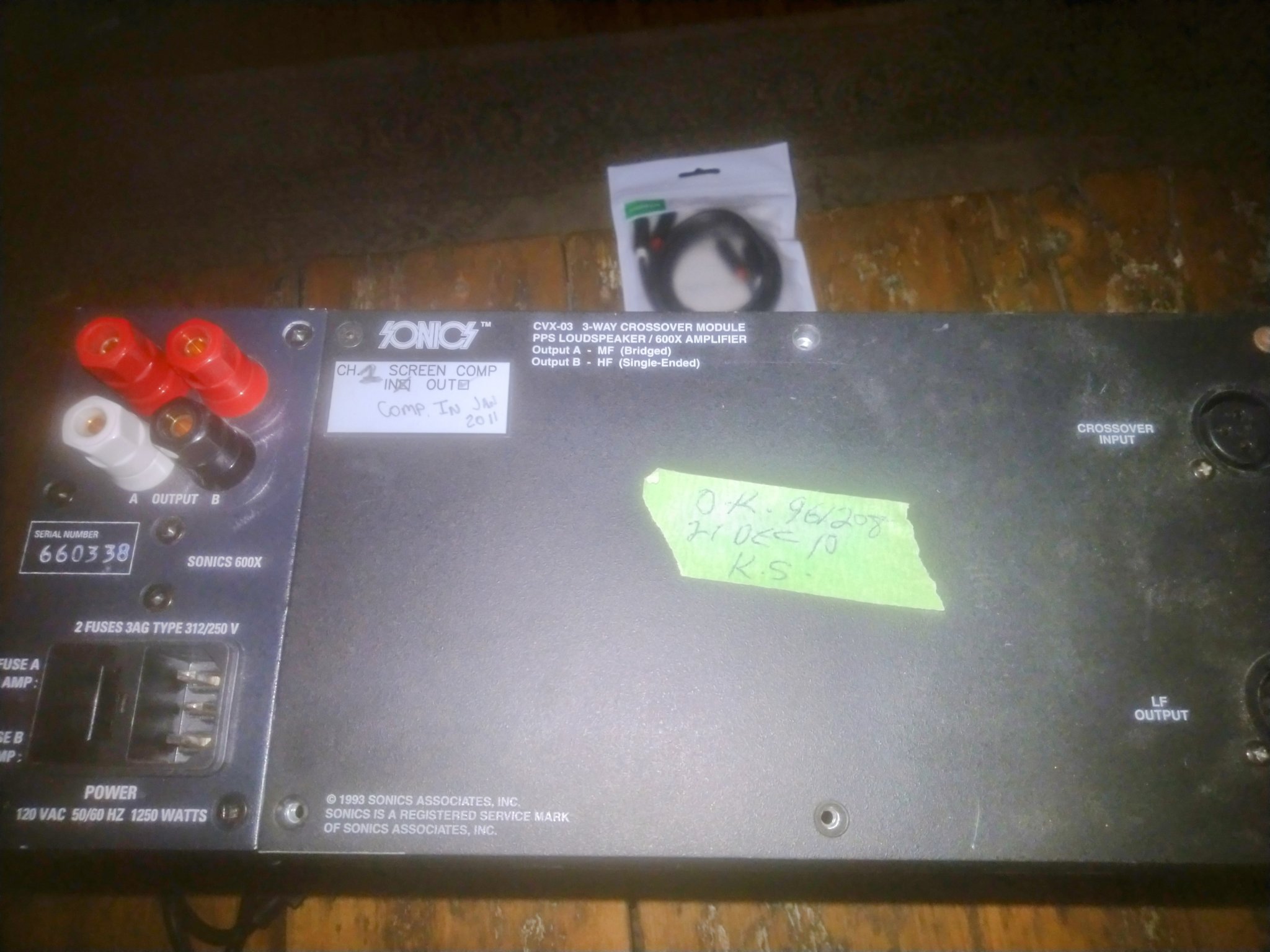

How did you make out with hooking the amps up. I as well have aquired a pair of sonics. Mine are the 600x or the 5b. I hear ya about info on the net, next to nada. I too would like to use these in a monoblock set up, one per left and right fronts. The xlr LF output and the xlr crossover input have me pulling what little hair i have left out. Kinda new to this and totally new to xlr. These amps were gifted to me by a very close freind and would love to fire them up but am lost on how.
Any info from anbody woud be greatly appreciated.
Avr is a yamaha rx v 659

So in my case I just hooked them up like any other monoblock and they worked perfectly. I used a 2 Channel preamp with XLR outputs. You can get adapter cables to go from rca on you air to xlr on the amp. I thought I read the 600x has two channels at different output levels.
Ya, the sonics 600x does have three channels, two bridged one not. I beleive from what i could gather and from looking at the board on the inside its a bryston 5b with different face and rear plates.
Think my plan is going to be to take them in to a shop and see if they can delete the xlr for rca in and outputs.
