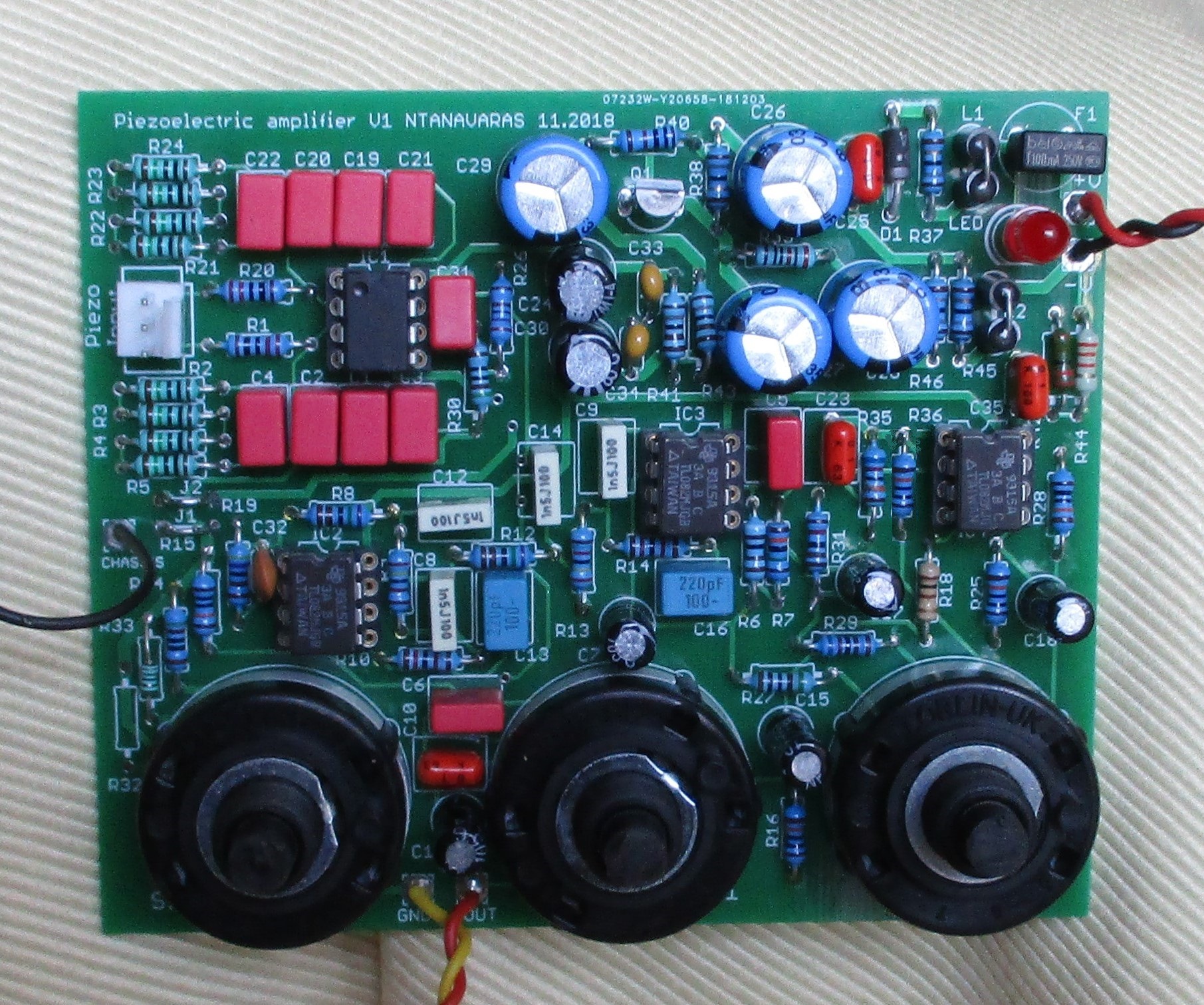

This is an amplifier especially designed for piezoelectric sensors.
It is a differential charge amplifier but a two pin piezoelectric sensor can be connected to the (+) and (-) input.
The amplifier includes three gain setting (0 - 10 - 20 dBs) and high pass filters (3 Hz- 16Hz - 160Hz).
I have some PCBs available (without any components), if someone is interested to build one.
The dimensions of the PCB are 84mm × 101mm.
The price is 28 Euros (shipping is included).

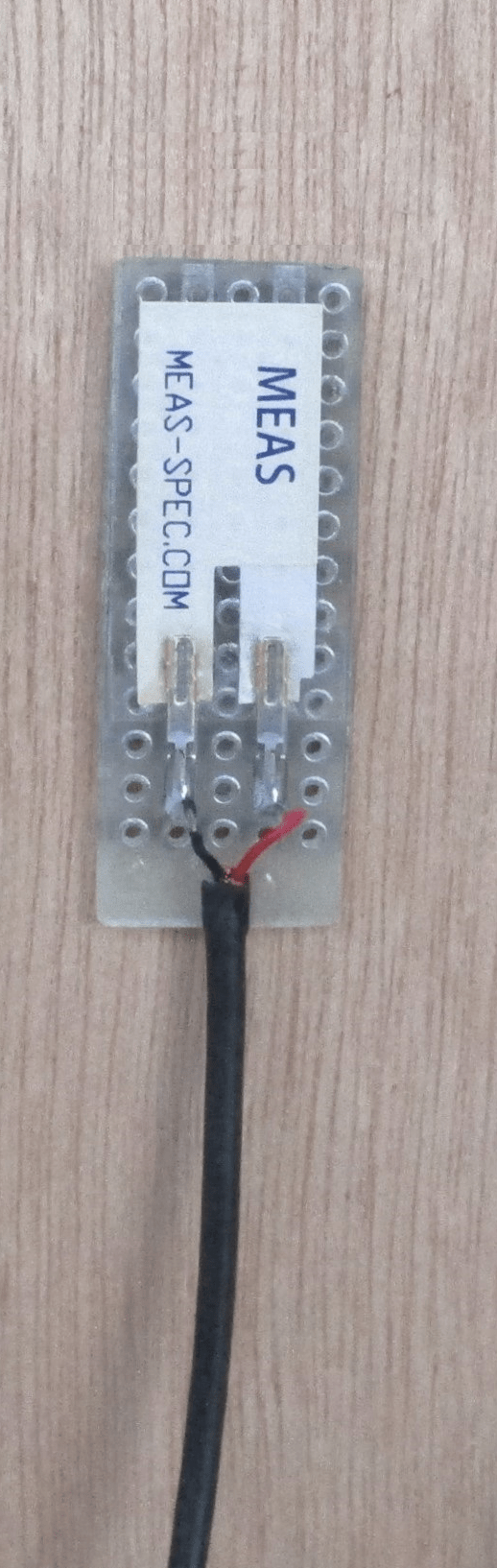

Piezo sensors can be used to measure vibration on loudspeaker cabinets, turntables etc.
You can use them as a cheap alternative to accelerometers.
Here is a cheap one I have used with good results.
