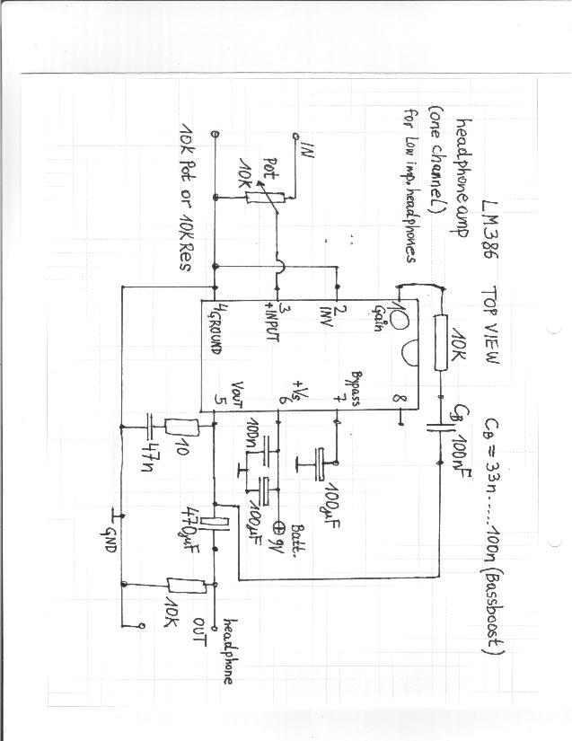

hello.
once i have built a headphoneamp with the lm386.that is no high end opamp(if you turn down the volume to zero you can hear a small amount of noise),but it works properly with a 32ohm headphone and a 9volt battery.
a bassboost is built in: with cb=100nf.....more neutral;with cb=47nf or 33nf more boomy.
at the input there is a pot=10k for volumecontrol,or a resistor10k.
it is cheap and easy to build up.
have some fun..........
greetings.........
