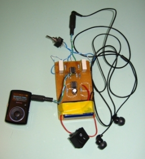

I have just build ''cmoy'' pocket headphone amp with OPA2132. I have used another opamp as voltage splitter to get +-4.5V from 9V battery.
It has all the power you need to drive almost any headphones. I also implemented bass boost circuit in the feedback loop with a switch to turn it off or on. It is still prototype but plays sweet with planty of power.
You can easily power your headphone chip amp from two 9V batteries to get +-9V
;look the photo of my first prototype.
1W of power would be too much; you need no more then 50mW for most headphones and you can get this power from OPA 132, OPA134, OPA227 and similar. I think TL071 would be good just to check if the amp is working properly. This chip is a poor performer.

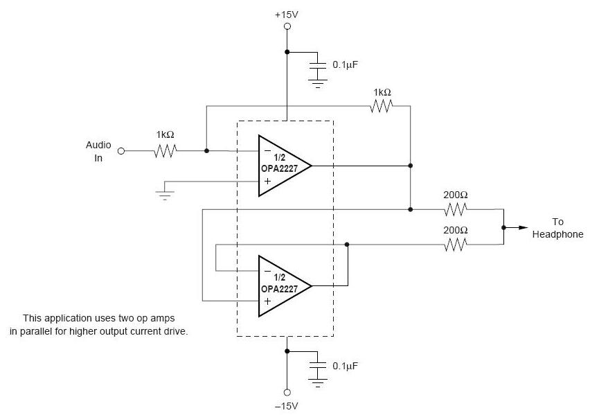

About connecting op-amps in parallel to increase the output current:
Connecting them straight in parallel makes no sense. Due to offsets and other non-idealities the op-amps will differ in opinion about what the output voltage should be, and you will get large currents flowing from one op-amp to the other. In the end, the op-amp with the highest current limit will win and the other(s) will just load it unnecessarily. In the worst case, different op-amps win in different parts of the output cycle, which due to the different offsets will cause a nasty distortion.
What you can do is give each op-amp its own feedback network and give each op-amp its own series resistor between its output and the headphone. These series resistors then prevent large currents between the op-amps.

If more current is needed you could use parallel wiring from OPA227 datasheet.
Still, I would start with TL071 (they are cheap if something goes wrong) and two 9V batteries to get +-9V and non-inverting design with the gain of 6 (10kohm and 2kohm feedback resistors). You can't go simpler than that.
If the design meets your needs then swap opamp to OPA132 or OPA227.
Build the prototype (point to point wiring) and listen to it; then you will know if you need more power or bass boost or something else.

this look to easy to be true 😉..
it it possible to to this kind of parallellign with moste op amps ?..
could i make the output resistor smaller for more outputcurrent at 9v
fx 120 then they se a 153Ohm load when driving small earplugs and 170ohm when driving my headphones..
