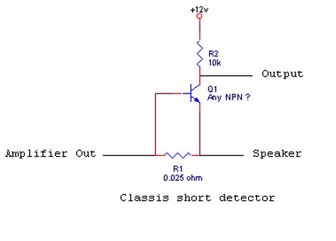

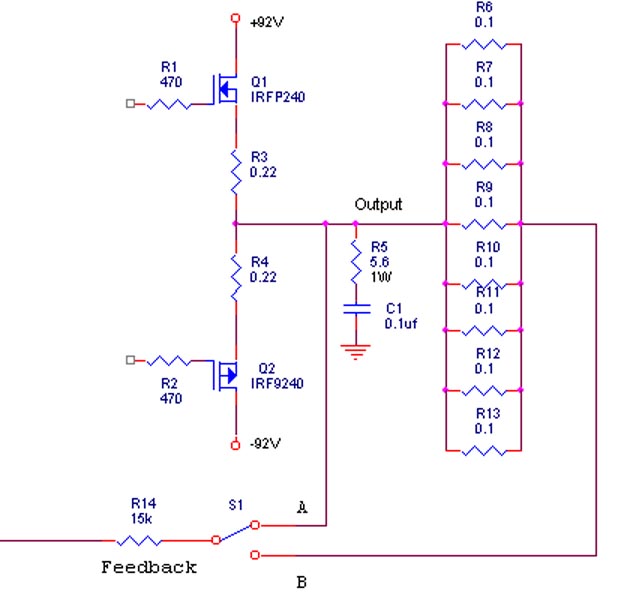

power supply for this TUN must be +rail
anyway, your idea with additional resistor in output is not good. IMHO
jannemans idea is OK:
"Why not use R3 & R4 in your first schematic, much easier & cheaper. Use two transistors, an NPN and PNP for the two polarities."
Regards
Is there another way to do output short circuit detection?
Current limiter are just fine to me.
